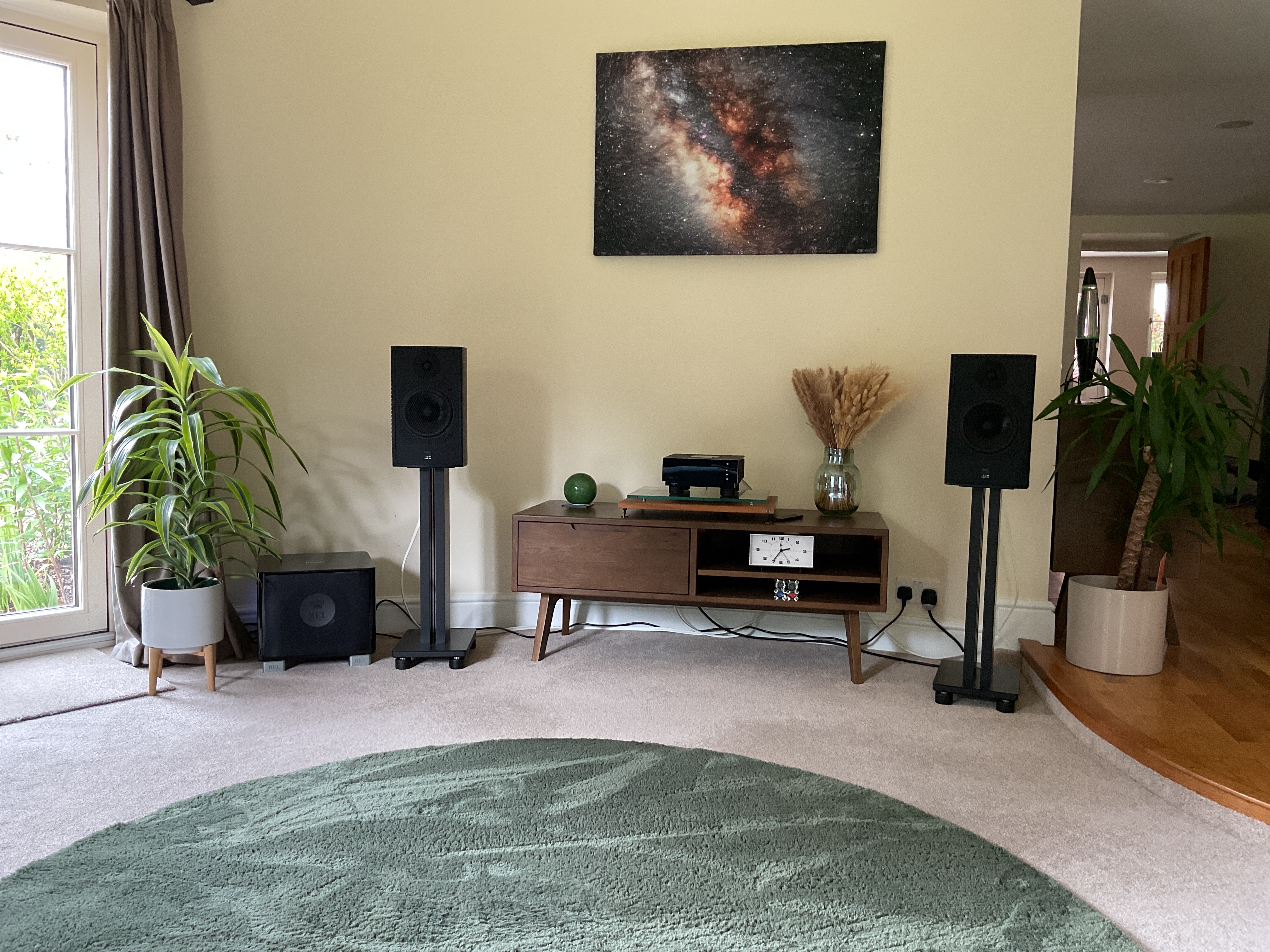

I have just received CI 102, as a possible sideways move from the Atom which is paired with ATC SCM20s and Rel T zero mk3. The aim to give the ATCs more power and add bass management.
Initial testing has given me much more respect for the Atom…weekend of testing ahead…will report back.

I have an Atom with ATC 11’s / rel TX9 sub. I did a demo on the 20s and in my room they didn’t work with the Atom (worked lovely in my main system)
I think ATC need a tad more power especially for those 20’s which are lovely speakers.
I have a set of Stack Audio Auva 50’s under my ATC11’s / lateral audio stands. (They do a 60 day sale or return) normally a little sceptical with such items but they have really improved things all round - I can turn it up more without the sound falling apart.
So after a weekend of testing here are my thoughts…hardware-wise I missed the physical volume control and screen more than I expected. Otherwise build is fine and doesn’t look too out of place on a low board.
As for the sound, the CI 102 is very detailed, has a wider soundstage, and a much quieter background.
I tried several option for managing the HF/LF crossover. In the Atom setup, full range is going to the speakers and sub fills in where the speaker roll off. This can be tricky and in my room the position is not optimal - in a dedicated built in furniture in the center of the speakers with only the front side open. I tested serval options with low and high pass filters with the CI, and this worked well, but didn’t positively impact the overall sound quality in a noticeable way.
The main thing is that unfortunately I didn’t enjoy the music while playing through the CI 102. I cannot describe technically the difference in the sound, the best way to communicate the feeling of each is that the CI is like being a passive observer of the music, while the Atom feels like actively listening and more intimate involvement with the music. The Atom can make the hairs on my neck stand up easily, but not so the CI.
I could point a finger at class D amplification, or the lower price point. However, I think its just the case that the ATC SCM20s just outclass the CI and lay it bare, presenting exactly what is going on at source. That is not to say the CI 102 is a bad product, just that speaker matching is important and just because it ticks some features boxes which the Atom doesn’t, such as extra power and bass management, that doesn’t mean that it is the right solution in my system setup.
Regarding the Atom, and the SCM20s, I have new respect for what it can deliver and for sure it is being pushed to the limits, in terms of delivering current and as a source. In a small room and not pushed to high listening levels, the Atom is a very well balanced product, so that even with the ATCs it does not sound deficient in any respect - at least in my room and use case.
Where to next…Enjoy the Atom :slight_smile: …and keep dreaming of SCM20 Actives.
