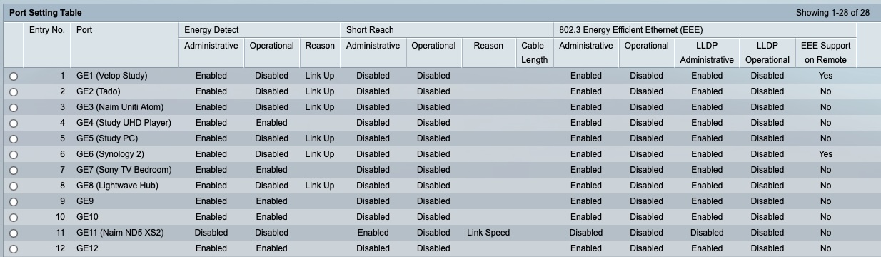

I would enable the Global parameter for Energy Detect Mode
I would enable the Global parameter for Short Reach.
I would enable full link negotiation on the particular port
I would then enable Energy Detect for your particular port
I would then enable Short Reach for your particular port.
I would then ensure the port settings are applied.

The manual stipulates the global parameters for Short Reach in Port Management must be enabled for the port settings of Short Reach to take effect.
https://www.cisco.com/c/dam/en/us/td/docs/switches/lan/csbms/250_/2_5_7/Sx250_2_5_7_CLI.pdf
Section 20.
The cli commands required are listed there
green-ethernet short-reach
switchxxxxxx(config)# interface gi1. (Or which ever interface)
switchxxxxxx(config-if)# green-ethernet short-reach
#show green-Ethernet
**Edit… I found it…. ** for that switch type… it states
The VCT length check can be performed only on a copper port operating at a speed of 1000
Mbps. If the media is not copper or the link speed is not 1000, Mbps Short-Reach mode is not applied.
So for that model you are out of luck.

Thanks Simon, at least I know I wasn’t going mad with it not enabling. Interestingly if you look in the CLI guides even for the very latest switches at this level (1300X), it explicitly says that VCT will only function for gig ethernet and won’t enable short reach. The GUI guides are much more vague.
Looking at what Cisco sell now, it seems you either get a 1300 class switch, or you’re into the main 9200 range, which would be a bit of overkill for home use plus very expensive, and from what I can see, the latter only supports full 802.3 EEE, so needs I think support from the remote device for the best efficiency anyway.
I think Short Reach was a Cisco specific thing which is why if it is enabled, the 802.3 EEE stuff has to be disabled.
So, to get the maximum benefit from energy saving, it would seem the best route forward, if the NP800 supports it, would be the enabling of 802.3 EEE features, probably via a toggle in the app. Whether this helps or not is something for Naim to look into if they think it’s worth the effort I guess.
