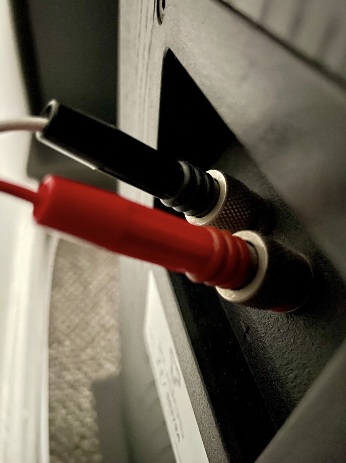

In the case of my 4mm banana plugs that can tarnish in the open I put O rings on the exposed parts like below.
Before and after. :+1:
