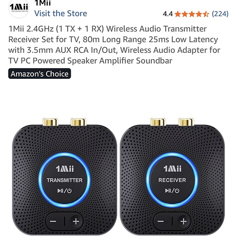

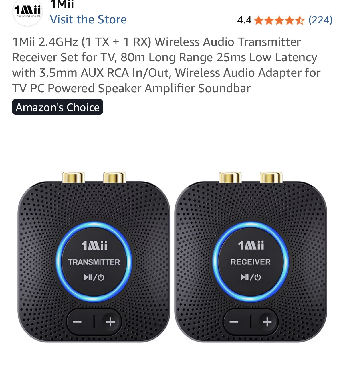

Thank you for this.
I might try connecting this transmitter to the 3.5mm jack output on the Brennan and the receiver to the equivalent input on the qb2, using 3.5mm to rca cables.
The delay might be an issue if you want to play both at the same time, but none of the other options (apart from threading a cable between the two… ) are likely to be better. Try it and see!
Thanks Andy, your replies are most appreciated.
The transmitter/receiver combo worked.
