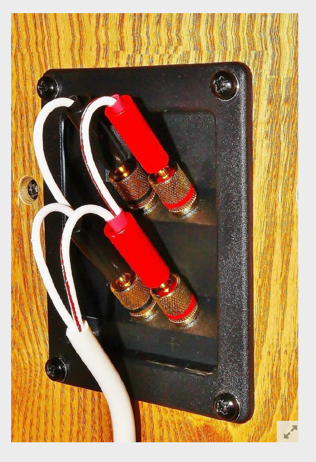

These need to be bridged; either use the links that came with the speakers, or short lengths of speaker cable links, or best would be naca5 with “F” configuration on the speaker end.
This is the F Configuration
