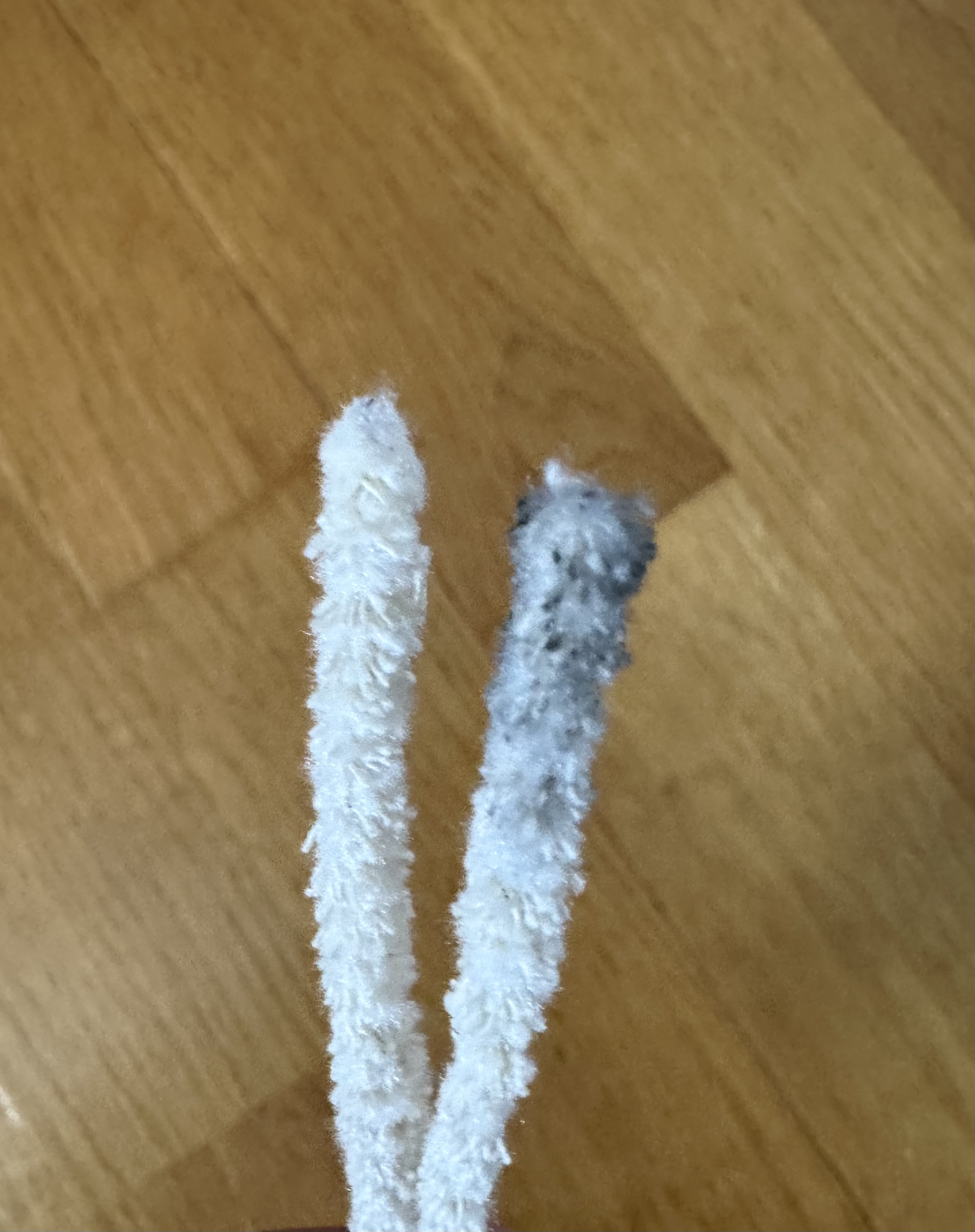

Other contacts (RCA, XLR, 4mm bananas) are not self cleaning in the same way, so some manual cleaning here may well help. Most important is often the insides of the banana sockets on the power amp (and possibly your speakers too) so sticking a cotton bud with a bit of IPA in them may well help there.
Left is new one. Right is after cleaning one banana socket on my NAP500.
Interrupted this afternoon’s listening to power down the system and clean the banana contacts of both NAP 300DR and speakers with q-tip and a bit of isopropyl alcohol solution. I was a bit surprised with how much black gunge was extracted. Audibly, a bit of a veil of clarity seems to have been lifted so well worth it.
