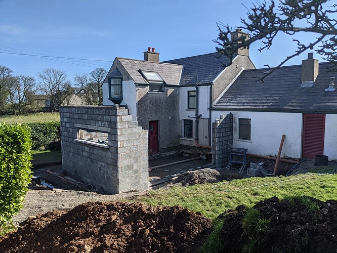

Currently have an extension ongoing…well I say ongoing but I haven’t seen a builder in days…phoned yesterday to say they’d be here today as the big lintel arrived on Tuesday…however…
New kitchen, just a tad under 28m2. Coming in at £1800 per m2. That includes all groundwork, underpinning, underfloor heating, etc. Labour costs probably lower here than elsewhere in UK.
The existing kitchen is behind the red door with the window in. That door will be opened up to double width so the larder is actually in the old kitchen. This necessitated upgrading the existing kitchen floor to latest regs and it’ll also have underfloor heating in what becomes a utility room.
Only thing not included in the price is tiling. Not sure how both the architect and I missed that omission. Awaiting price from the builders but there are alternatives if they’re too expensive.
Price also included some retaining wall - perpendicular from wall beside boiler room door (red door on right). We decided to do some more, right out round end of extension, once we saw the real extent of the excavation.
Currently a couple of months behind schedule, late start due to a previous project over-running and Building Control then deciding we needed structural engineer to design the underpinning.
We’ll be in by Christmas. Hopefully 2022!
