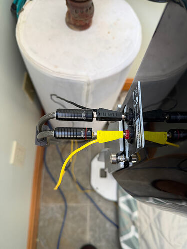

This is REL’s cable made specifically for Naim
There were differences in opinions about @ which end of speaker cable to piggy back. my logic was that the Naim 250 would prefer to have the SL banana in socket, and also, if the REL banana is sub quality to the SL banana, I thought having it in the shortest path to the N-SATs might make a difference, The wires come with a resister built in, to match the signal parameters in the SL cable.
The Rel for Naim cable is specifically designed for situations where you want to connect it to the amp. A regular unmodified cable is all that’s required to connect at the speaker end.

If they are the version of Bassline Blue that is sold by REL specifically for Naim, you should connect to the back of the amplifier. As Chris said, if connecting to the back of the speakers you can use any old wire, even mains flex. If you are able to connect to the speakers you may as well return the Bassline and pocket the cash.

If you want to connect at the loudspeaker end, you don’t need the expensive Bassline Blue with the extra circuitry in the signal chain.
The problem with Naim sockets (on both amp and speakers) is that they only accept a banana plug, and you probably don’t want to modify your expensive SL plugs to take the extra sub cable. The only solution you’re left with then is the stackable banana plugs. In this case I would contact Designacable, a UK cable supplier, and explain exactly what you need. They should be able to make up a lead with a Speakon plug for the Rel, and stackable bananas on the other ends to connect to your two speakers.
