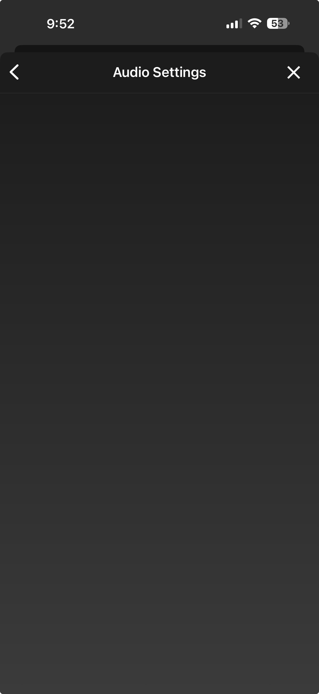

Hmms.. my ND555 Audio Settings is empty, nowhere to set any volume limit. Is this because I am using a pre-amp 552 and it only works for Uniti products?
Yes. You cannot set a volume limit for any preamp with an analogue pot. Only the ones with a digital volume or analogue volume controlled by an encoder (New Classic, Statement, 272 etc.)

Tks for confirming. While I am the only one using I want to ensure software don’t go crazy and I can prevent it. Looks like nothing for me to do now haha.
