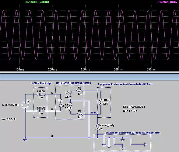

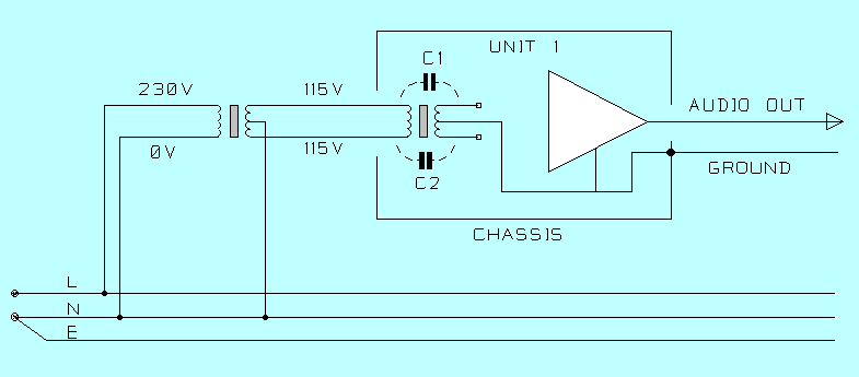

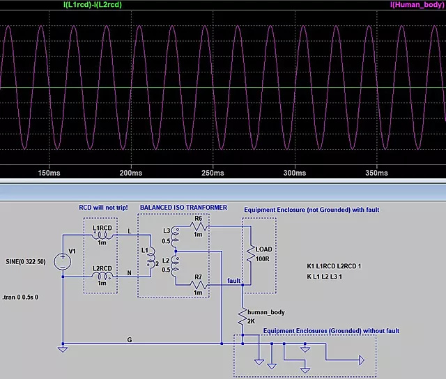

One idea I see bandied around is to connect the central tap on the output side to Neutral on the incoming side so… again I’m not sure of the implications.
In fact a few forums seem to say do NOT connect central tap to earth… but this is the way airlink told me they do it so who’s right?
Just to update… one of the reasons given for NOT connecting the central tap to earth is a potential issue with and RCD not detecting a fault… I admit starting to get beyond my simple knowledge.
I don’t think there is a right and wrong. Clearly the DC is about a constant current flowing to a reference… so if that is ground/earth then that will remain if ground/earth is on the balanced side connects to the supply ground earth.
I can see that connecting the balanced ground to incoming neutral might help, but also can see it not helping, it must depend on your earth neutral supply setup… but if one did, one would need to think how one protects this. [edit I see you have made the same point]
The answer of course would be to have isolated /double insulated loads, but this is not how Naim currently do things… in short I can’t see with total safety how a balanced transformer can be used to effectively remove DC on the mains with Naim equipment… therefore to remove DC probably best use a dedicated electronic DC blocker … and of course that can be used with an isolation transformer if preferred.

Maybe better if I’d said DC cannot pass from transformer primary to secondary windings
Well it’s not a Naim safety issue, it’s how the earthing is handled on the balanced transformer. The point is with Naim is the earth ground is important.
Indeed, understood and agreed.
I don’t have earthing anywhere else than my kitchen in my house. That’s very common in not that old houses in Sweden (required in all rooms from 1994). In what way does Naim equipment specifically benefit from earthing in terms of performance?
Naim amplifiers/pre amplifiers need an earth ground reference for optimum performance, as well on nearly all equipment requires safety earth, hence the three pin mains connectors. (They are not double insulated)
