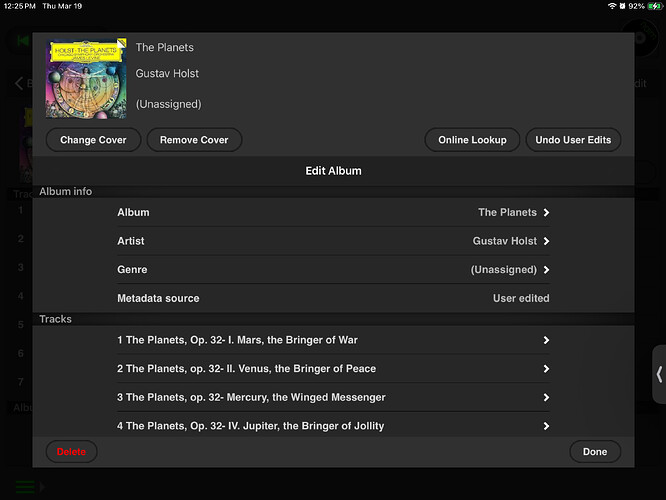

When viewing the music on n-Serve, does it allow for editing and deletion?

Then on your rips, in “edits”, go to Change Cover and hit Web Search. A Google search will probably appear, then find your specific cover. If it doesn’t, you can alter the search to find yours. Touch it until “Use Image” and “Open” appear. Try “Use Image” by itself first. Then “Save”. I’ve done it recently.

Yes, it should look similar to the picture above. Also, it would be a good opportunity to fill in the Genre field if missing. I’m just starting with the UServe, and I think I’ll go for the basic “Jazz”, “Classical”, “Rock”, etc. but you’ll see many others to choose from.
For CDs ripped on a Unitiserve this is your only option. Don’t attempt to edit them using a non-Naim interface as this will break the database. You can view these CD rips on a computer, and it might be useful for you to do this so that you can open files and see what artwork and other metadata is there. Then you can decide how properly to deal with any albums that don’t show metadata in the Naim app.
