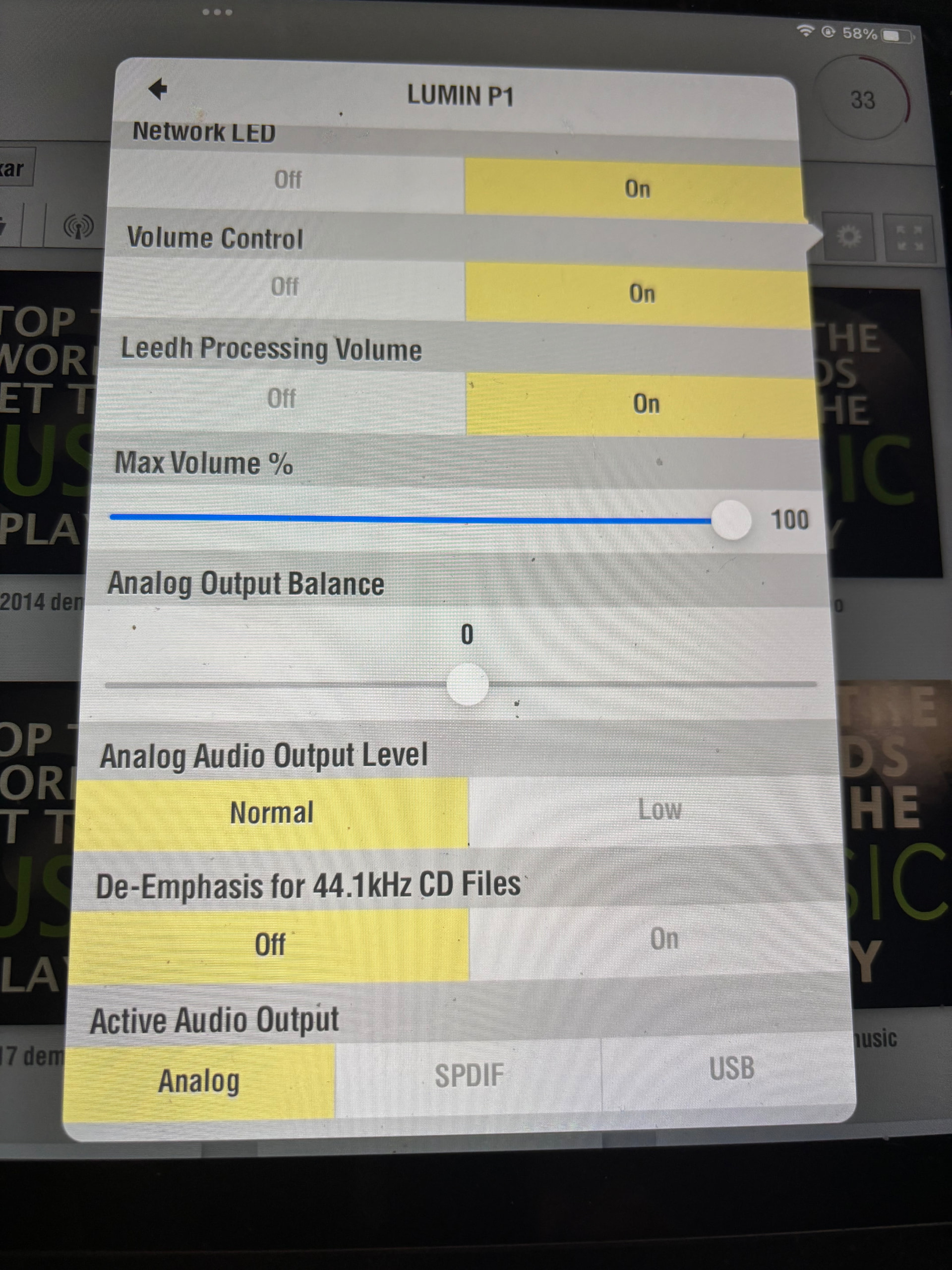

Also, have you checked the settings on the Lumin in the App? It is possible you need to change something there, but hard for me to say what, without seeing your settings.

I took a photo of my settings, these are under player options.
