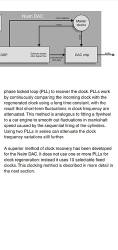

I meant exactly what I said, the clock master is the at the source, and the nDAC has to reclock it using PLL.
I suggest you Google Naim ndac white paper.
It depends on the boxes and their interface implementation. I prefer AES with my DAC and a single cable but then most of my content is ripped CDs so the 24/192 limit doesnt bother me.
If I understand it correctly, the nDAC has a data input buffer and data gets clocked out of this buffer using the nDAC’s master clock, so there is no need to reconstruct the clock from the input signal. This methodology is featured in all Naim DACs since the nDAC.
I see, so the nDAC is an exception, considering that it was designed in 2007! thanks.
