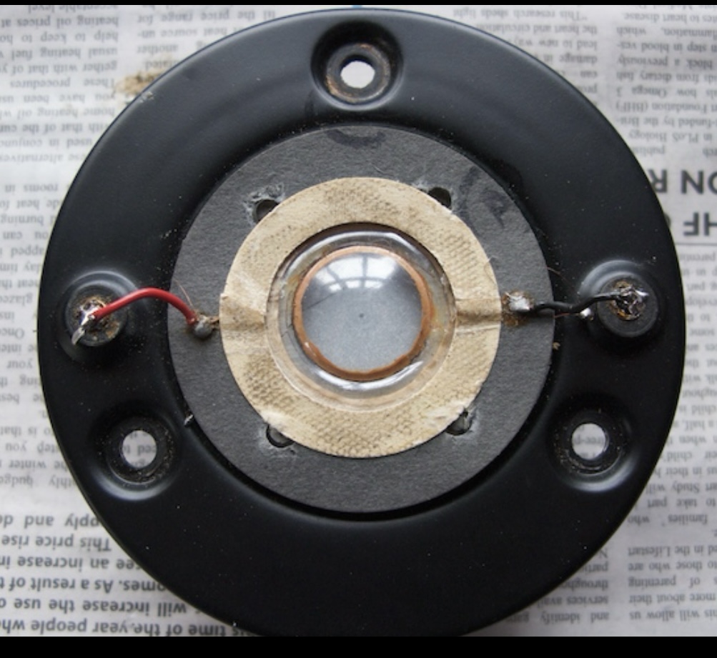

Do my Kans have Hiquphon tweeters?
Are the tweeters unrepairable?
I don’t know yet. A friend of mine who’s a repair genius is taking care of them. Opening the boxes and freeing the tweeters is an ordeal..
Scanspeak makes a successor to the 2008/851100 with four holes instead of three, which bothers me a little. I am not a fan of authenticity, but useless modifications disturb me. Hiquphon makes a direct replacement for the D20-LP1 used in my Kans, but it’s sold in pairs and at a €€€. I trust my friend to find a solution, but if the coil is short-circuited I haven’t many options..
Frankly naim were not covered in glory on this one, manys the fight I had getting SBL tweeters out without destruction. Not glued though thankfully!
That tweeter says it is Scanspeak, not Hyquophon!!! And made in 2008, so if that is from your Kans it would appear to have been replaced at some time. But perhaps you just found a picture somewhere?
I_B,
thanks but if you refer to the picture of the tweeter it’s a stock picture I found on the web to show the possible damage in removing it… Sorry for the qui pro quo.
The tweeter in my first picture - my actual speaker - is a D20-LP1, made for Linn by Hiquphon. It was standard on Kan IIs.
May I ask if the speakers arrived with a defective tweeter, as you’ve only had them for a very short time. If so, might it be an option to send them back and get your money back. It seems an awful lot of hassle and expense to get the tweeters replaced.
It is indeed a Scanspeak, but that’s the model number not the year - D2008
The top photo of the OP’s speaker has a Hiquphon, but the example tweeter on its own is a Scanspeak.

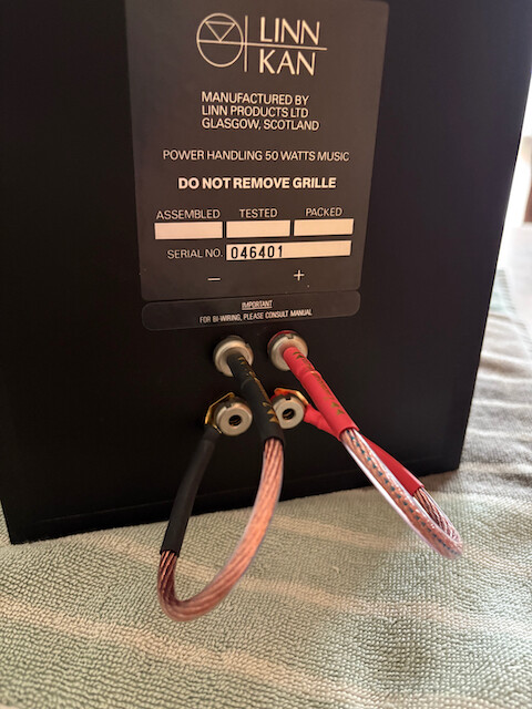

Best case scenario is it might be a dirty connection on the link plates.
They must be MK II to have jumpers. :thinking:
A rear cabinet photo would be good it could be they have been messed with.

My friend has managed extracting the tweeter without damage, it’s dead. Sealed and no response from the multimeter.
I contacted Linn, Hiquphon and the largest Linn dealer in Milano. No-one seems to have access to an original replacement, and the tweeter seems almost impossible to fix.

@MaxBertola
Hi
Thanks for the picture.
They are MK II I used to have a pair.
Personally speaking I don’t those jumpers I’d much rather have the proper link plates in place polished and I’d have Positive to top right and Negative to bottom left.
I would be very Skeptical about this jumpers anyway the links are much better and no bulk to add complications.
Too many connections and differences of materials for me.
Best…… :+1:
@Skeptikal
your opinions are sensible and legitimate, but you don’t seem to have caught the point.
I don’t have the original links, they are difficult to find and the jumpers are perfectly ok electrically. I tested everything with a multimeter.
