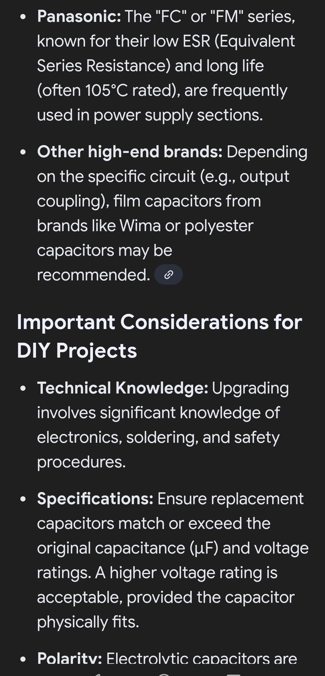

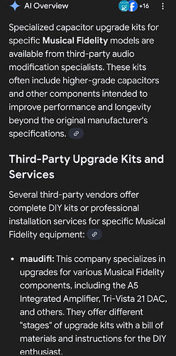

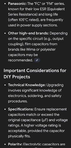

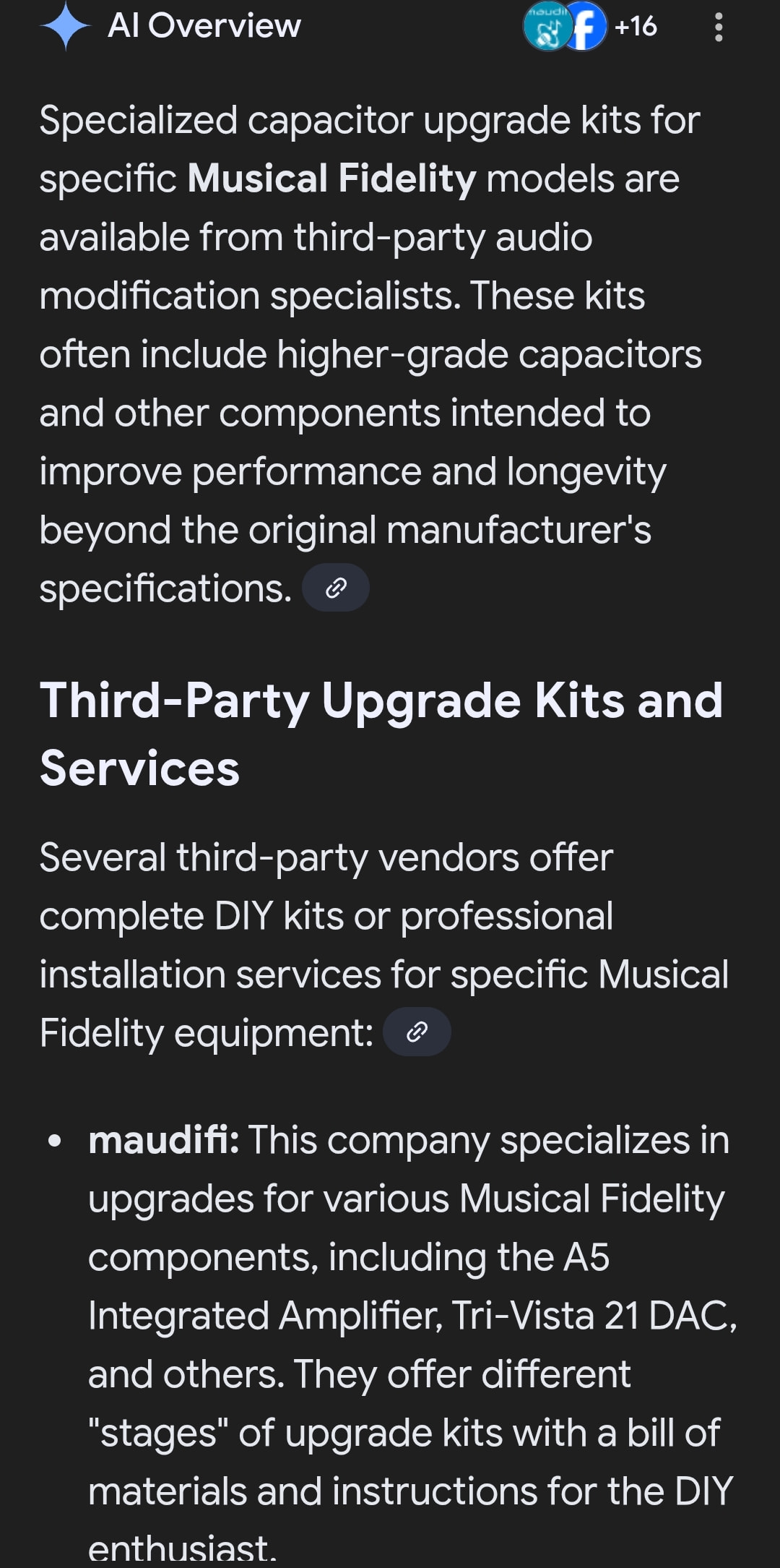

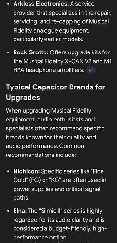

It’s interesting that you pulled that up from AI because I was looking at the same stuff which lead me to the OP. I also have a Musical Fidelity Tri-Vista 21 DAC that I’ve had for several years. It was when looking at Maudifi’s videos on you tube I was wondering if I should re-cap it. From memory I bought it used for about £800. Maudifi sell kits to re-cap and modify it at various stage of upgrade. The bill of materials for the stage 3 upgrade would cost more the DAC cost me initially. It also mentions the Rock Grotto upgrade for the X-Can. Mine packed in and I replaced the valves and recapped it myself for a lot less than their kit (which didn’t include the tubes) and I still have it in use. It must be 20 years old now and probably worth another recap but can’t say I’ve noticed degradation in sound quality. In fact I prefer it over my Headline. Seems like there is a very lucrative business in servicing hifi equipment that may or may not be purely nugatory.
