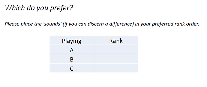

h). The listener ranked the ‘playing/sounds’ (c.f. Space Optimisation settings) in order of preference.
Note: The order in which the three optimisation settings were played was randomised amongst the six participant sessions with the intention of eliminating any potential bias introduced through the order of listening.
To introduce the participant to their session, there was a verbal introduction (that I read from a script) and then the participant was handed the following form to note their experiences.

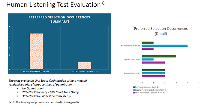

Hi IB. Your question about sound level is very important. The simple answer is that I was not able to run the tests fully compensated for ‘average SPL’ either within each participants session or even between each participants session. However - consistent volume level was not required throughout the test as I was simply trying to see if a specific marketing claim by Linn Products Ltd stood up to independent scruitny.
For the tests, each participant chose some familiar music (to them) to listen to and also choose the volume at which to listen. The particular chosen volume for the test was established during the ‘settling in’ period of 20 mins (reference step ‘f)’ in the Summary of the Test Procedure described above) and was set so that the participant was most comfortable and engaged in the music that they had chosen.
The trial was evaluating three (3) different settings of Linn Space Optimisation and one of those settings was ‘OFF’, i.e. ‘NO Space Optimisation’. The way Linn SO works means that the magnitude of the SPL below 100Hz will very likely vary between settings, however the decay of resonance in the room will also vary - so the question then becomes what is the ‘perceived loudness’ of such resonance?
Which brings an interesting point up for debate. When sound engineers (or anybody for that matter) do ‘level’ checks - what is the nature of the processing applied to give the reading? And if the measurement device is applying an ‘A’ weighted curve, how valid is that?

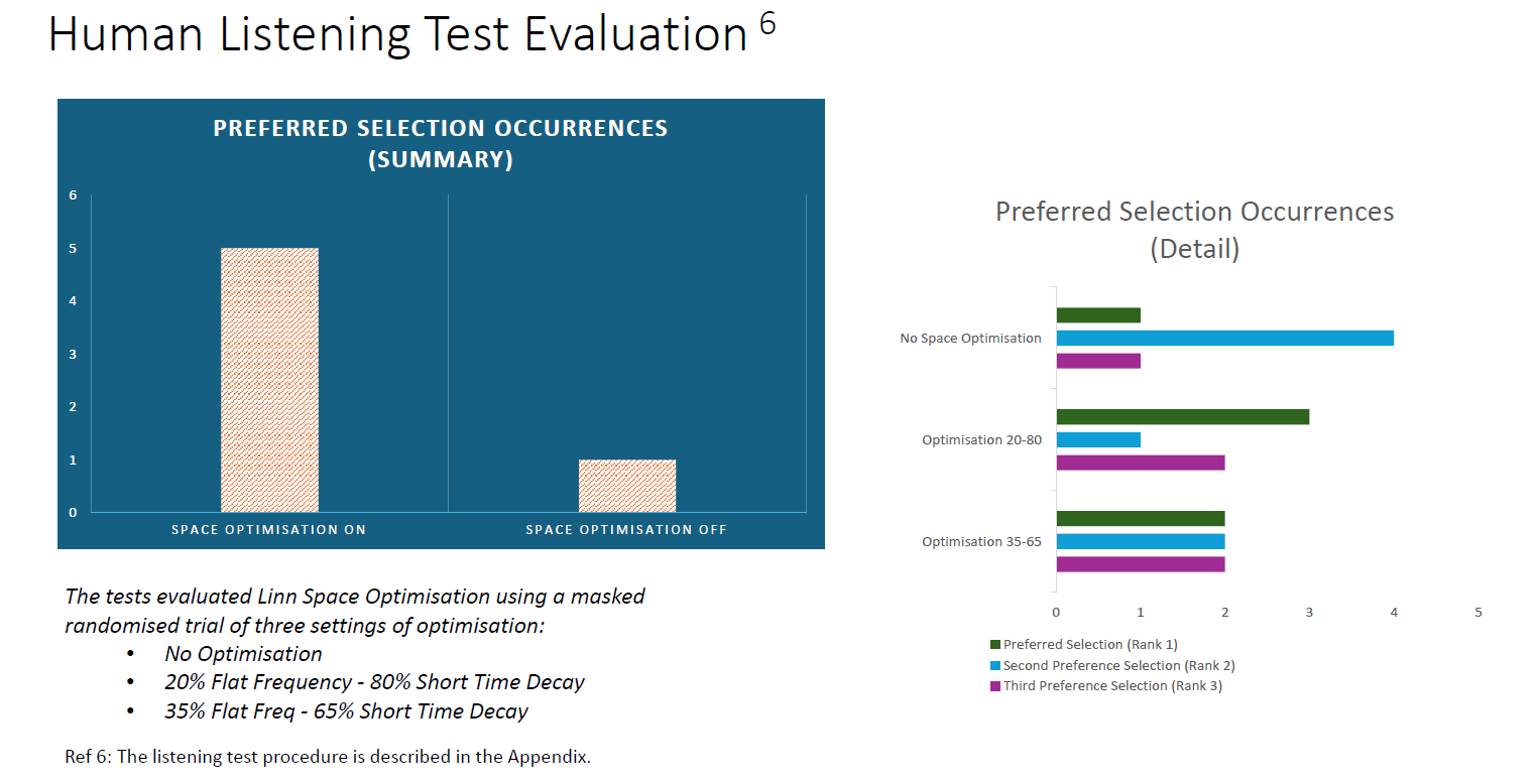

Three different settings of Linn SO are shown in the chart, and to help understand the straightforward gain change at the main low frequency (axial) resonance, each setting differed by 2dB from the next. In other words ‘NO SO’ gave the highest SPL result at the lowest resonant frequency, ‘20-80’ Linn SO Bias setting gave the next highest (i.e.2dB lower) and finally ‘35-65’ gave the most reduced SPL (i.e. 4dB below ‘NO SO’ and 2dB below the ‘20-80’ setting) at the lowest (axial) resonant frequency. I hope all that makes sense!
Read on, as I think the results below will generate interesting thoughts (if not discussion) amongst interested parties on the forum.
Here is the Human Listening Tests Results chart:-
PS: The information contained within the ‘appendix’ refered in the chart has already been posted above.
PPS: The SPL (above 100Hz) was consistent for each session, I.e the volume was not changed in a given participant session once set for comfort during the settling in period.
Now I’ll take any other feedback and questions…
