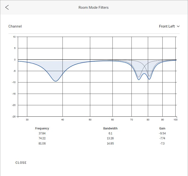

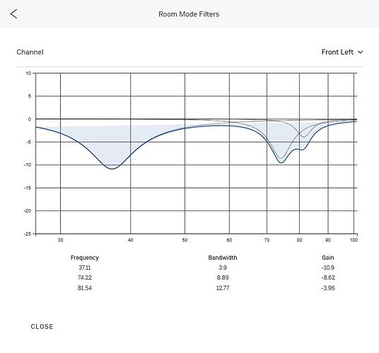

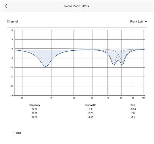

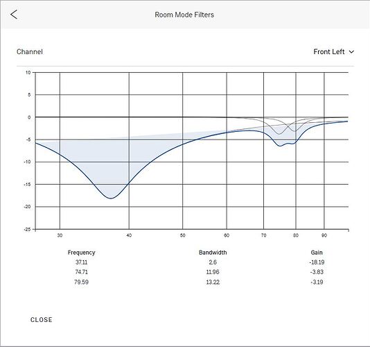

Here are examples to illustrate (L channel only shown) and Optimisation set to 100% to ‘flatten’ the frequency. In other words, Linn SO to make the phase vs frequency curve as linear as possible below 100Hz in room at listening position.
SO Room Correction Filter without Room Treatment ………
SO Room Correction filter with Room Treatment……..

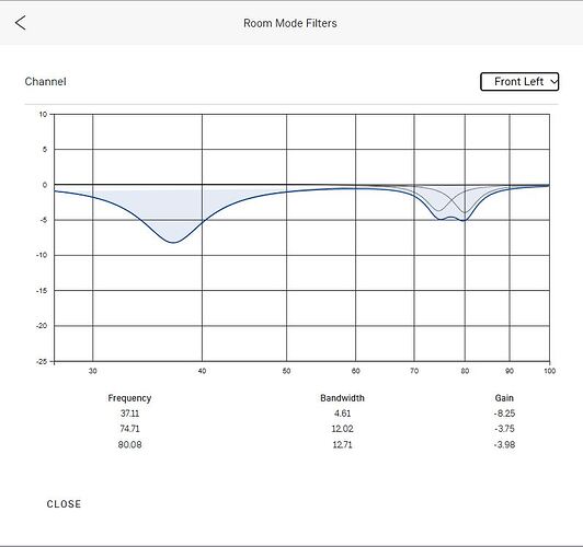

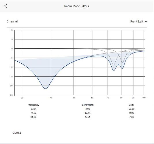

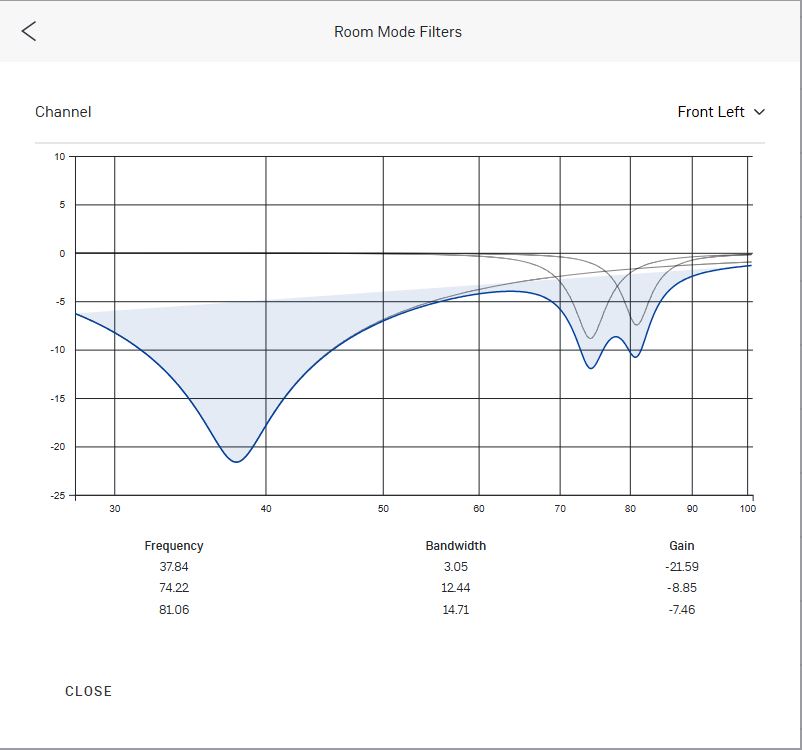

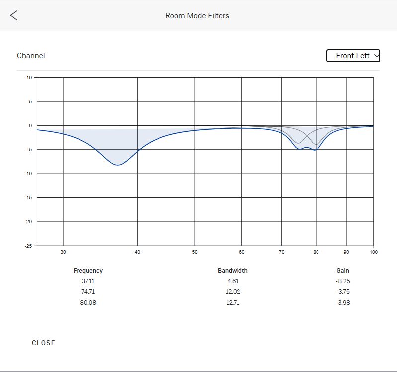

For a less extreme example the following Optimisations are for Linn SO to give a bias of 55% to flat frequency and 45% towards shorter time impact (for corrective impulse response)….
SO room correction filter without room treatment……….
SO room correction filter including room treatment…….

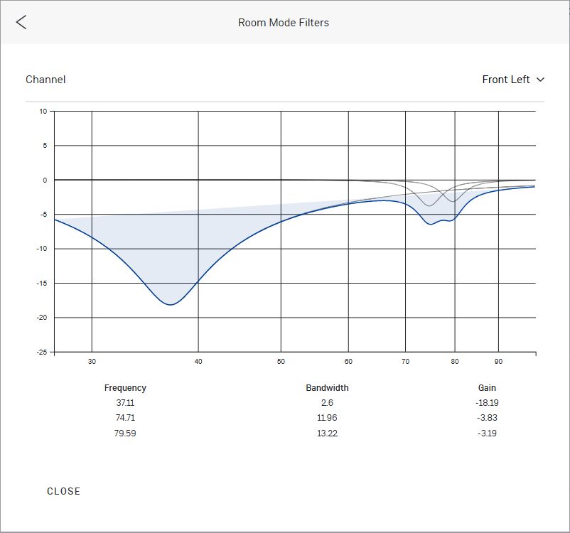

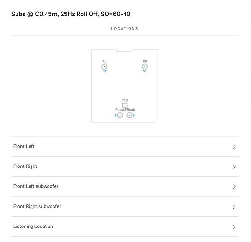

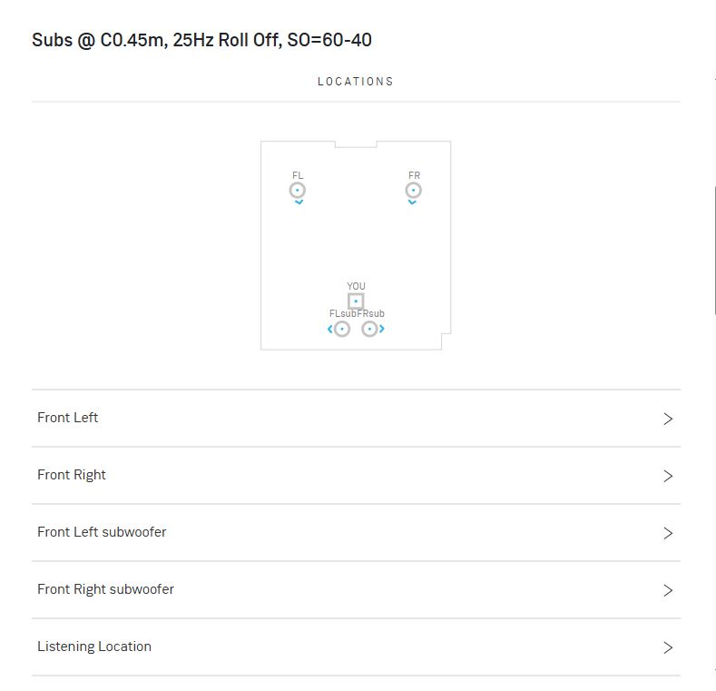

A few days ago I mentioned that the HiFi dealer had demonstrated a Reference level sub bass for a few hours in my home.

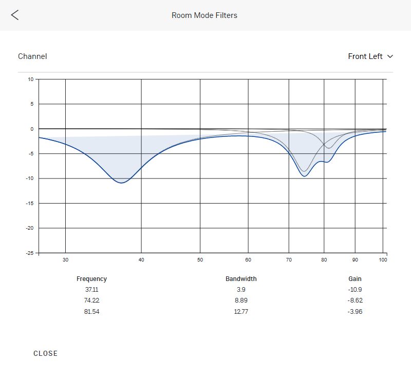

With Linn SO, I can also model the room optimisation filters it will produce - before I actually buy any particular sub bass.
Here is a simulation I did for just such an evaluation…. (Optimisation bias is set to 100% flat frequency for this prediction)…….
The relevant comparison graph from the four above is the second one in the list. Ie SO on at 100% bias in treated room, but that comparison one of course is without sub bass in room.

Having done all the scientific modelling, big question is which brand and where will it/they go in the room?

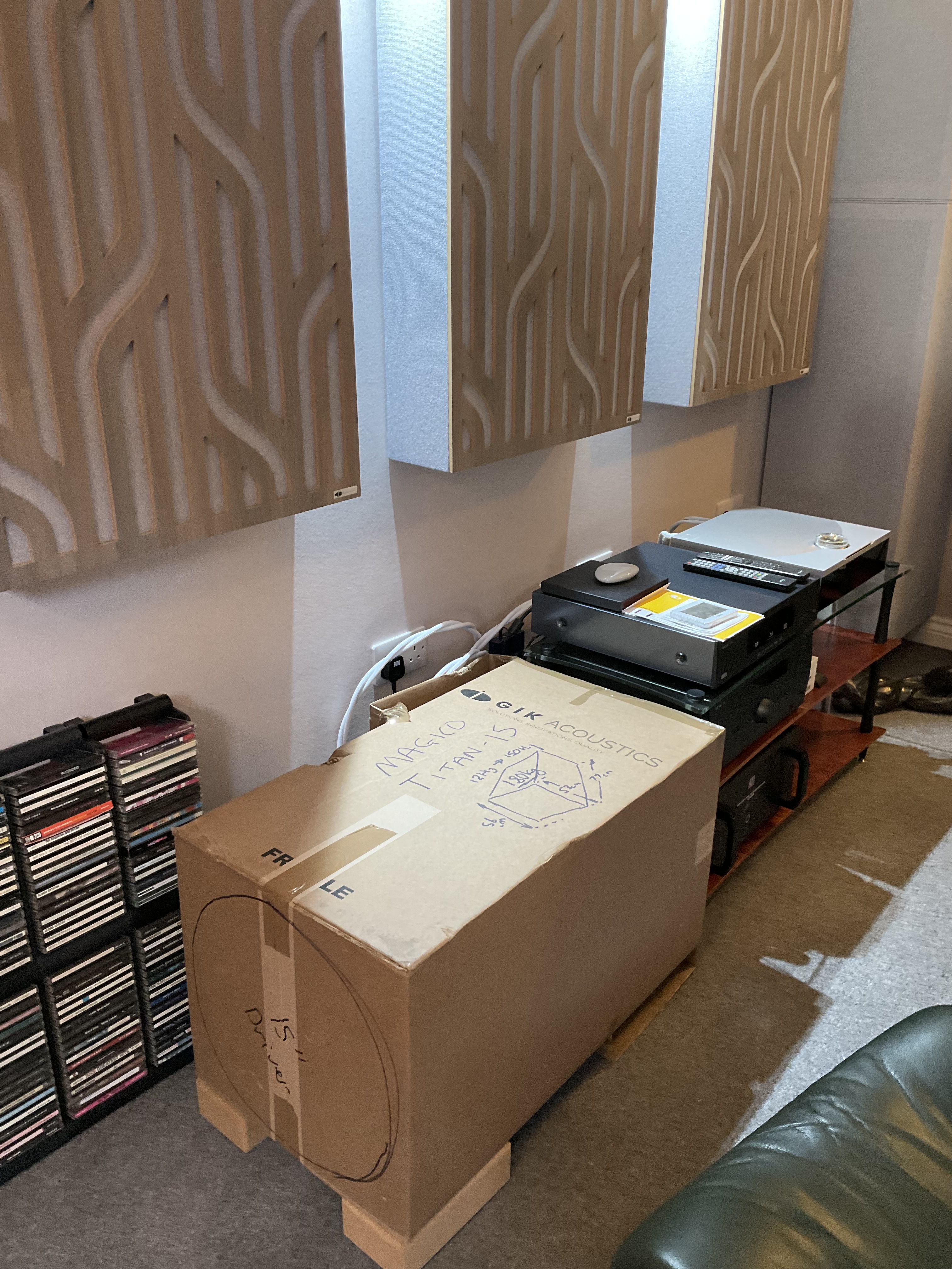

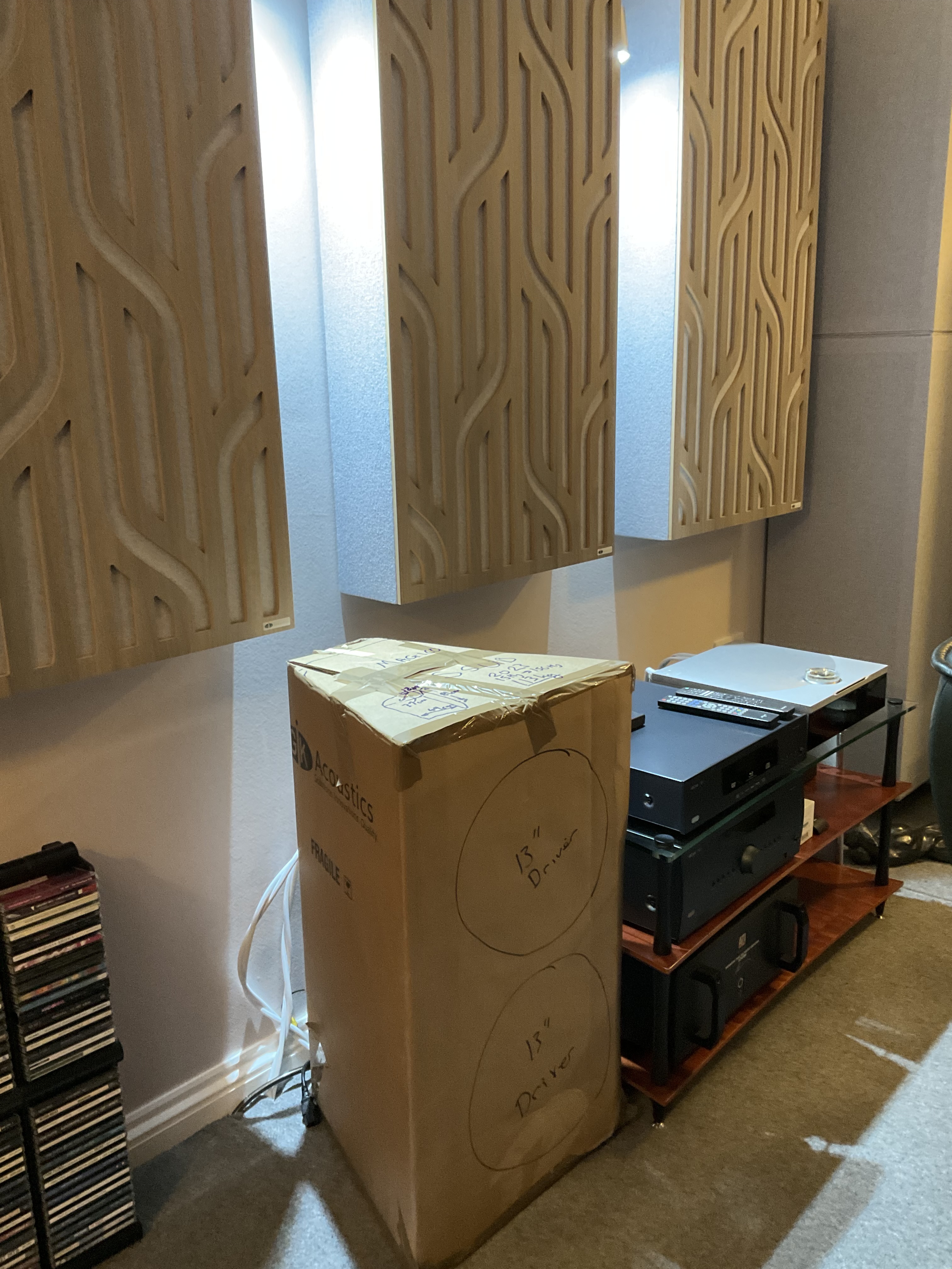

Luckily, I have some spare cardboard from a recent delivery of room treatments, so here are some potential ‘space models’ I prepared earlier placed in candidate positions……..
Will it/they be the Magico S series sub……
Or something better?………

Hi @Middle , Have you - by chance - been ‘zooming’ into read the hand writing on the top and sides of the cardboard boxes?
It did bias the diagnosis …
