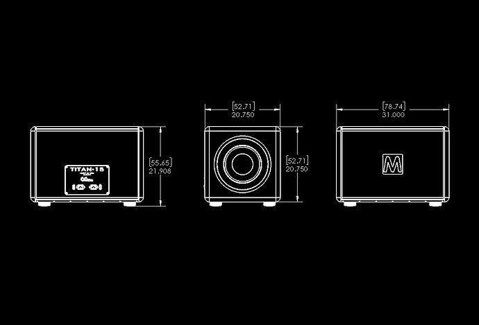

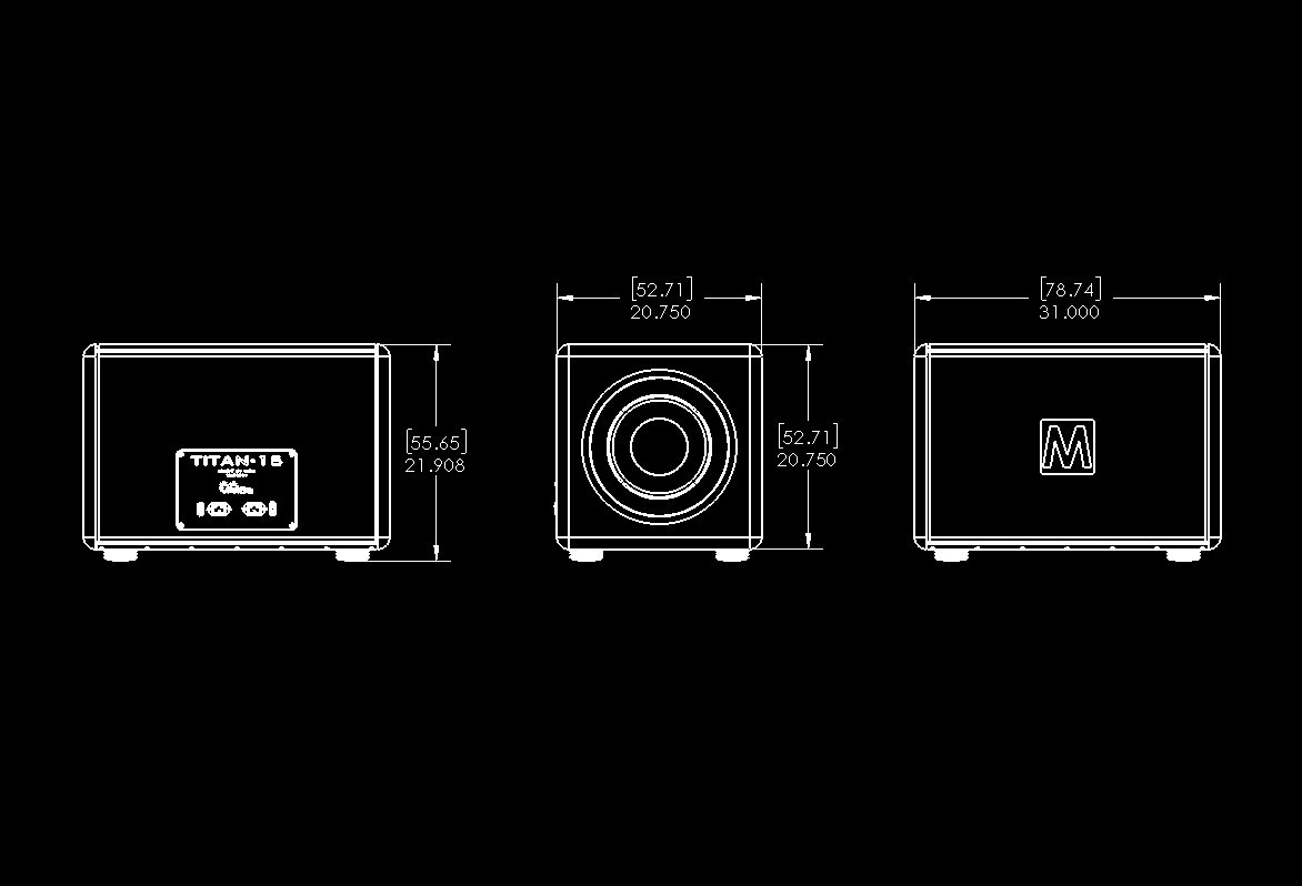

The way I see it is there is still quite a bit of innovation going on in very low frequency sound reproduction. As a research engineer, I note the effort by WB to really change the landscape. However they have fundamentally fallen short in the electronic control and integration aspects with this product. In contrast, Linn, with their PWAB and digital DAC in their most recent top of the range floorstanding loudspeakers have something interesting.
Magico, with their American conventional sub bass concept and brute force approach but integrated intelligently with a fantastic DSP.
The DSP permits so much direct control over time delay, filter characteristics (choices of Bessel, Critical, Butterworth and Linkwitz Riley) along with filter order, (variously, 1, 2, 3, 4, 5 & 6 depending on filter type selected), corner frequency, gain AND, having done all of that selection, additionally an audio band graphic equaliser, each band with tuneable corrections of filter Q and centre frequency.
In contrast the IGx can only be limited down to 30Hz corner frequency, continuously variable gain and phase (that can easily be knocked out of position) and a semi random ‘ears’ based tuning approach - Ugh.
Now, combine elements of all three of the above, and maybe we have something useful!

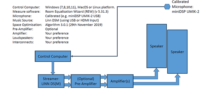

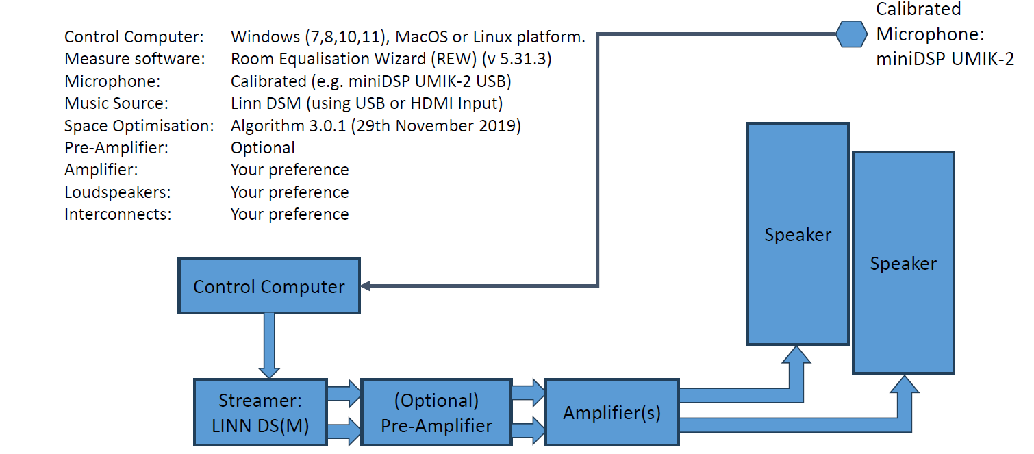

This is the Forth Posting and represents a typical Equipment List and Arrangement:
Note that the diagram shows a miniDSP UMIK-2 measurement microphone.
When the method was developed I was using miniDSP UNIK-1 and all results presented are based on UMIK-1 obtained data.
