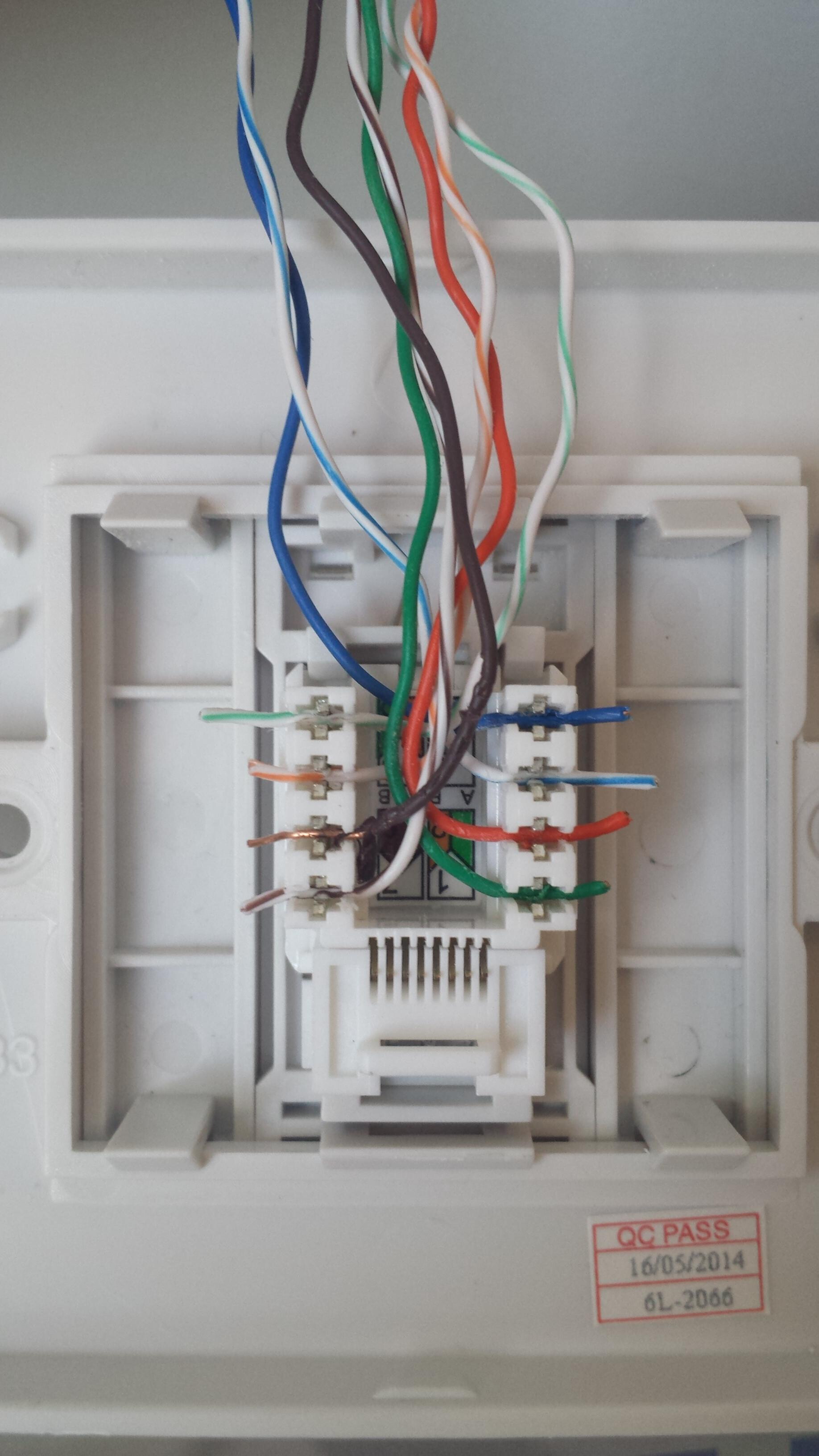

In wall socket wiring (I’ve found) can be sub-optimal. e.g. connected with no care to the twisted pair geometry. This will result in signal transfer anomalies such as poor near end crosstalk, return (reflection) loss and skew delay. This means the thru the wall section of cable fails to meet TIA/ISO standard & the result can be a fancy (expensive) Cat-7 pluged in the wall socket performing & sounding like a Cat-3

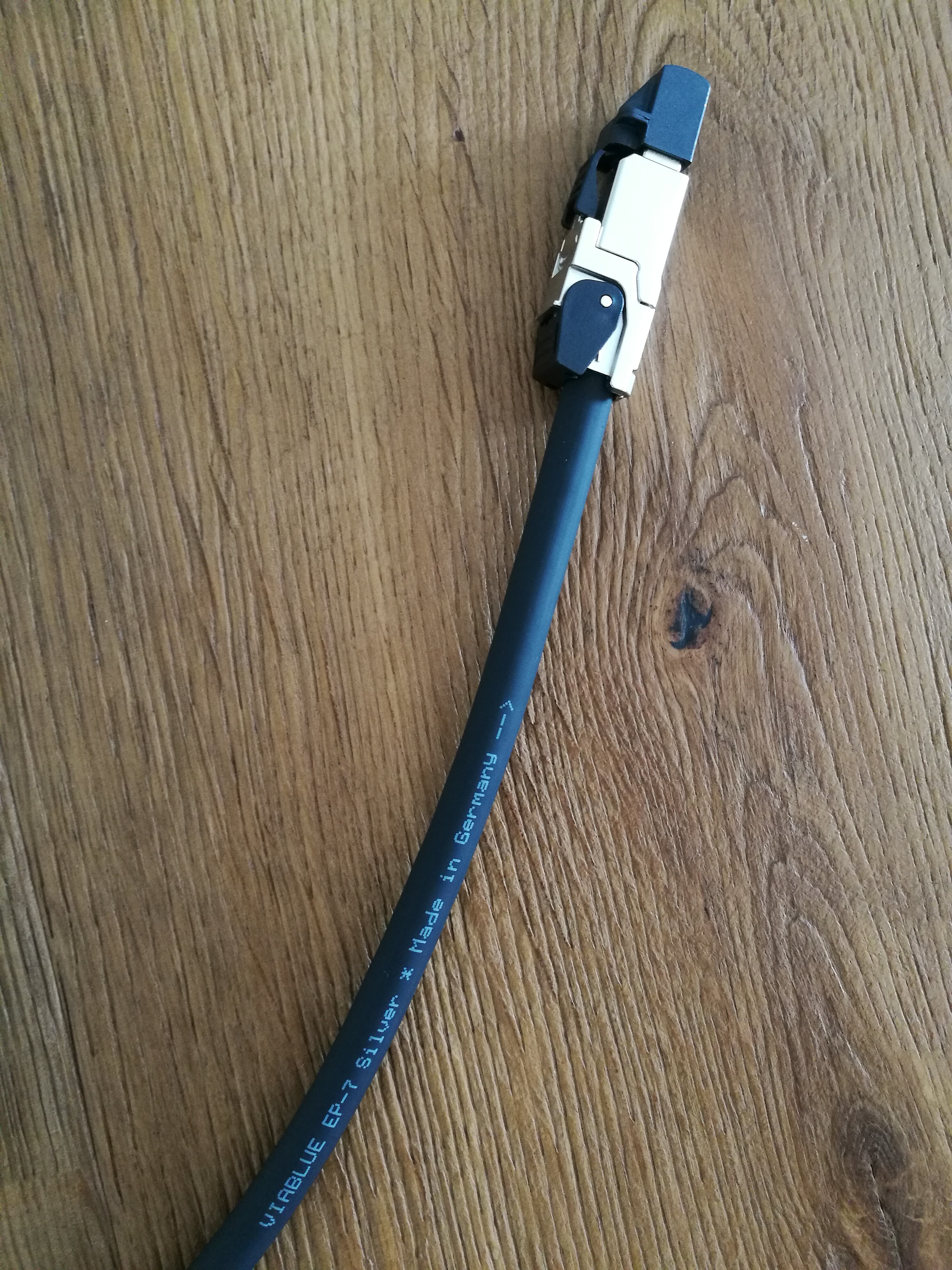

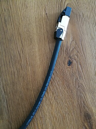

Connection of this patch cord made with Viablue cable and Telegartner connectors seems very easy. I do not know what may be wrong with that. Code color has been respected with 568B and there is a “click” which should assure that cable manager has crimped correctly. Anyway I’m not skilled about the problem behind their wrong connection so I understand your suggestion :wink: and the risk to not have a well certified cable. A certified CAT5e may be better of a CAT 7 crimped in the wrong way.
This is the LAN cable I wish to connect from the NDX2 to the wall socket.
Actually my concern is more about wall socket crimping.

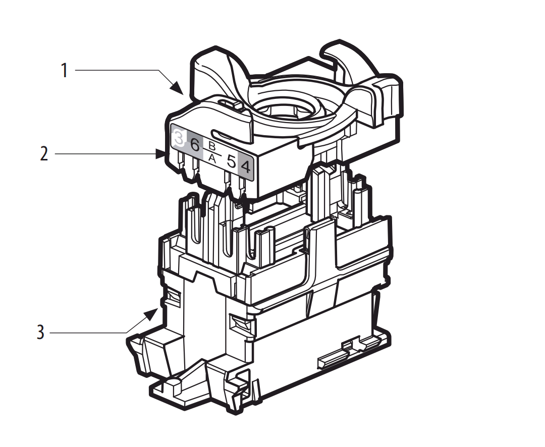

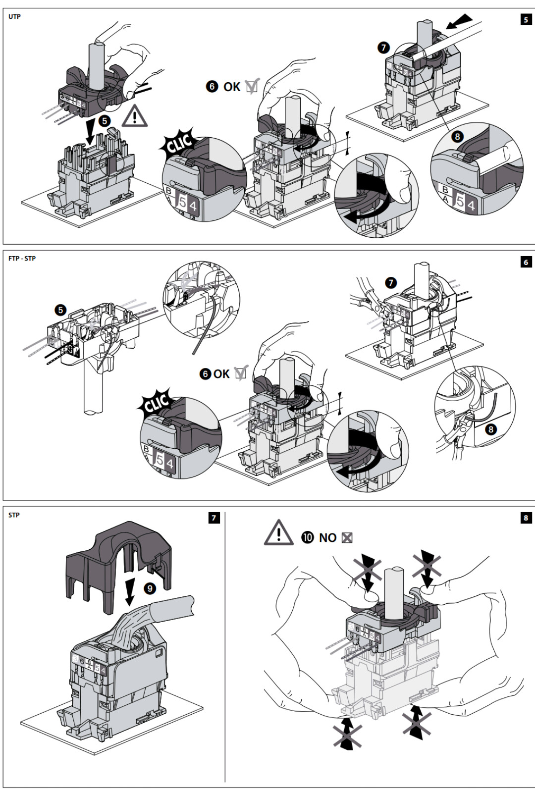

Thank you very much for your reply. Unfortunately I’m using BTicino series for wall sockets of my home and I’m forced to use the only rj45 socket available on the catalogue, Bticino N4279C6A.
Ah, I see. Well, it seems with a little patience you should still be able to achieve that without too much difficulty.

Unfortunately I already bought 11m of Viablue EP-7 and it’s a pity to not use it. I should have asked before buying it.
I’ll crimp it at the wall socket at NDX2 side and I’ll use a wall hole at router side crimping a Telegartner RJ45 plug without wall socket.
I’ll connect the cable without its shield like a simple U/UTP and I’ll borrow a dedicated fluke tester to check it (A colleague at work have a dedicated fluke equipment to check Lan cable).
I’ll buy a proper patch cable without screen (U/UTP) like FS, Cable Monkey or BJ to connect the wall socket to NDX2.
My concern about the Viablue EP-7 is if using a S/STP like a U/UTP the screen can become an antenna and get a worst cable than my previous UTP cable made with aluminium conductors.
