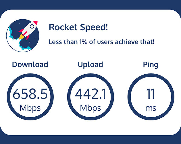

For clarity. I have mesh WiFi routers hardwired together (backhaul is hardwired not wifi) with one of these routers hardwired to my fibre optic access point. Currently my WiFi ranges from no lower than 400 to over 700Mbps throughout my house.
Hardwired
WiFi
