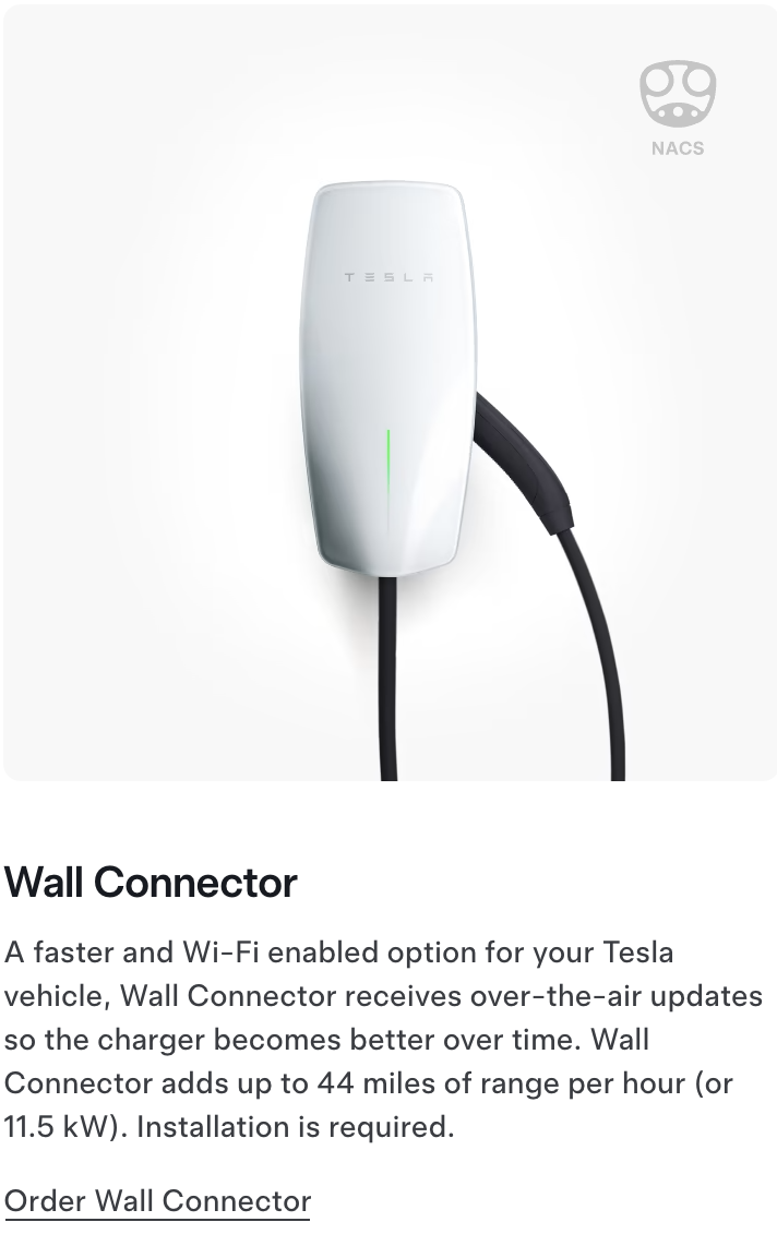

Since your EV has a Type 2 AC inlet, you might want to explore the Tesla destination chargers!
I’m using this one for my Rivian.
