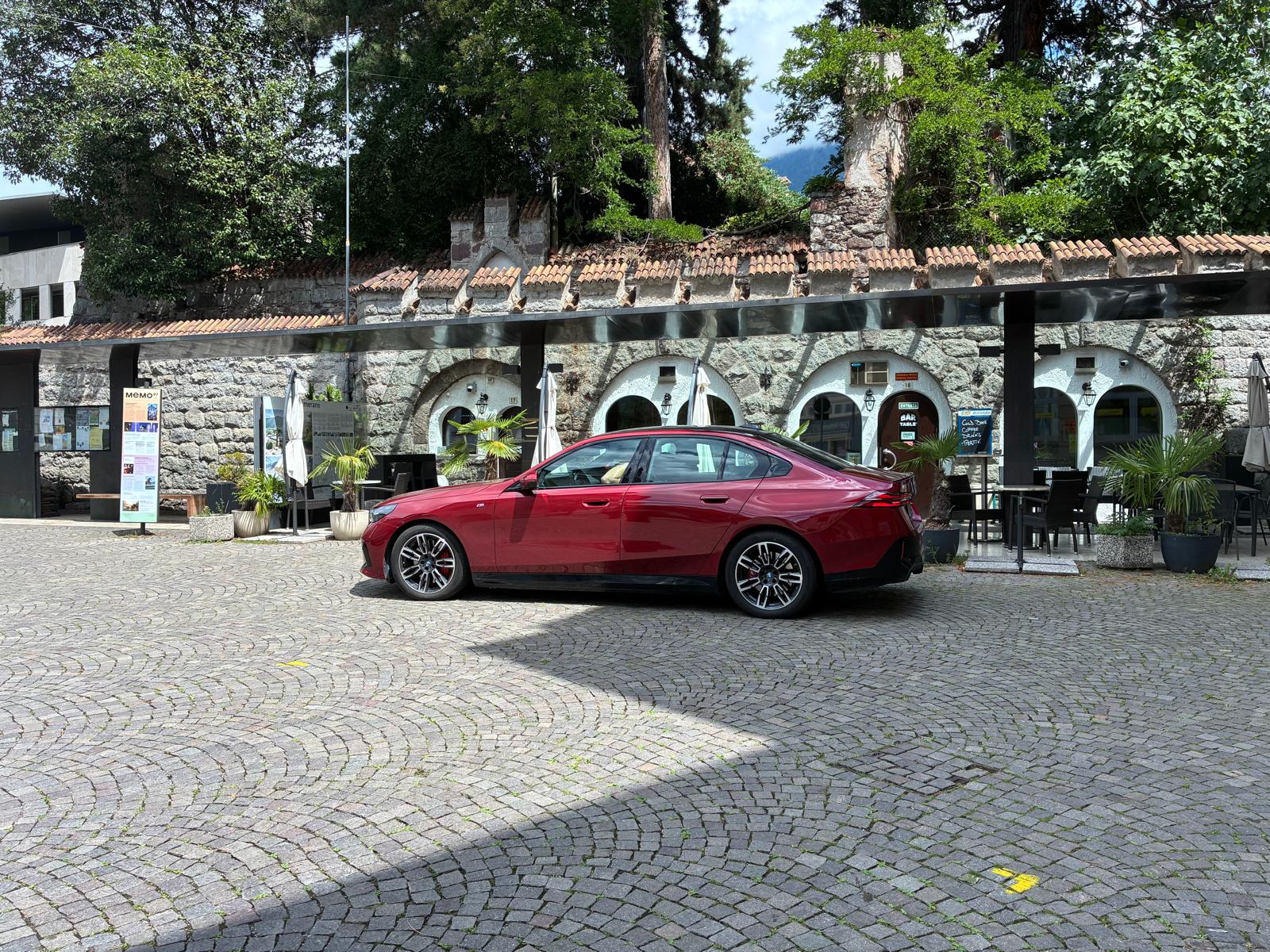

I am now driving this I5 with all wheel drive since January this year. Consider me a convert as I had big diesels before. In general quite happy with the experience. And the driving part is actually fantastic.
My normal pattern is to charge when I am in the gym at work. So that charging doesn’t hurt. And on long distances like driving to the Netherlands or Italy I find the charging normally not an issue as you also with any other car make a stop to eat and later again to pee and have a coffee. The only disadvantage is that you often end up on a place which is not directly on the autobahn…., but one get’s used to that and starts to know the spots with preference. When I need to change again in 2,5 years I am sure I will get another EV as I also belief that by then range has further increased. Now in winter 360 or more and in summer 460 ish. The only change in driving behavior is that before I drove topspeelster when possible (260) or anything under that what was possible…. Now I don’t hit topspeed so often as the consumption price is too high and your range get’s too much affected. So now normal cruising speed on the autobahn is 160-180…
