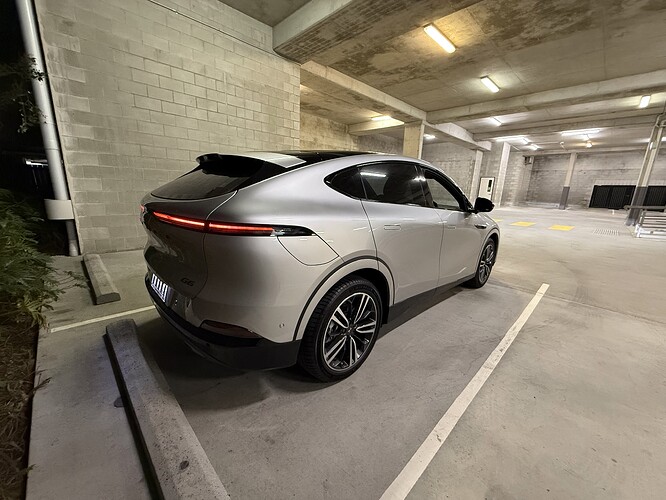

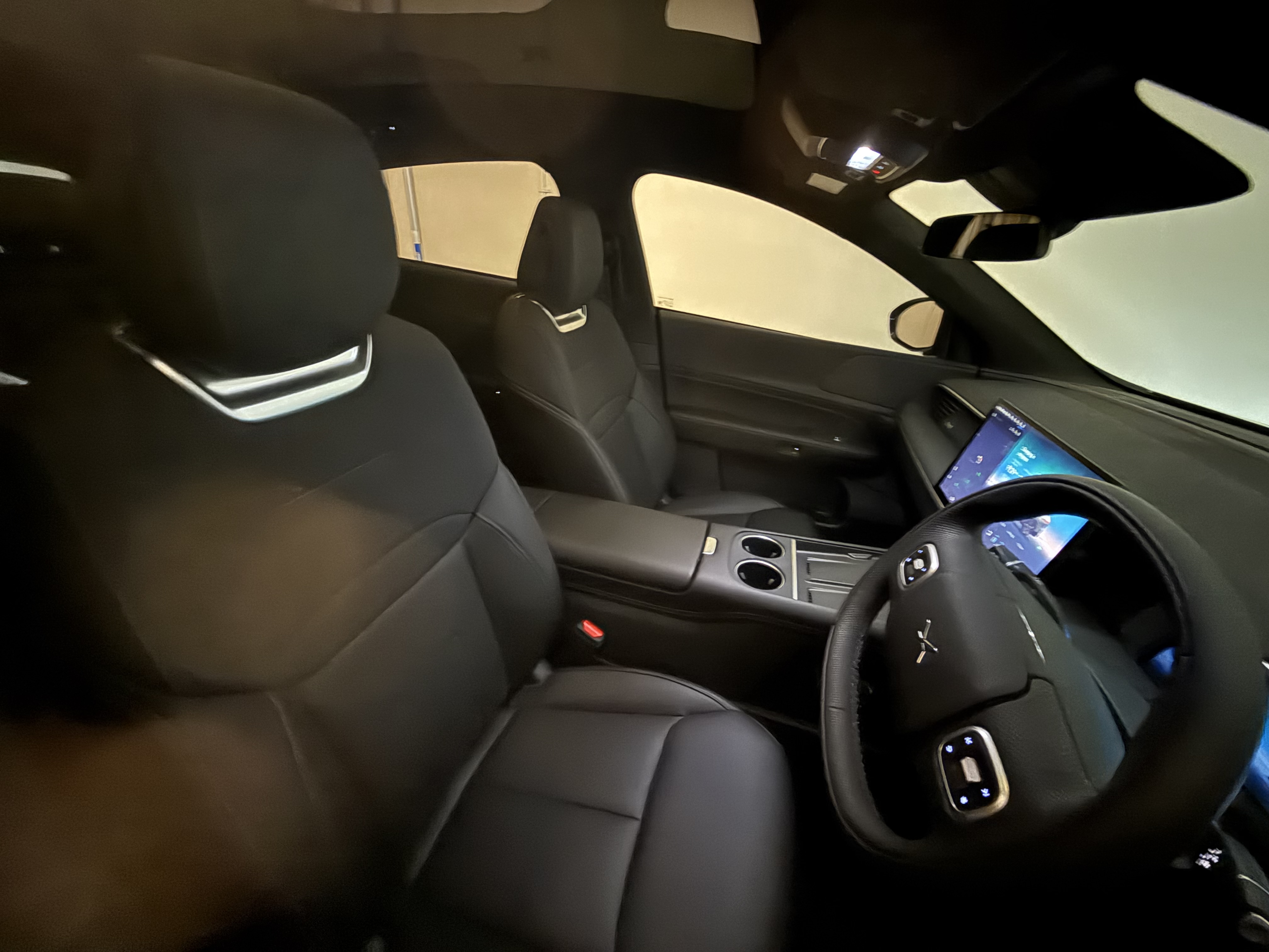

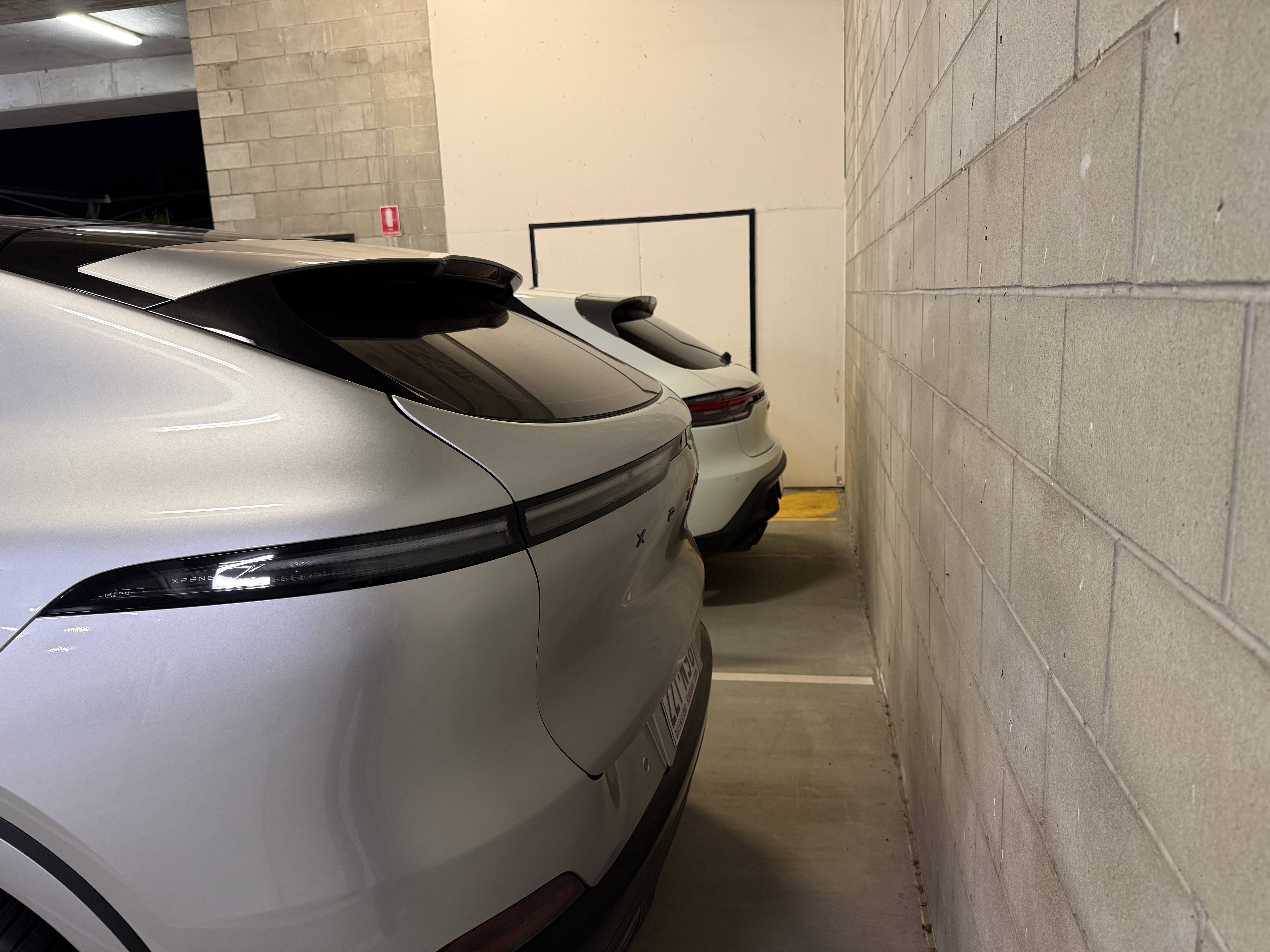

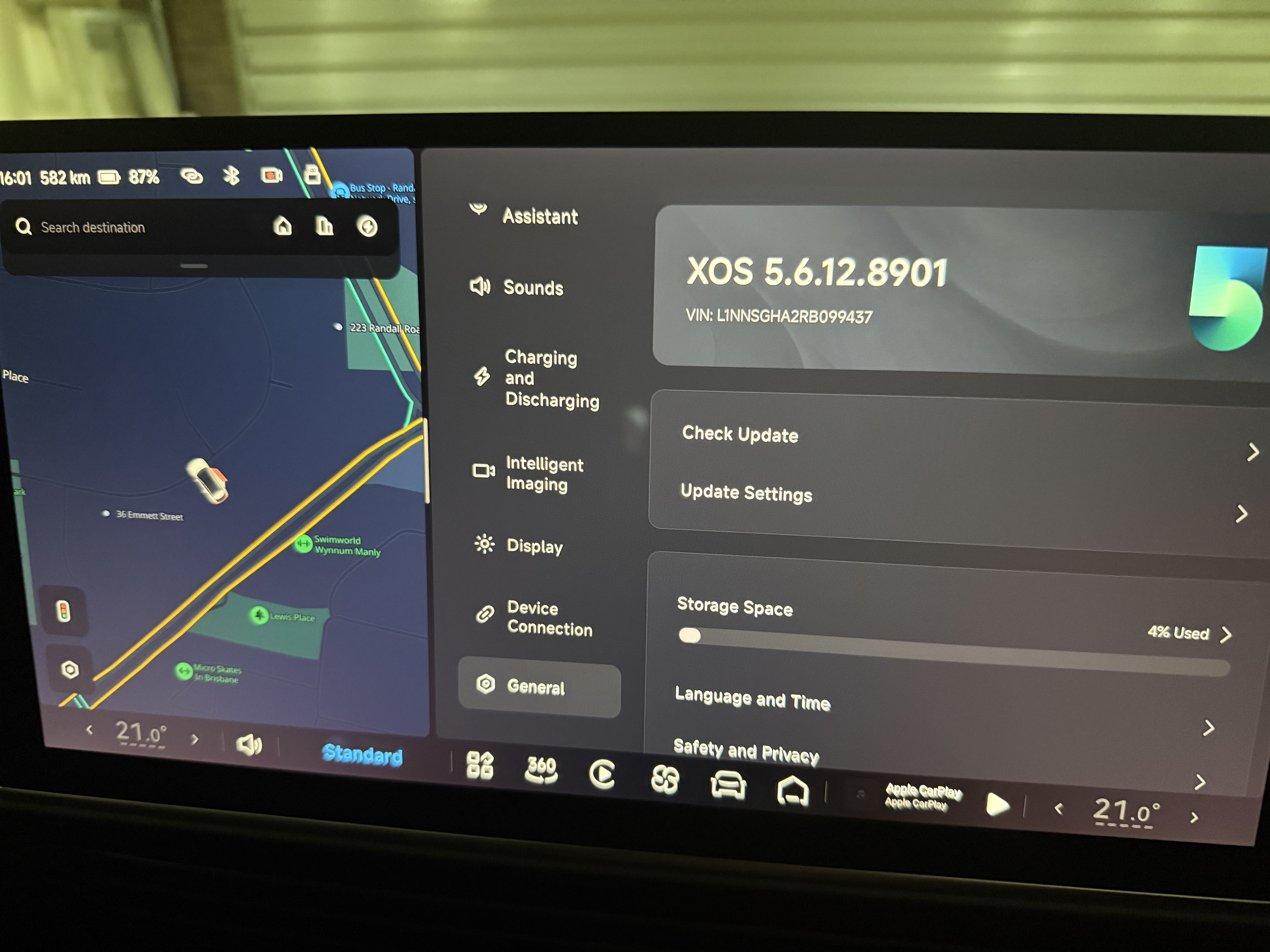

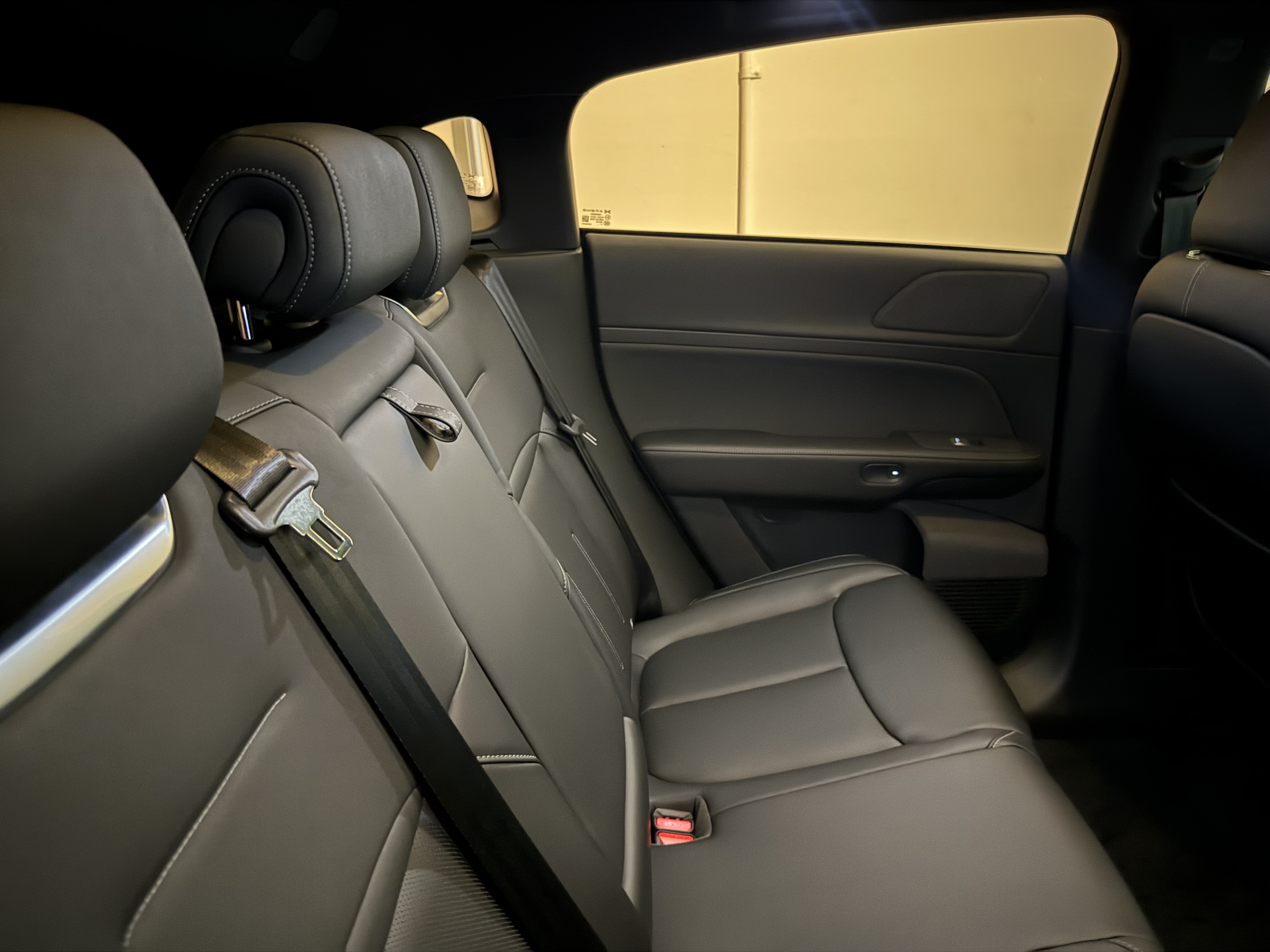

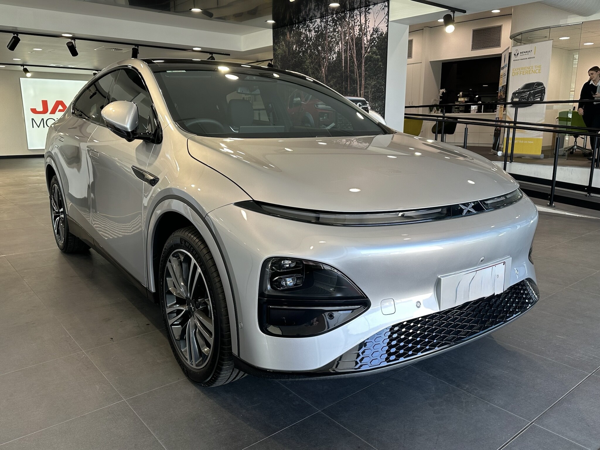

The wife and I are planning to retire in a few short years, so we thought we would try out an EV to see if it would be suitable for us travelling around Australia. This one has about 570 klm range & is currently one of the fastest charging EVs. Absolutely loving it at the moment. XPENG G6 Long Range
Let us know how you get on.
Am I right n thinking that Australia doesn’t apply tariffs on cars from China and so they are much more keenly priced than in Europe?
.sjb

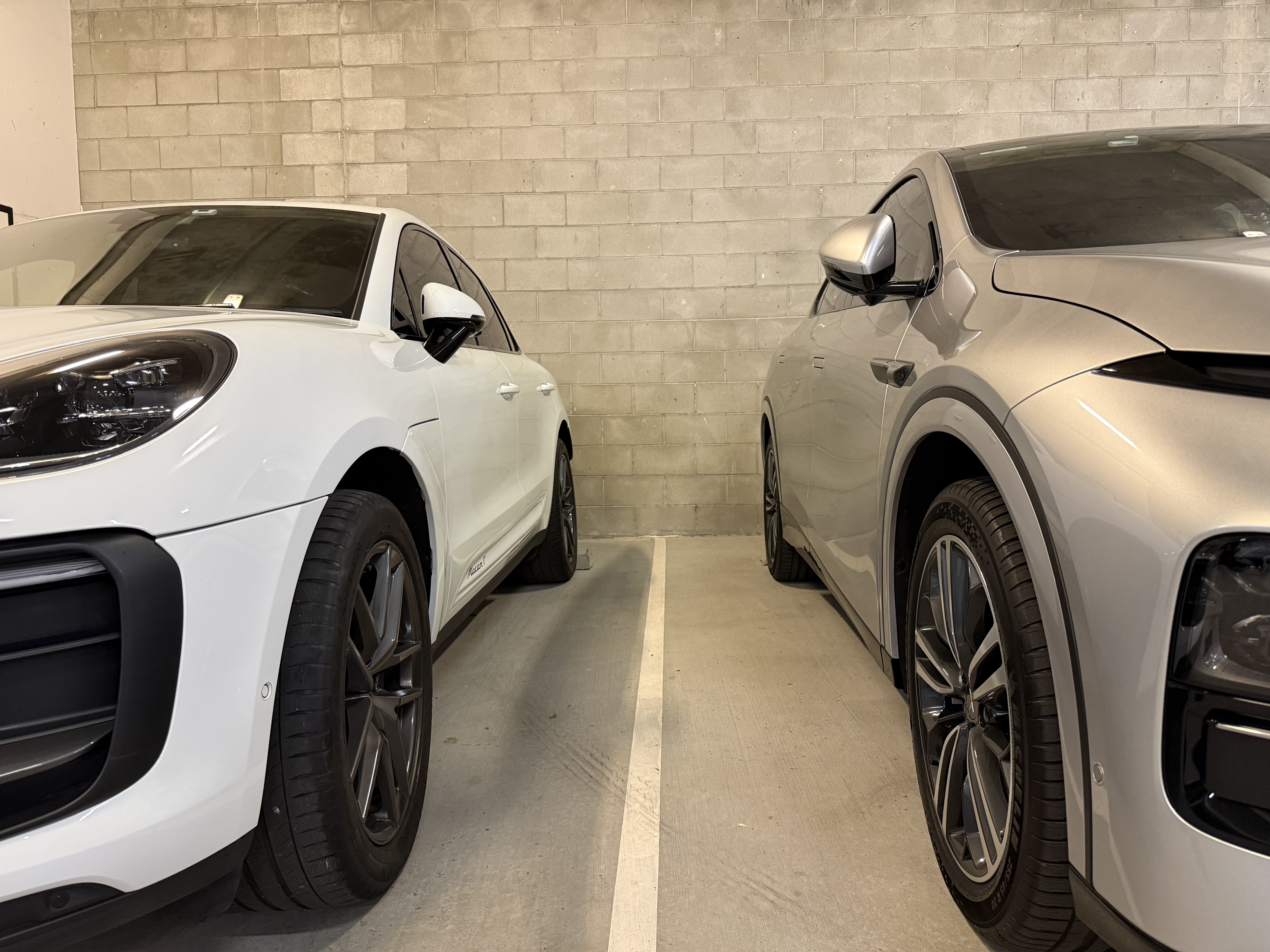

I’m not to sure what the prices are in Europe/Uk. I paid about £29,000 all up on road. Just sorting out the charging with our solar panels. Now scheduling recharge every few days between midnight and 0.600.am. We did our first fast charge 180klw the other day that cost about £12 for 50% of a full charge. Seems to be averaging about 11.4 KWh per 100km Just doing city work driving. I think XPENG may have used the Porsche Macan T as their inspiration. Very similar design specifications and performance.

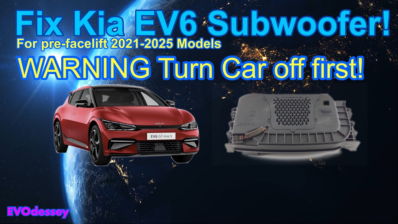

I’ve watched several YouTube videos and channels about Kia EV 6 and general EV channels and thought I would highlight this for @BruceW as I seem to remember you saying that your sound system was less than stellar.
Apparently, it could be due to out of phase subwoofer wiring.

Thanks for the clip re the sub-woofer. I’ll explore that at some point.

Well I switched the connecting wires on the sub as suggested and absolutely worthwhile! The sub is now more audible but it is also helping the whole sound balance. Not sure I would rate it as amazing but far better than it was. A very easy job to do by the way, just need a tiny screwdriver and maybe some needle nose pliers.
