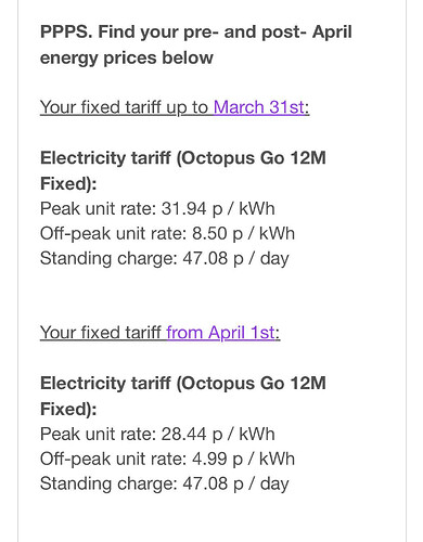

A temporary - but welcome - tariff reduction on Octopus Go.
Adding 35kwh overnight (5 hours x 7 kWh) drops from about £3 to just £1.75 (plus the standing charge). That’s 70% charge in my R5 for the equivalent of 1/3 pint in my local.
It’s even cheaper on Intelligent Octopus Go, as you would expect.
