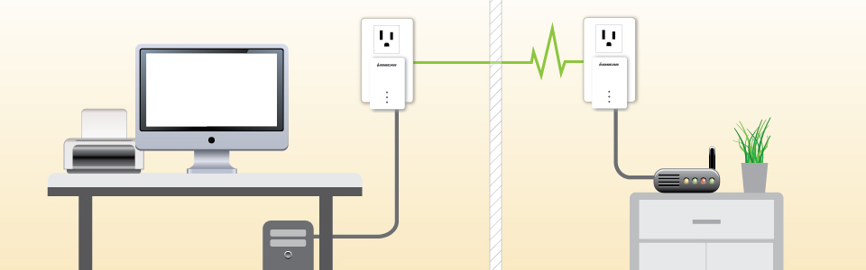

“Ethernet over mains” (or “ethernet over powerlines”) are little boxes with ethernet ports that you plug into mains outlets. They use the mains cabling for data transmission.

‘Ethernet’ over mains devices (a misnomer as they certainly do not conform to the Ethernet standard) works by transmitting a high level of electrical interference over your mains supply. This is so strong that it generally finds its way around all of your mains cabling, and quite often your neighbors too. The fact that your HiFi kit isn’t plugged into it directly doesn’t make it immune.
