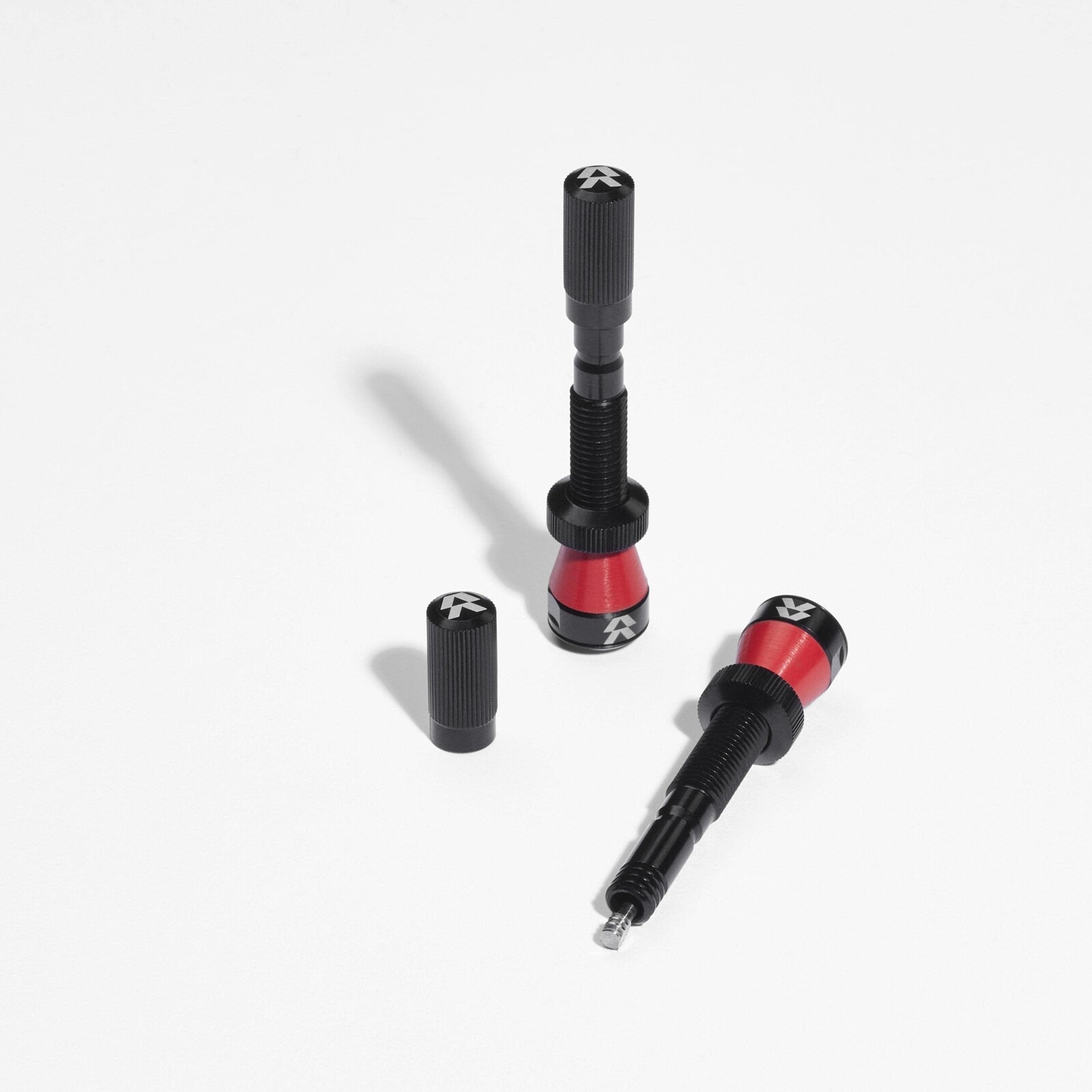

It can be tricky to initially inflate a tubeless tyre with Presta valves.
However, i’ve found using Reserve Fillmore tubeless valves make the initial inflation very easy.

The Reserve Fillmore valves are a nice upgrade comparet to normal tubeless valves. But olso thse tend to clog up over time. Luckily they are servicable with a 3mm hex key in the base.
A got a set when they was launched. They are somewhere in the basement now.
