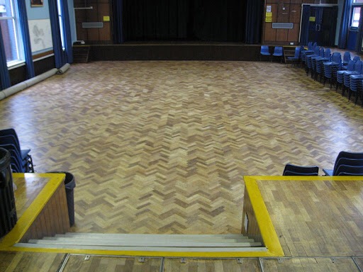

I remember my old primary school assembly room had a parquet floor. Was also used as the dinner room and as a space for many indoor sport and martial arts clubs. So had to put up with all sorts of spills and knocks.
