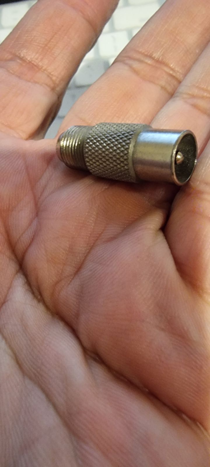

Its intended to be installed into F Type connectors, so not sure how it will accept the 75ohm Coax plug you need for your NAT-03
@Gigantor … 75 ohm coax
Hi Mike, just needs an f-type to PAL converter and its done, antenna has an F-type as well so all easy with RG6.

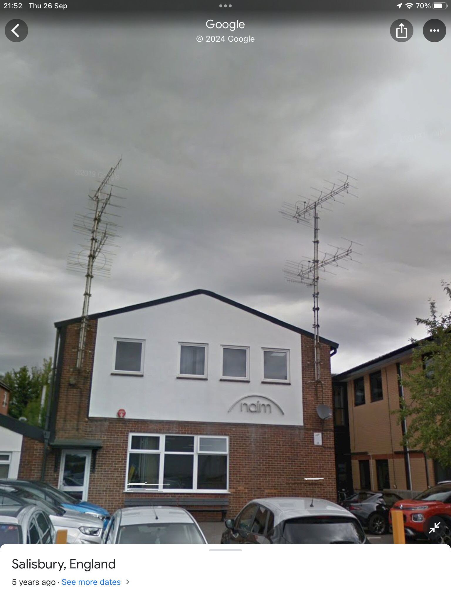

Thanks both. I just thought all those antennas on the gable end at the factory (none of which look like mine) must count for something.

They’re a bit further away from Rowridge than thee ‘n’ me, Chris. If I walk over one street (OK, poetic licence, maybe two streets), I can see the mast……providing it’s not pi$$ing down like today!
Which leads on the the old joke from the Solent area.
“If you can see the Isle of Wight from the mainland, then it’s going to rain. If you can’t see it, then it’s already raining”
Yes G23’s all well above the roof line, all sucking in 250kW from Rowridge at only 30 miles distant.
Salisbury, marked on the maps as “Here be dragons”? :laughing:
(Got some decent fly fishing though)
