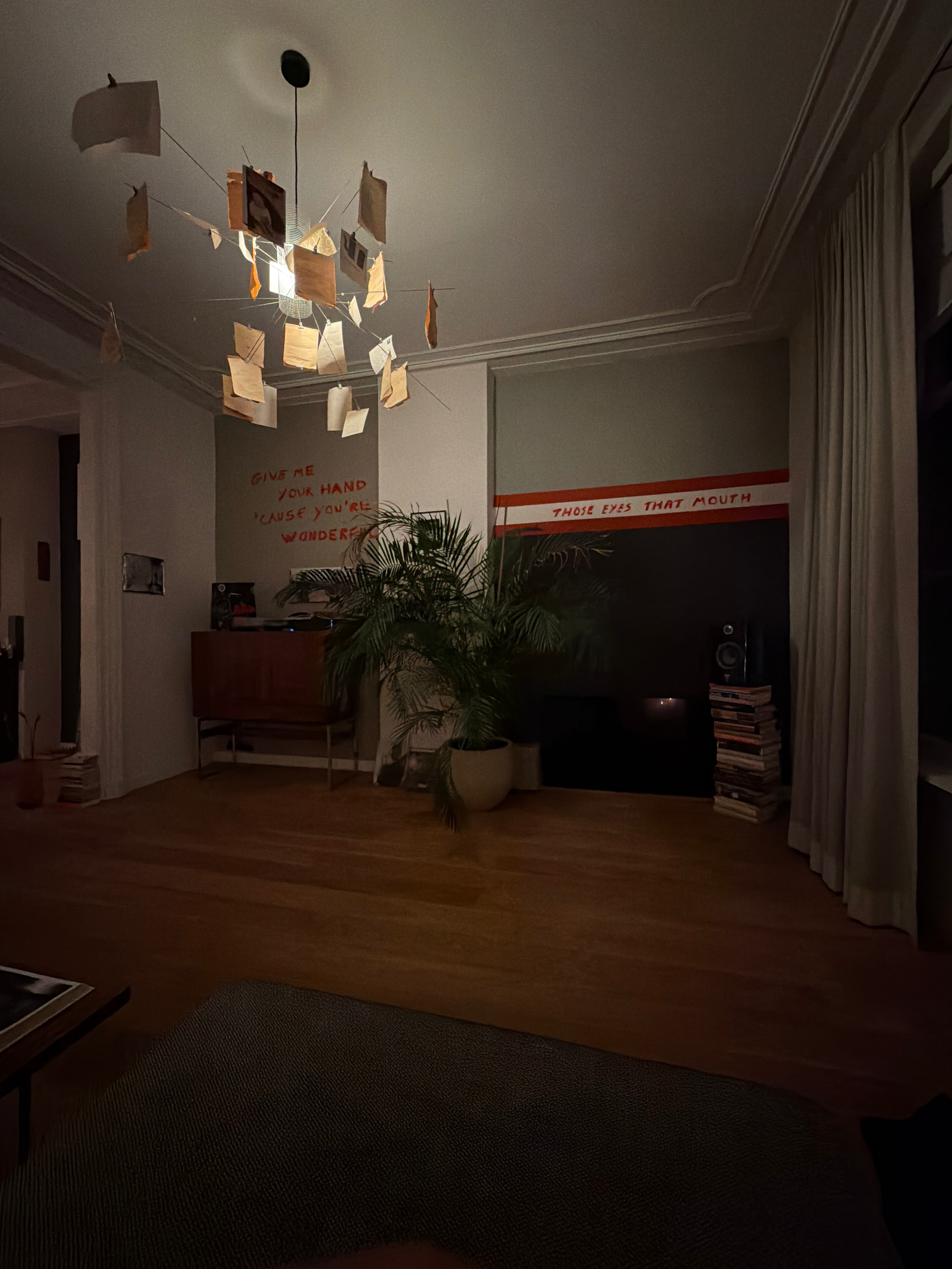

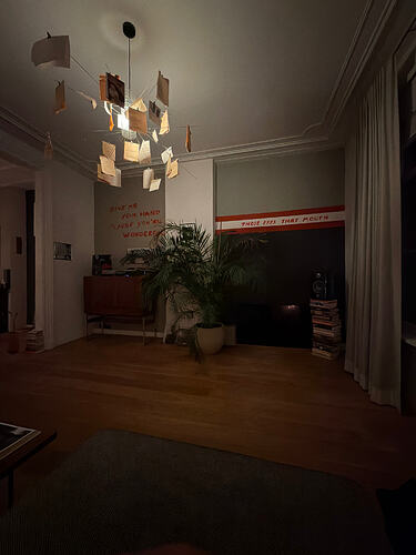

Basically I have the idea that my system is wxtremely good, but that I don’t get the benwfit of it, while I am like 5 meters away from it on my couch. Bit how to rebuild this?
I should add that my right speaker is placed on big piled artbooks, 1,5 meter high and my left speakers stands on a sideboard. Both ofcourse with small things under the speakers.
Are your Sopras set along your 10 meter or 5 meter wall?
They are set to half of the room on the long side.
This is the 5 by 5 side of the room, left of the picture is the other open 5 by 5 area where on the top side is a naim muso 2 that I use when I walk around to match volume

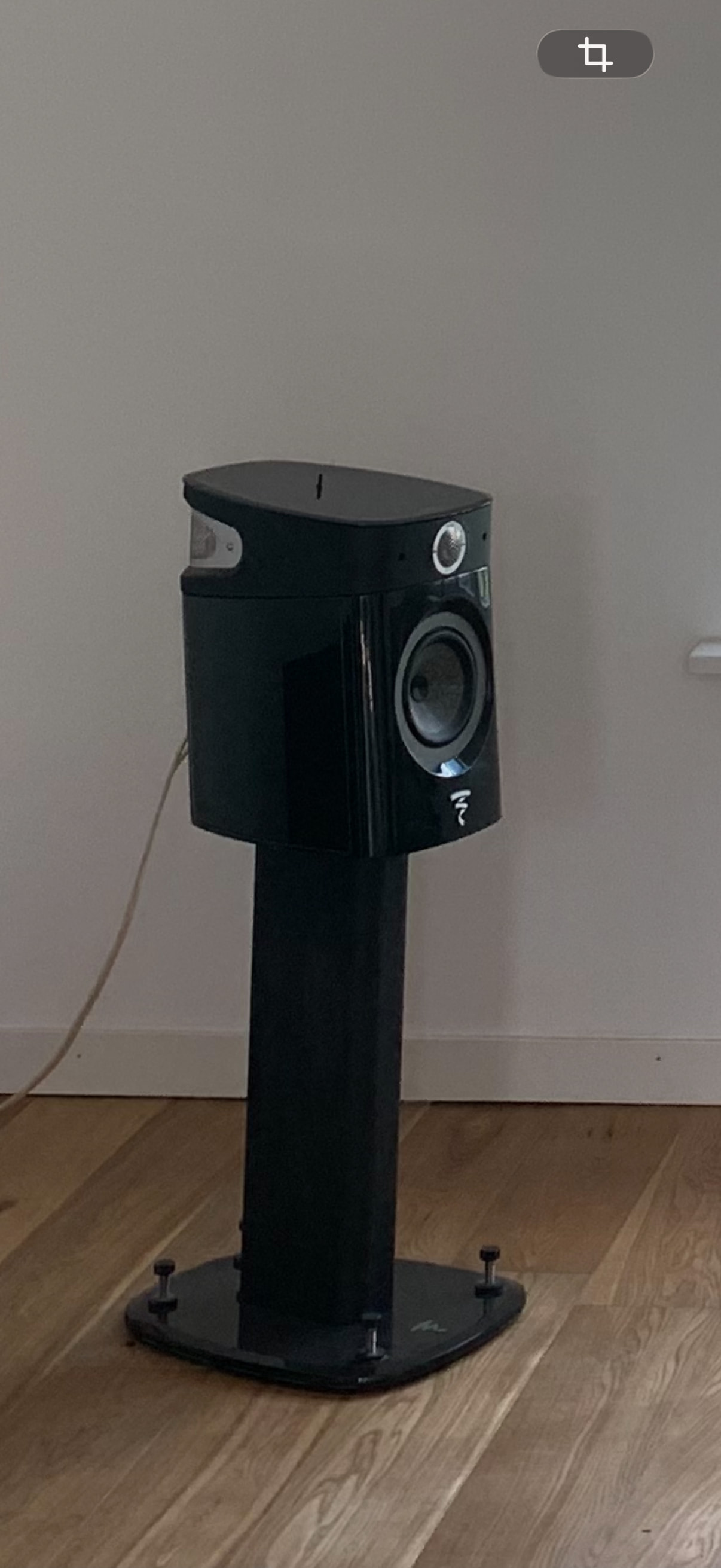

should I get my floorstands back? I don’t use them for esthetic reasons. .
These are the ones I used to use.
Absolutely you should use the proper stands!
Will thay make a lot of difference? Also get the left one more to the right?
It still amazes me that people who spent serious amounts of money on their setup don’t take the effort to dive into the basics of speaker placement. Sopras and the Nova are serious pieces of the kit. But the speaker placement is absolutely cringeworthy in this case. They aren’t even at the same height!
Unless you really need the money, I would spend some time to experiment with speaker placement. I guarantee you that you might not want to sell your speakers anymore cause it could easily transform your experience of how they sound.

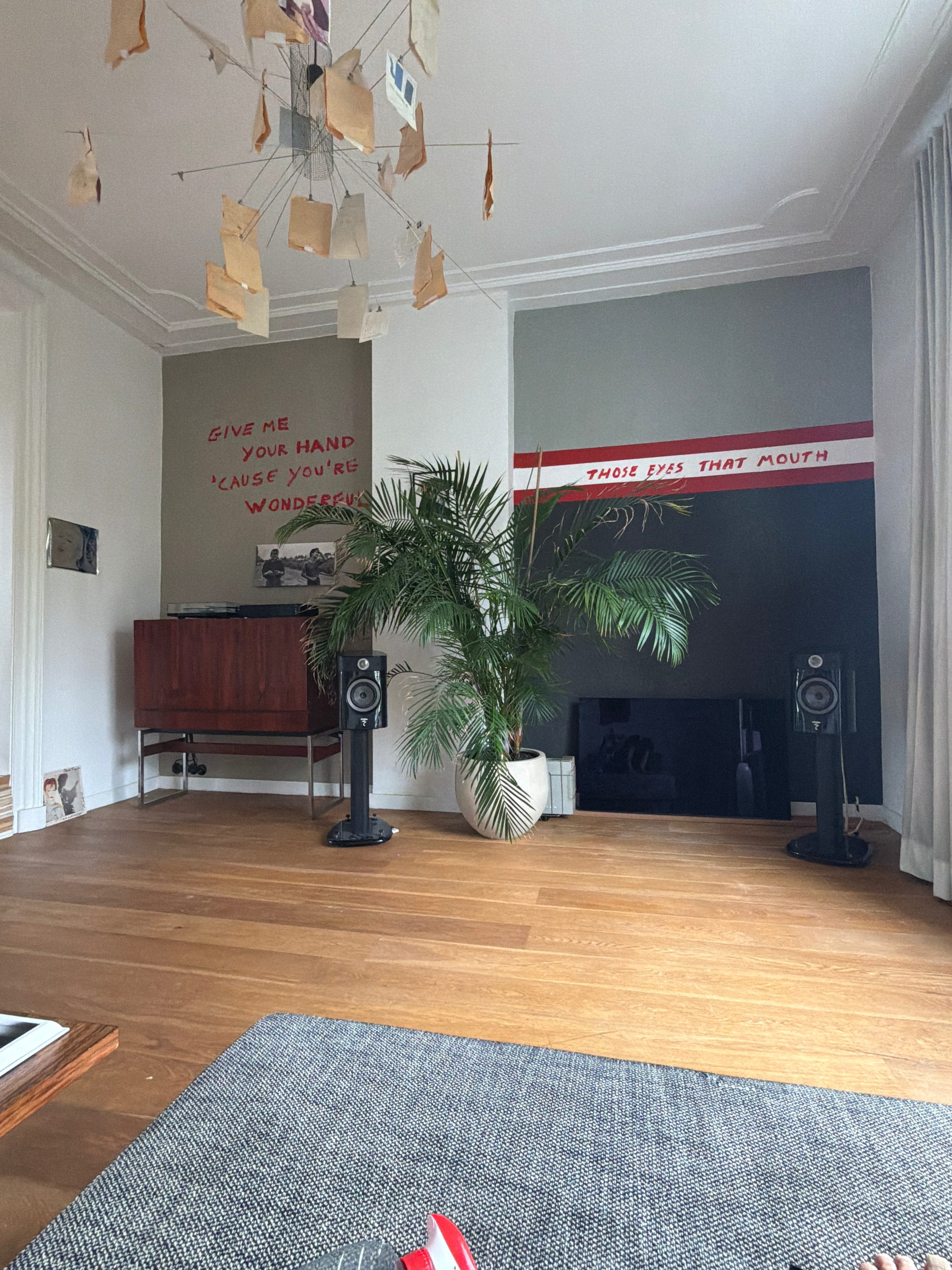

Wow… If you keep them, you should definitely use the stands. First try them with equals distance between speakers and distance from listening position. Position them with enough room from the back- and side walls. Finally position them with a little toe-in (something like 10 degrees). Than spend some time experimenting: Move them closer together, change the toe-in, change the distance from the walls etc. It can be a bit of a painful process, but the rewards can be huge. It actually hurts a little bit to look at how the speakers are positioned now :slight_smile:

I’m a bit confused! They’re Sopra 1 stands right? Why did the dealer take them without the speakers? Perhaps I’m missing something?
In any event put them all back together, experiment with positioning as suggested, and I think you’ll find you have a great system.
I got the stands back and I am positioning them more suitable to my ears. Sounds allready way better.
Ah yes, that looks a lot better! Enjoy what you have…
