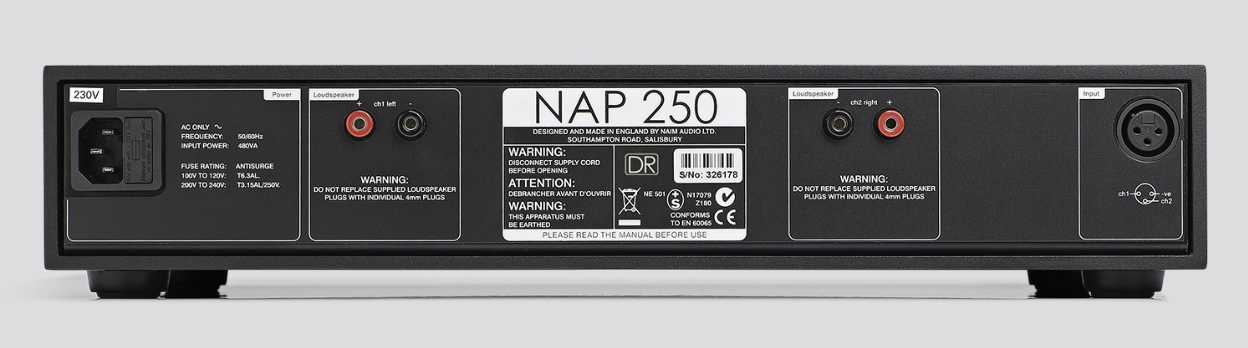

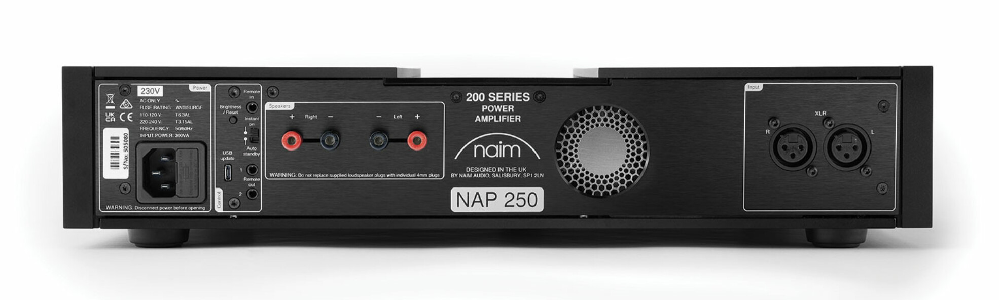

Looking at the NC NAP250, the speaker terminals look more centered. Could be a problem?
I’ve seen demo setups by Naim and by my dealer using the 222/250 on Fraim, and neither of them had the narrow rear leg fitted, so I think you’ll be fine.

For those who own the new 250. Have the speaker cable plugs (that plug into the amp) changed?
I cannot find a picture, but I believe they have changed somewhat.
They forgot the rear fraim leg when designing the new one..
The black plastic box is a different shape to the old one, that’s all.
