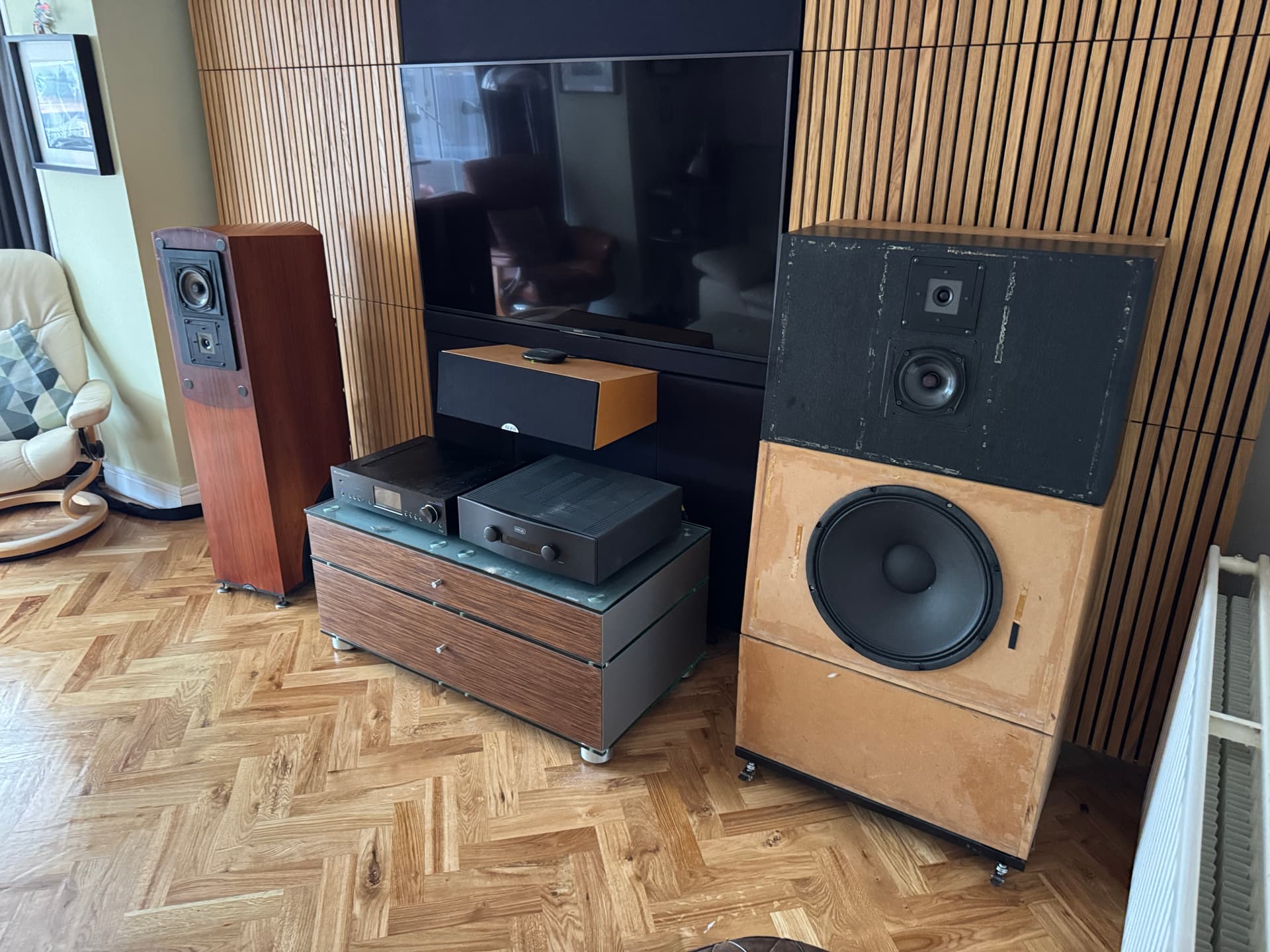

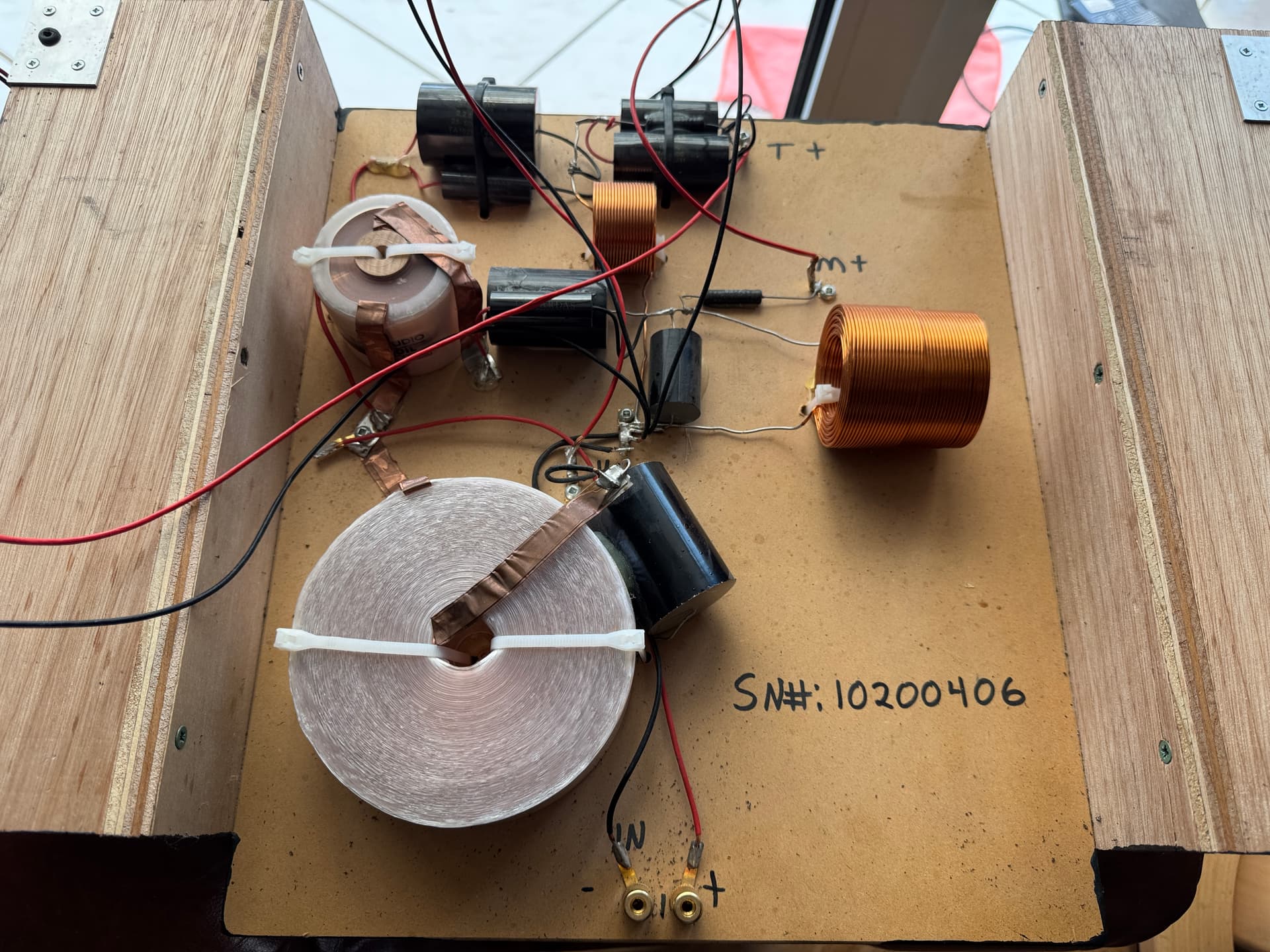

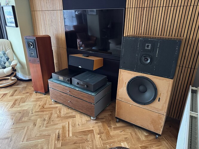

Today I have temporarily set them up, I replaced the knackered foam in the base units, filled all spike holes and replaced the aluminium pads. Gooped up the base interface to the bottom box and engaged my super squints whilst plugging in the totally gorgeous cross overs. Lets be clear I dont know much about much but I know quality components when I see them. The big coil on there is is like 15cm across. All cardas caps etc.
With the seal made on the bass units and tightening them down, the bolts were like hand tight the sound is, well, emotional.
I am amazed by the bass. In front of it, you feel it, but walk to the next room and its not an issue.
Clearly these are a project speaker and I very much look forward to what the next few months bring. The ‘bones’ are there, with a clear heritage, this may well be the mother pair, and for all their ills, I am happy with that.

This photo earlier, in the process of swapping them back out for one of my pairs of NBLs.

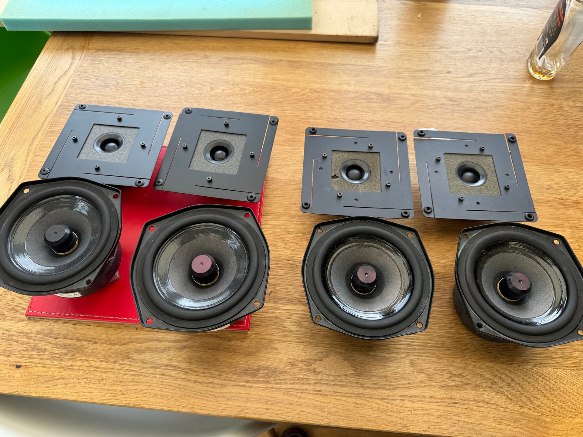

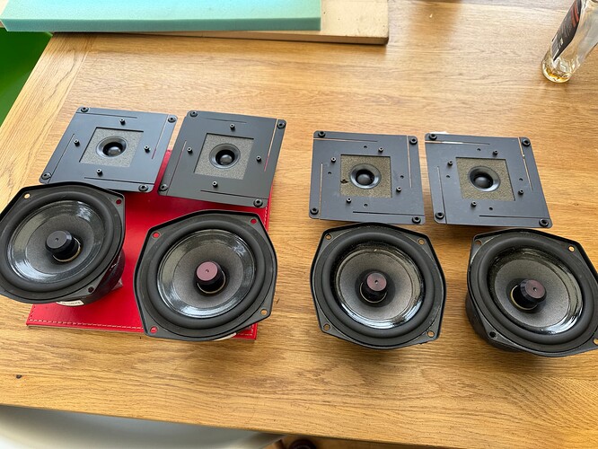

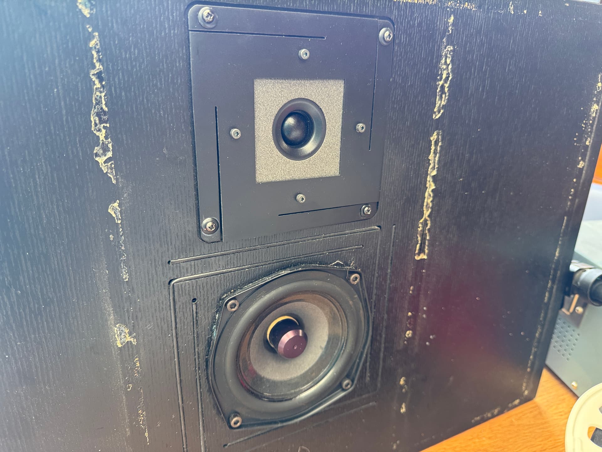

So today I replaced the mids and tweeters for those out of one of my NBL pairs.
My nbl trebles are only a few years old so I was expecting a nice uplift and was not disappointed. The mids are identical to the NBLs, including the printed name on the back of the cone.
Of note on my pair of mids at least no damping material on the back, I wonder if other users know if theirs do or do not. To be fair the mids sound awesome anyway but I swapped them out working on the assumption my 2003 nbls will be newer than these by probably a decade. This being said I am willing to bet all the mids in all the nbls/dbls are the same/similar age anyhow.

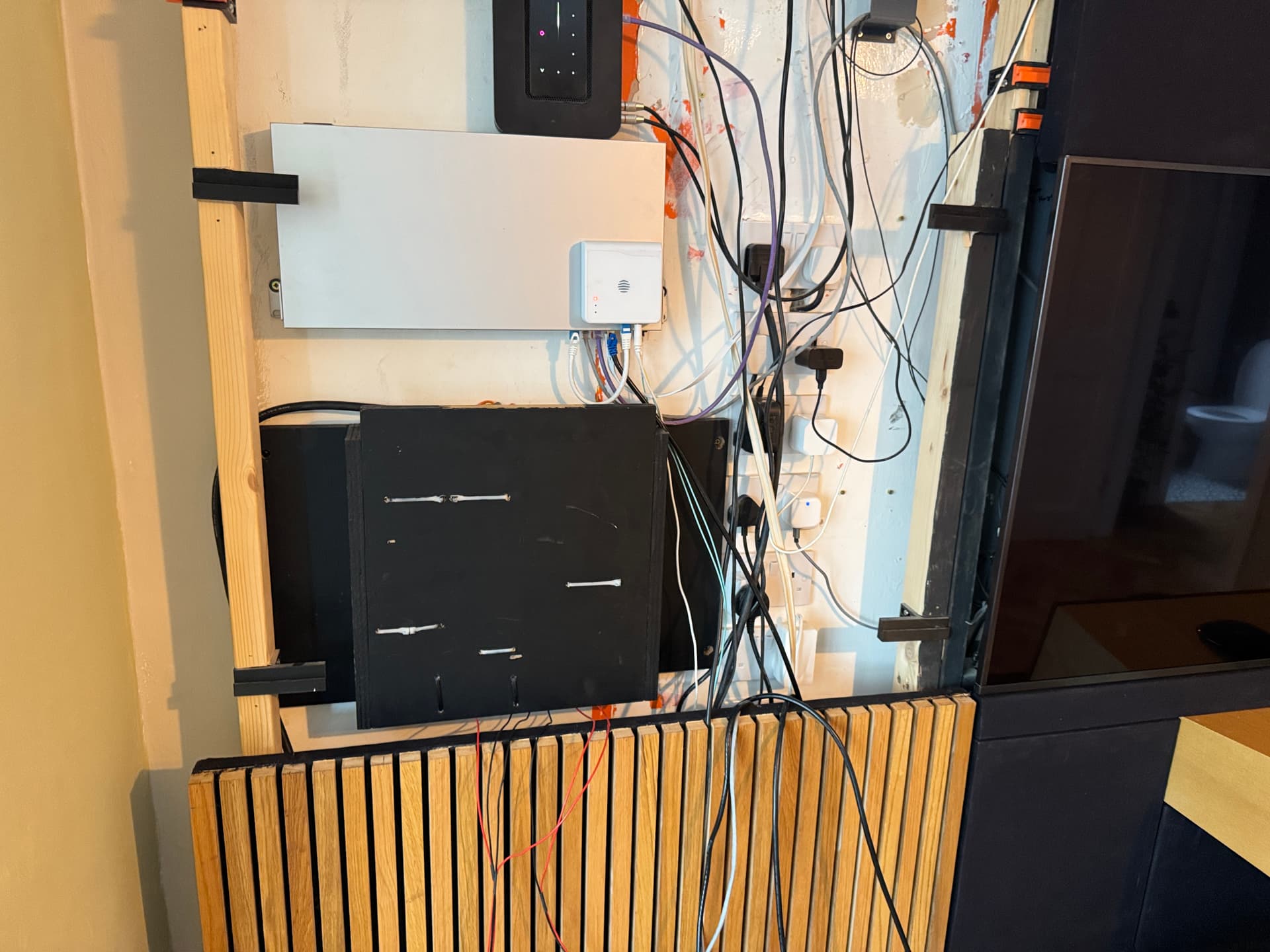

I also hid the cross overs behind the false wall there, very nice!

I’m enjoying my rebuilt SBLs as I type this. Your project is very interesting. Is that FN Acustico you are using for your “service” wall? How have you attached it?
No its hand made. Behind those strips are about a 10cm deep boxes, filled with rubber underlay and sound absorption panels. Each is attached with 3D printed parts for adjustment so are easily removed to reveal the total rats next of wires.

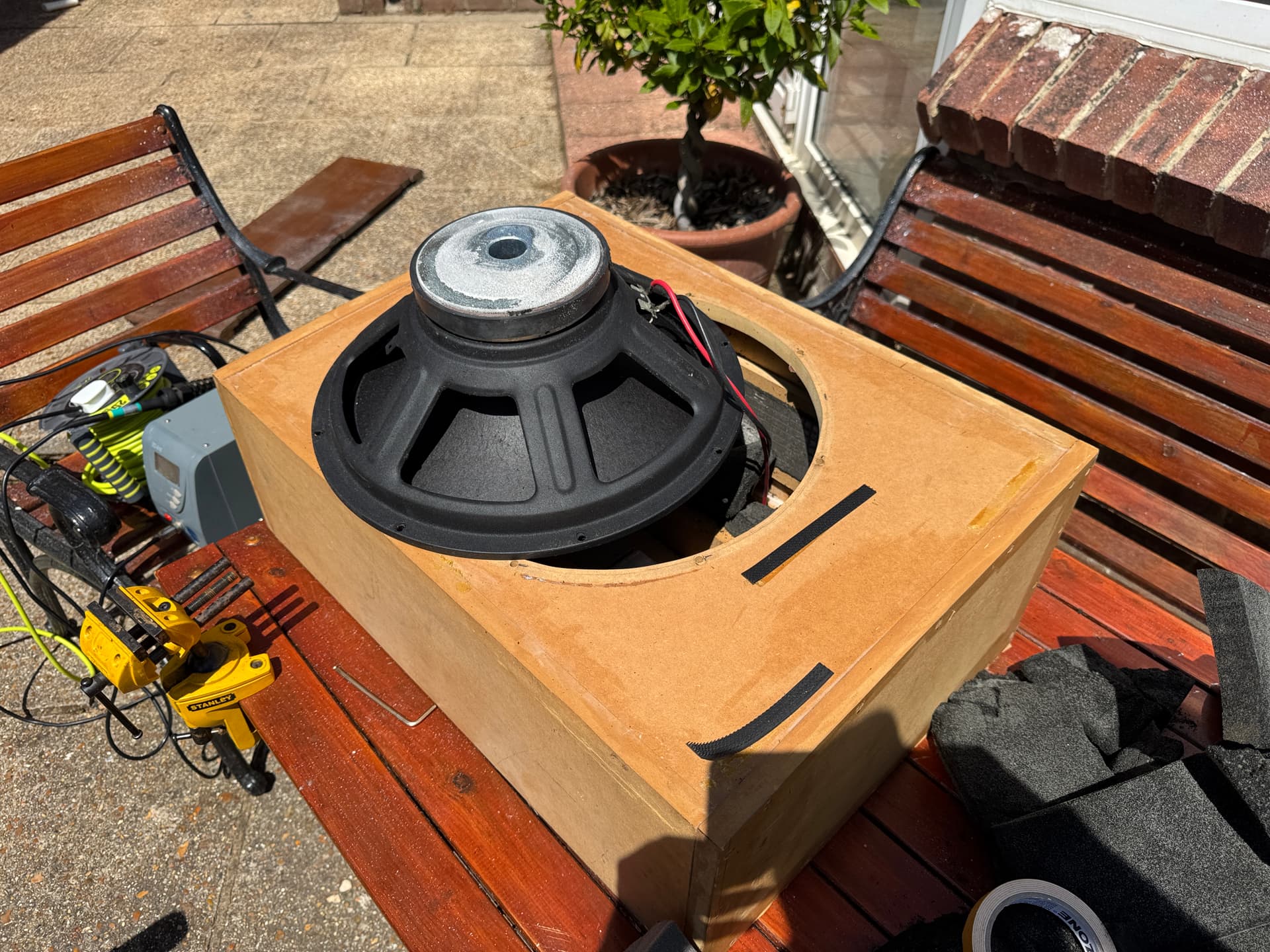

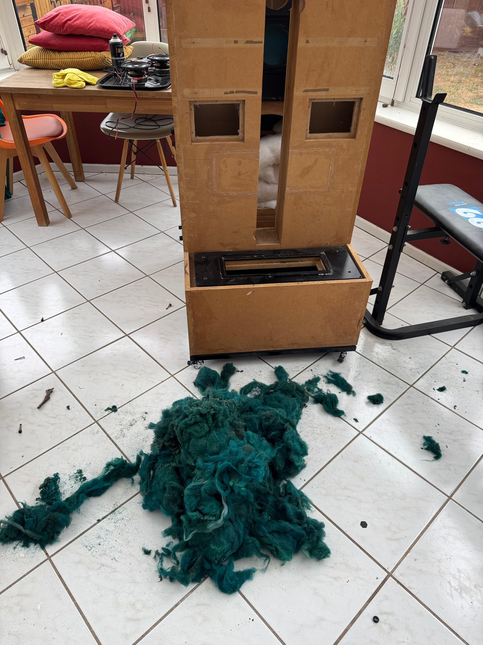

Does anyone know what the soft material in the bottom box would be called, it looks a bit like hair?
In one of the DBLs its what I would consider standard stuff like I have seen in SBLs etc, however in the other one, it looks a very strange green. I am guessing they were trying different materials I have no idea?
The colour not such an issue but the old foam from the chambers above has totally deteriorated into it and frankly its disgusting. I was expecting to see mouse poo in there!

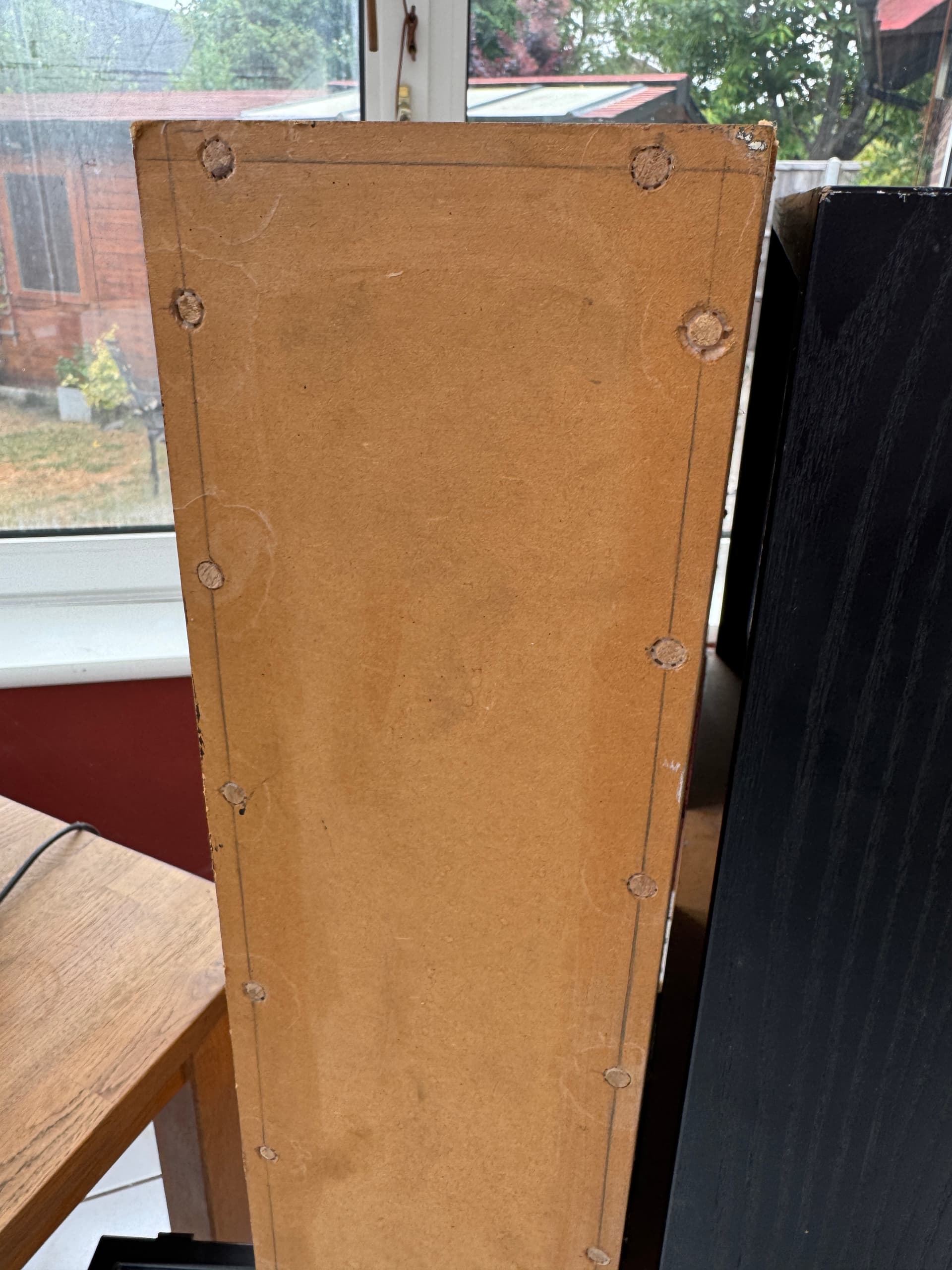

I think the cabs were probably made at naim, the black top box I would surmise is the final production part but the rest there is glued and screwed and this will all need to be dead flat.

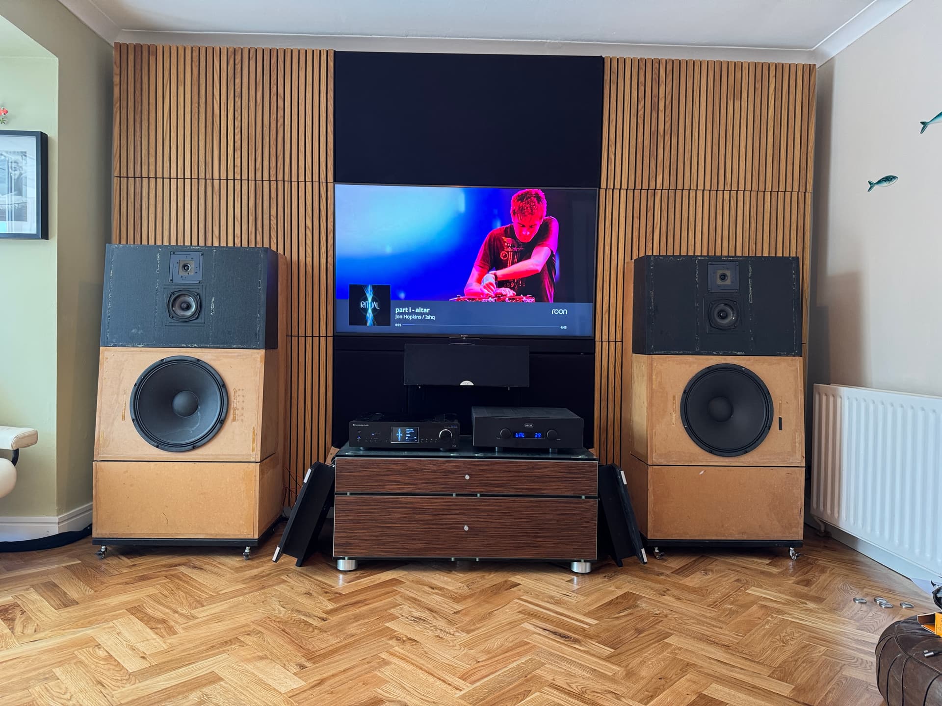

Also, music selection being shown on the TV. I love that album…
IIRC it was goat hair - same in the SBL and SL2, although I’ve never seen the green stuff before.
