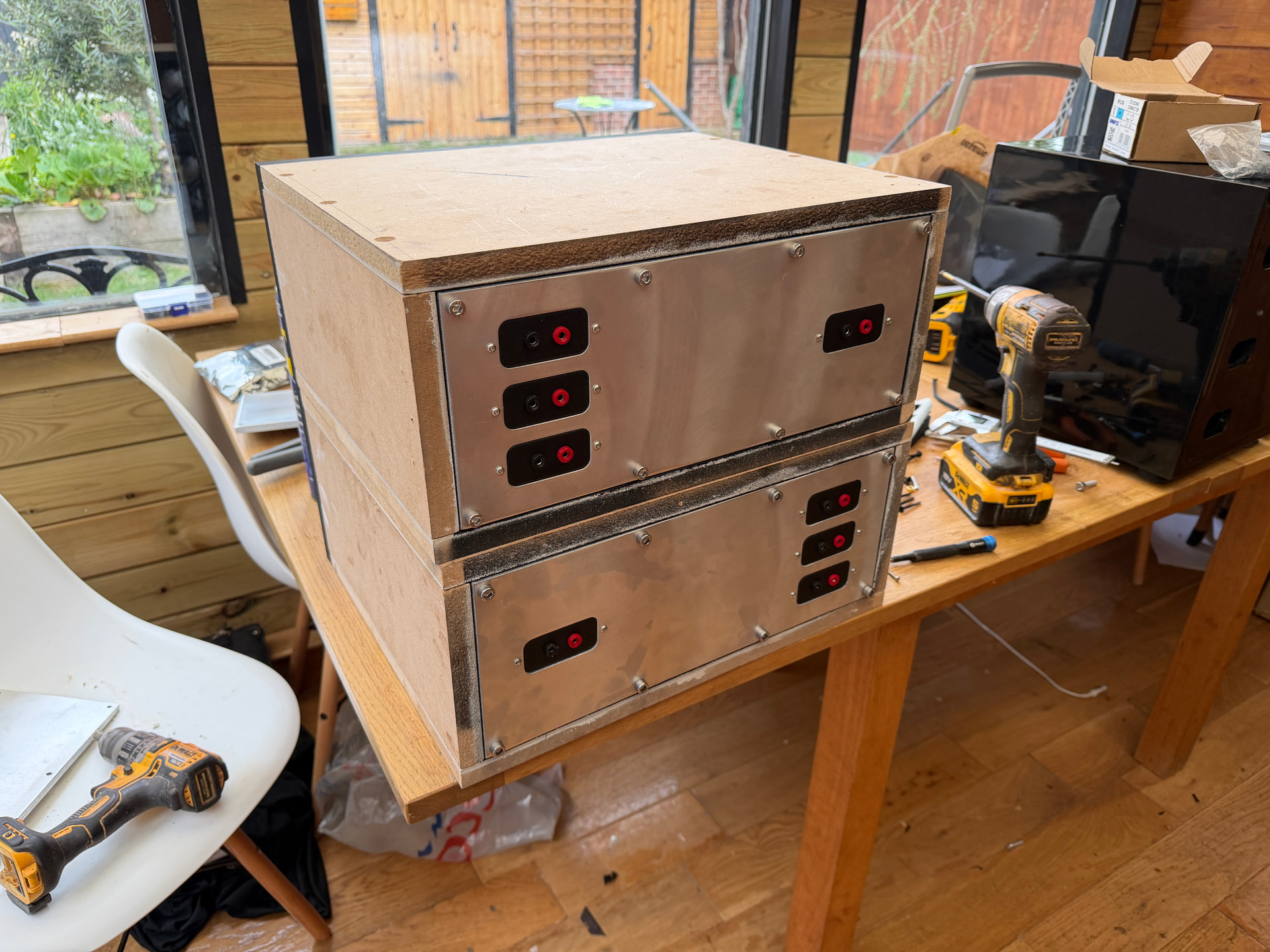

Further updates today. I am deep into experimentation with a new tweeter from Scanspeak. I am also reviewing the boxes for crossovers. This is mostly cosmetic and also I feel a bit too audiophile with cross over boxes sat next to the speakers, plus I prefer the speakers just a tadge closer together which I cannot do with the boxes in the way.

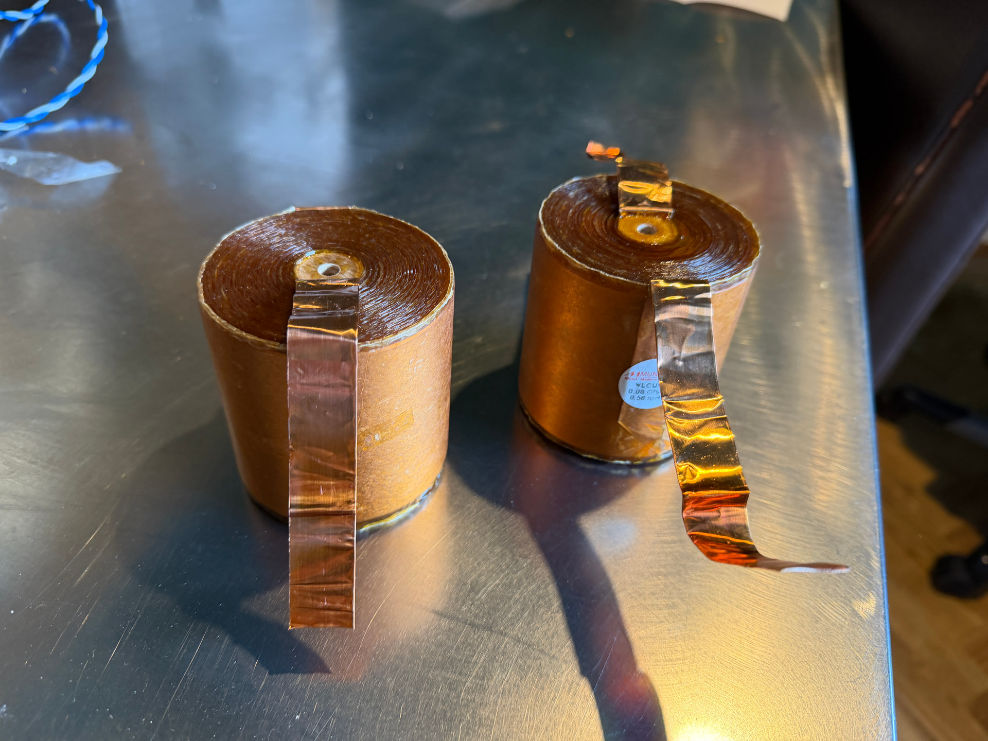

I also swapped out the final part that was old stock. I took some windings off a foil inductor in the mid to get to the right measurement, but something was niggling. In the end I got them remade by mundorf.
Anyone that says parts quality dont make a difference? Well let me tell you this cynic for one is converted. They weigh 2kg each, these box weights are getting out of control!

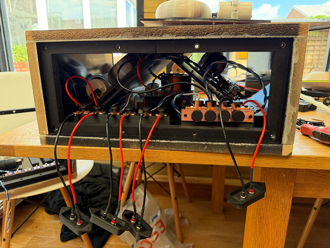

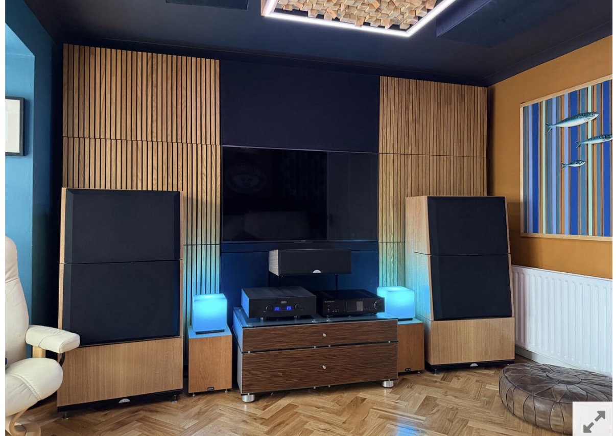

The plan is to eventually have the boxes live in the hifi cabinet. To that end I have changed orientation. Its all come together splendidly so far.

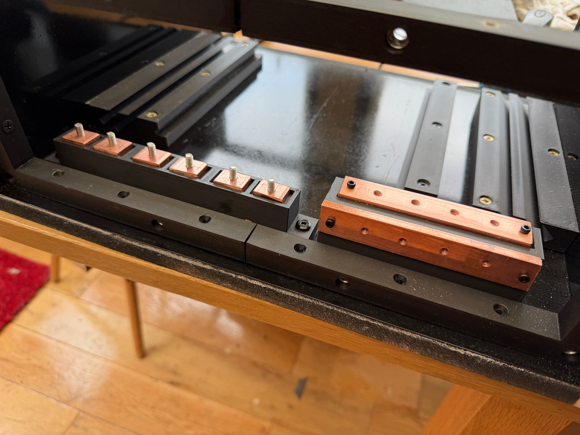

Here are the connection areas.
One day I will afford gold plating or something, but for now copper will do
Here it is with a 10mm aluminum back plate in place. Feeling smug this all came together, thank god for sketchup and 3D printing!
The front of the units is where the 3 cross over components slide in, I have 10mm aluminium being cut for that as well. Once I am happy every thing fits I will veneer the outside in Oak.

I look forward to seeing the finished boxes. What are the dimensions? They look huge - DBCs for DBLs!
Are you planning to use Naim right-angled speaker plugs? If so, won’t the cables clash, given that the sockets are arranged vertically?

As there are three sets of cable coming from the boxes I elected not to use naca5 and consequently whi8lst I am using naim plugs the cable is more flexible so they fit fine. If you look up a few posts you can see a picture of the current crossover boxes in black. They are circa 350mm tall 350mm deep and 260mm wide. They are quite large, and about 20kg each as well.
The new boxes are a bit smaller so they will go in the brown cabinet so are 20cm tall over all. This necessitated putting the bass and treble boards in at an angle as can just be seen above (Either that or a total redesign of boards which I was not in the mood for. This was all modelled in CAD so I could 3D prints angle supports for the boards. It worked first time, I love CAD!

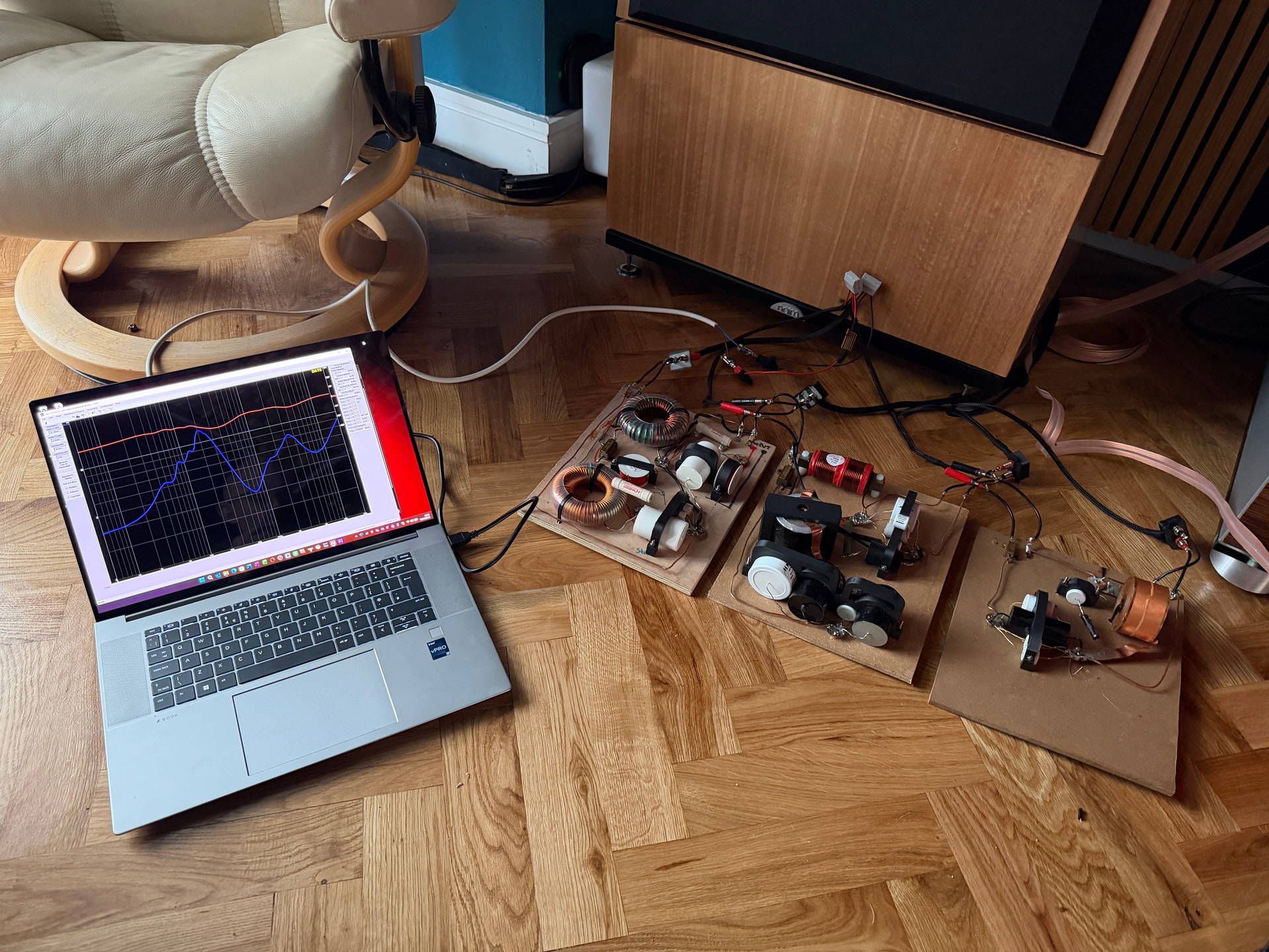

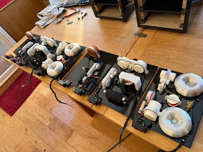

I guess its a matter of layout, mine are split by each channel then stacked:
I have not seen a dbl cross over, but have nbls, the components I have used are in the most part substantially bigger. The mid range inductor for instance 80mm tall.
Have you connected them up and tried them in the laid out flat arrangement? It would be interesting to compare with them stacked in their new boxes. But then what if…? Maybe not!

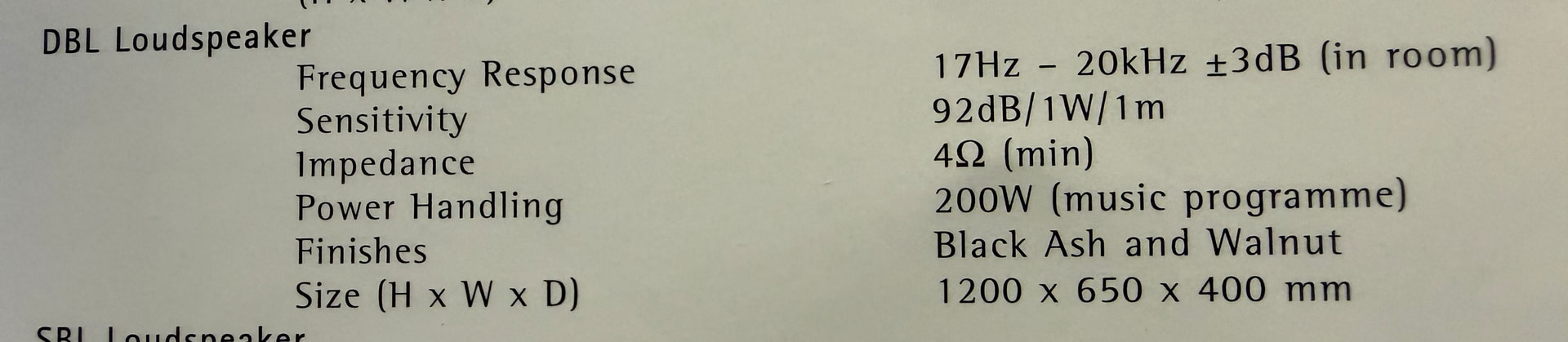

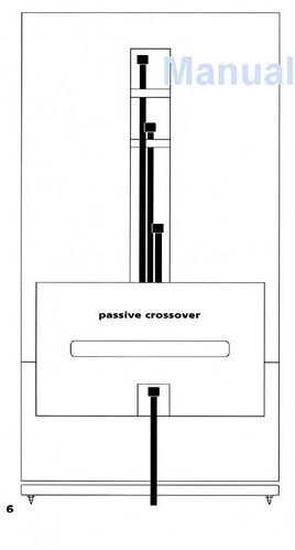

It’s the size of DBL speaker,just to compare..
original Naim DBL crossovers are on the back side of the speakers.
Ah, that makes sense. So what size are the NA official passive crossovers?
About 60 cm wide
They have been in all sorts of configs through testing lol
But practically speaking I have to imagine they are better away from the speaker, even more so when they are in the cabinet.
A beautiful description of what DBL’s can do when fed enough power.
I’m sure you’re right. It makes logical sense to isolate the crossovers from the drivers, and that must accord with Naim’s philosophy regarding mechanical isolation.
