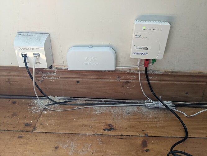

In terms of infrastructure, this shows the old (redundant) master socket on the left, then the fibre junction box, and then the modem which connects to the BT wifi hub via an Ethernet cable.
There’s a single cable comes in through the wall to the fibre junction box.

Yep, the box on the right is the ONT… it does the clever stuff with PON connectivity … PON one side, typically twisted pair Ethernet the other side connected to your router (hub etc). Think of the ONT like your previous xDSL modem… but it is actually quite different from a modem, it’s a PON termination point, but I note consumer literature call it a ‘modem’… which might confuse some in due course :grinning:
Depending on your provider and what you requested your phone service could/has have been migrated to a new VoIP service via the phone socket on your new router (home hub)
