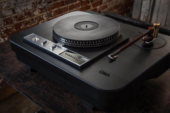

It’s impressive how many companies are restoring the Garrard 401. Some cost more than 20 k. Better be well acknowledged before buying.
I found the OMA Garrard 401 restored. The plinth weighs 100 lbs.
Must be very expensive, as the OMA rig oil turntable cost around 450k.
Picture from Mono and Stereo.
