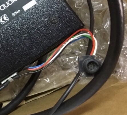

The connector looks like the one shown in this picture. It is secured to the armboard by 4 little screws. AFAIK, it was unique to the ARO so finding a replacement is not easy nowadays. I think Peter at Cymbiosis bought up a lot of the spare parts from naim so you could try him. Otherwise, I assume the Aro you have came with an armlead, so you could remove the connector from the armlead and fix it to the Prefix. However, your best bet is probably to just wait for a Prefix with an Aro connector to pop up for sale
Oops, the picture didn’t attach. I’ll try again…

That’s what I meant. This plug (rare and sad when lost) needs to be mounted to the prefix. Think it is the one pushed through the hole in the armboard from underneath? Is it?
