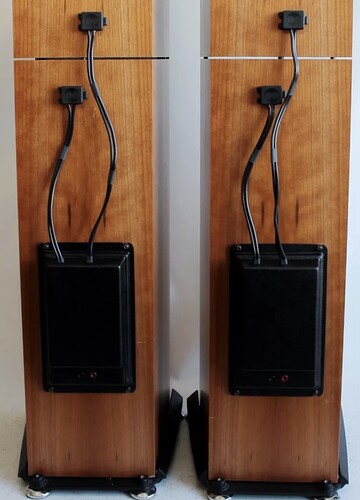

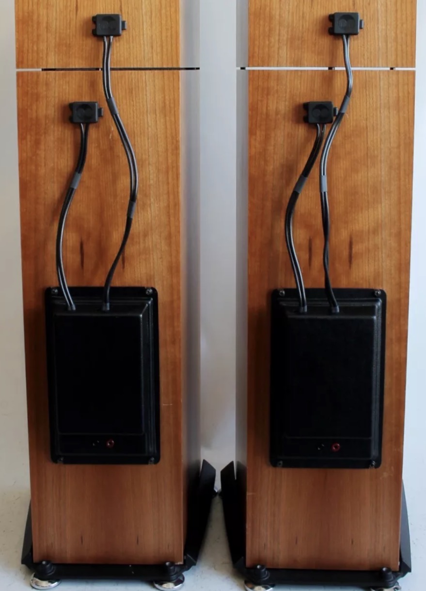

Can Allaes be run in an active config?

It will work very well in an Naim active system :+1:
The passive crossovers are easy to remove
