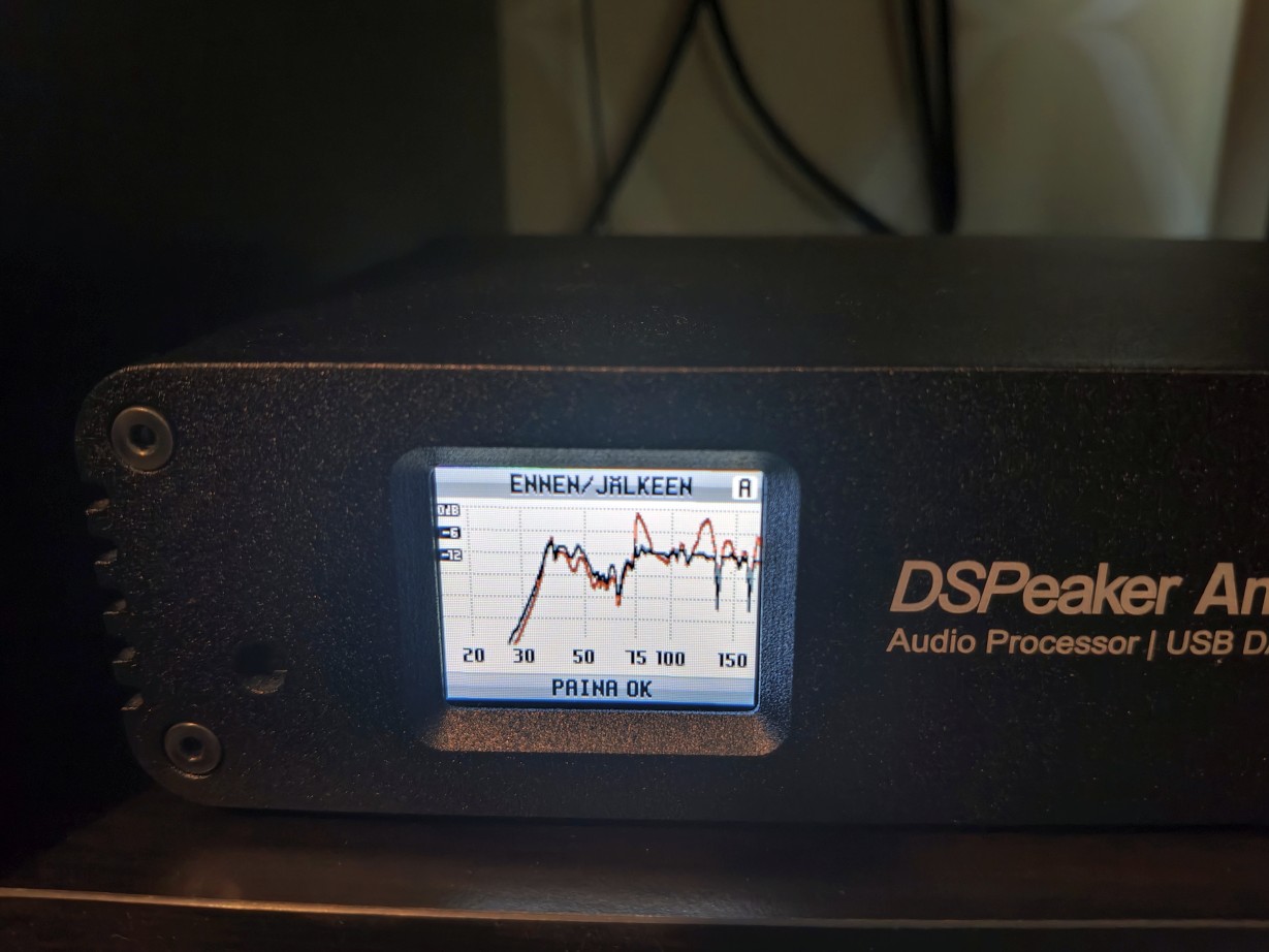

My room really is challenging, the floor, ceiling and three walls are concrete and it’s almost a perfect square at about 4,3x4,5m. I have some bass traps in the corners to reduce the boominess and a thick carpet and drapes and some acoustic diffusers to handle the first reflections. Here’s the results from the calibration with the Dspeaker, the red line is before calibration and black line is after:
I’m sure trying different speaker placements would also have helped a bit but like I said I am limited in where I can place them. Lyngdorf actually recommends that you place the speakers right up against the wall to reinforce the bass response which RoomPerfect then cleans up so you get better bass without any boominess or muddiness. It should also improve imaging, soundstage and mid-range clarity while preserving the speakers natural sound.
I am also considering other speakers like the Sonus faber Lumina III or Sonetto II G2, they are downward firing so they should be more forgiving of being placed close to the wall but after witnessing the kind of improvement even a basic room calibration did for the Genelecs I’m sure even they would greatly benefit from some form of it.
The Genelecs I have now are not bad, with the right kind of recording they actually are quite nice but often they sound somewhat dry and sterile and I would prefer a warmer and more lush sound.
