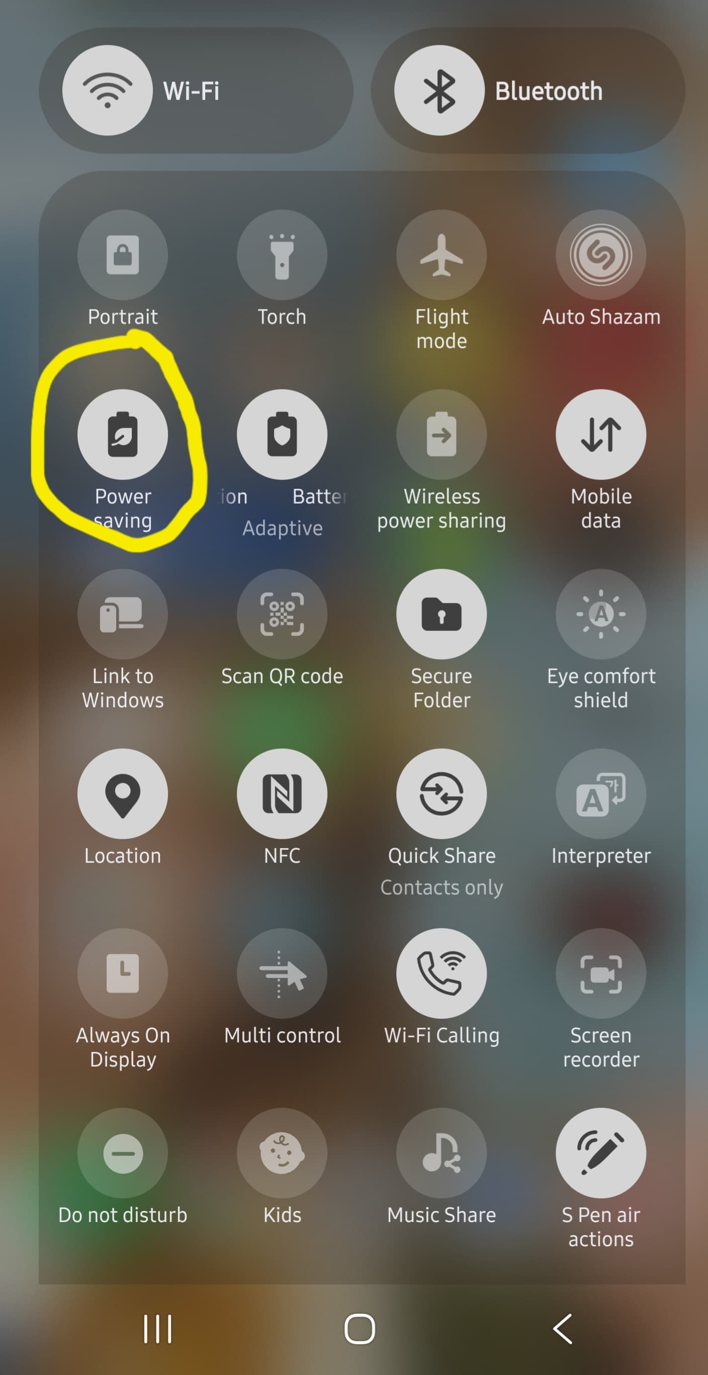

The issue is to do with the phone battery saving settings. Turn these on and the phone/app effectively logs you out of qobuz.
One workaround is to turn these off, or have to log out and back in each time to qobuz on the app.
Then after about 2 hours, the phone/app logs you out again. Rather frustrating.
Nice one that appears to be it, I have toggled through various of the settings and logged in out of Naim app but as soon as power saver is turned on it returns to the problem I noted at the start of this thread. With power saver off all seems good. I have also changed to dark mode in display which hasn’t impacted as yet.

The latest Android update to its OS brought this issue. I leave my battery saving off when at home, as this is the only wsy to make things work without having to keeping logging in and out of my qobuz account.
