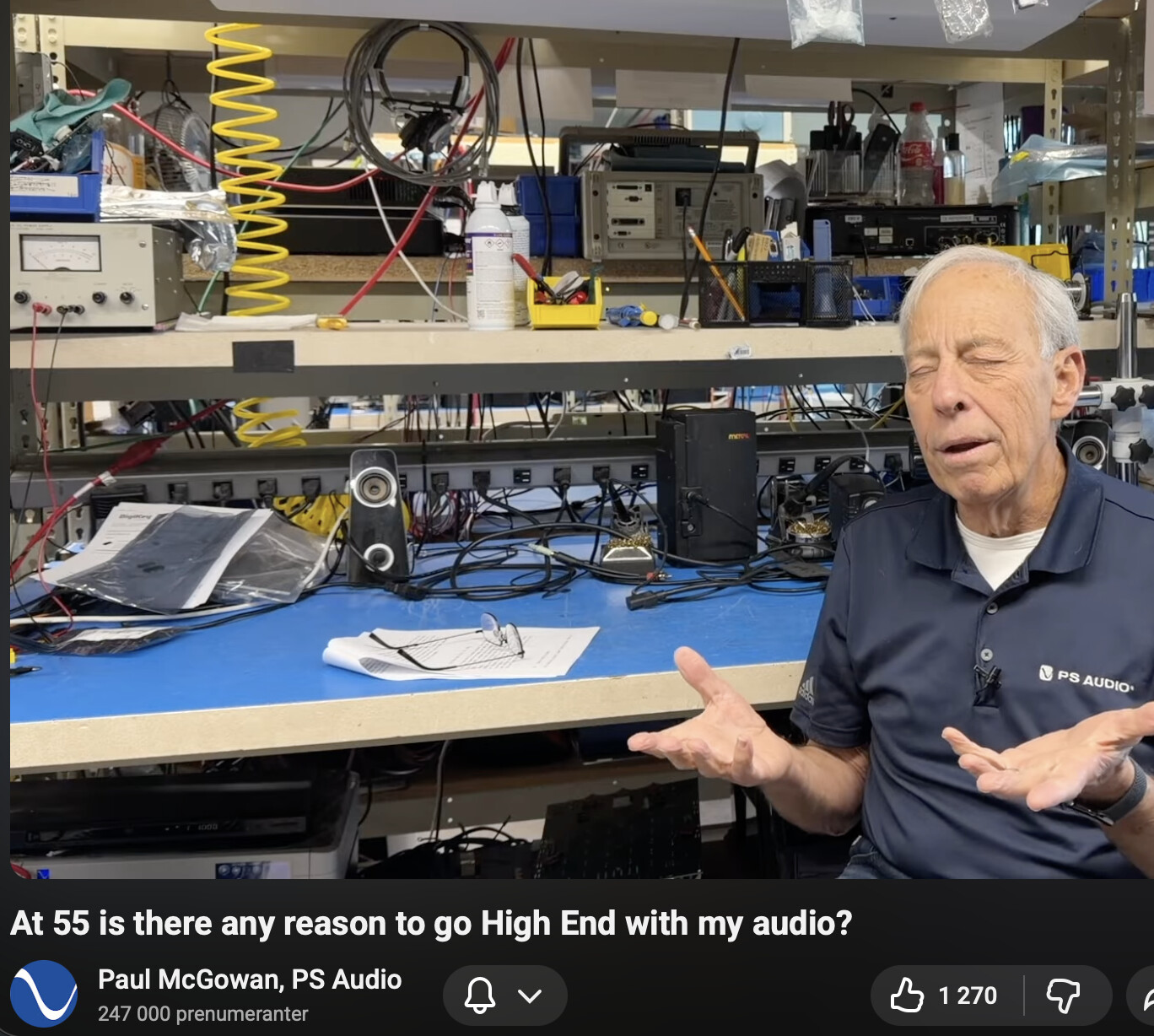

For inspiration :saxophone:
That was an interesting video thanks. He doesn’t cover hearing aids as such, other than saying a lot of his customers use them. The thing that always amazes me is the level of the new technology and the amount of compensation the brain makes - the difference the brain adjusts when using aids is quite extraordinary, way beyond faffing around with system changes.
