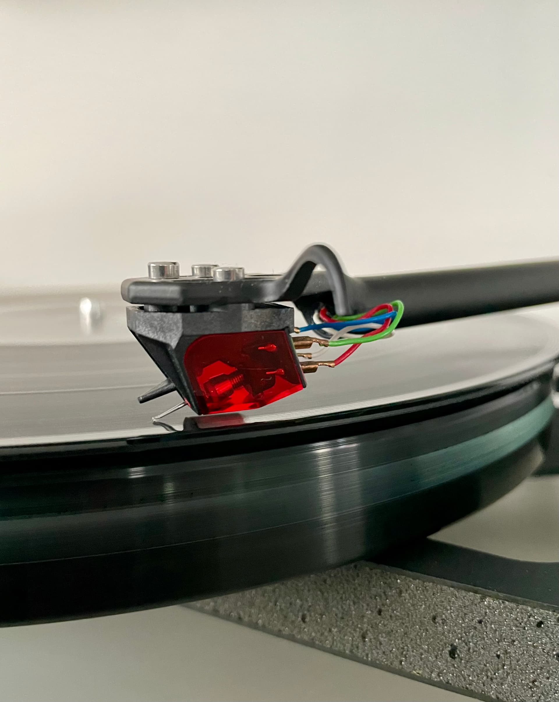

Help, I destroyed my Rega cartridge

You can have the Ania rebuilt by Soundsmith in NY (USA). I did the same thing to my Ania Pro. Soundsmith upgraded cantilever & stylus and it sounds great. The retipping service will not work in your case. I upgraded to a Boron cantilever with a clear line stylus, outstanding upgrade!!
Check out their website here; retipper@sound-smith.com
Good luck :+1:
Do they really, really completely replace the cantilever, or do they slip one on over a stub of the old cantilever. There are other “retippers” who do exactly that and it changes the cartridge. Whether it’s for the better or worse, one has to decide, but doesn’t seem like a good thing to me.
I had my Dv XV-1s sent back to japan for an official rebuild. I would do the same with my two Lyra cartrigges.
In the case of my Koetsu, that was something a dealer threw away and I rescued from their trash bin. It still had the stylus stuck to the cantilever, but pushed through and barely hanging on by the glue. Jospeh Long (the groovetickler) said he could reattach it to the cantilever for $200, so that’s what I’m doing. It was free otherwise.
There are not many cartridge rebuilders in the states, however Peter Lederman (Sound-Smith.com) has over 50 years in cartridge rebuilding and design.
His cartridges are well known all over the world. He has a couple dedicated retippers working with him, however it is a small business in New York. They will give you an honest appraisal when you send in your cartridge and no, they do not glue cantilever’s over top a broken/misaligned stylus. For the boron/CL upgrade on a Rega Ania Pro it will cost 485.00, or there abouts. Not cheap, but half the price of a new one. You do have options, much cheaper than buying another new cartridge. Cheers!!
