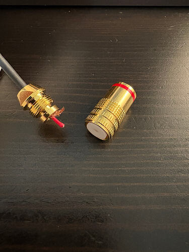

HELP... My interconnect disintegrated!

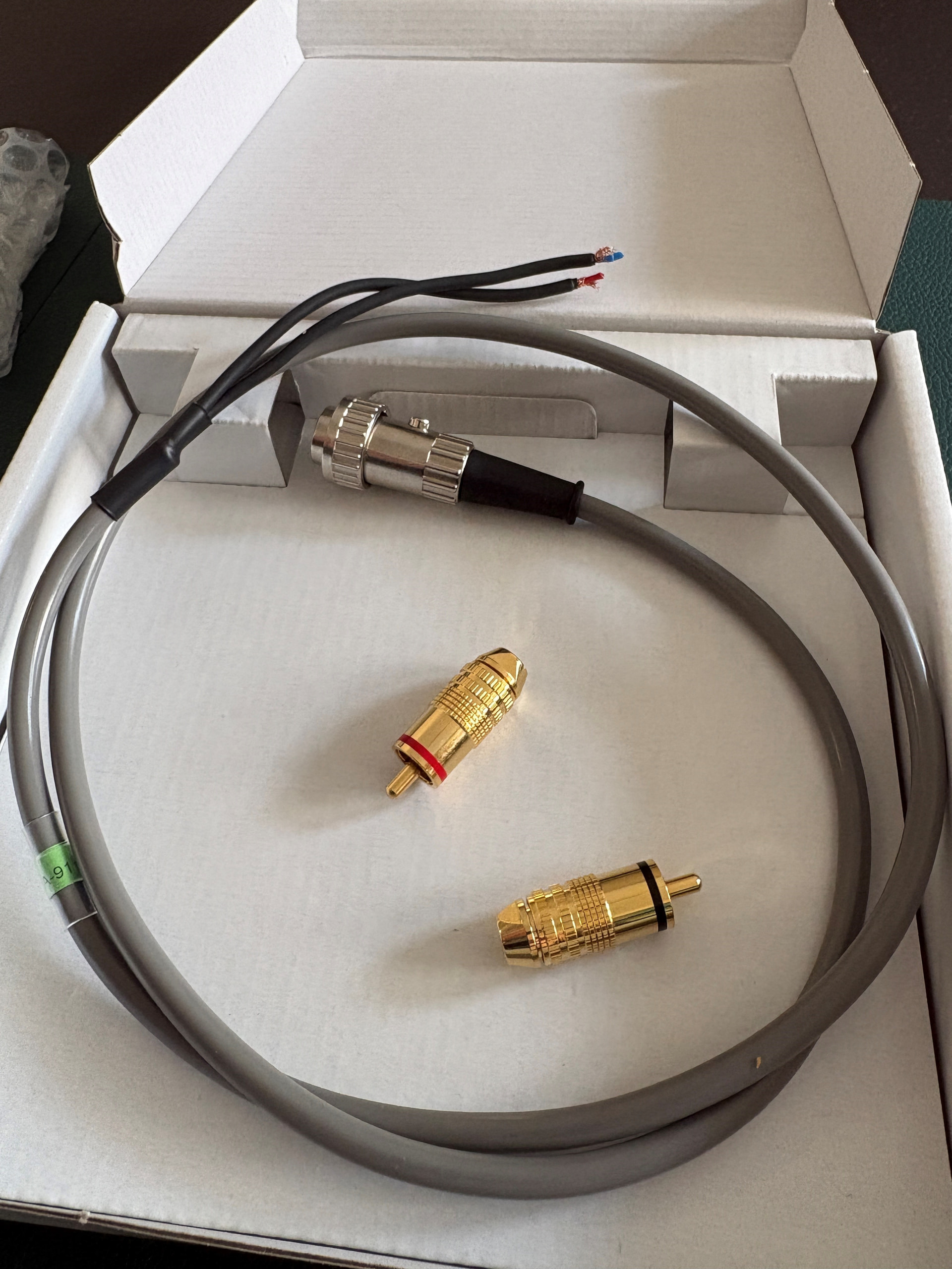

I recently bought a second-hand Lavender RCA-DIN interconnect to connect the DAC to the NAIT and replace a cheap RCA cable used previously. Upon installing it, the sound became more flat and with less bass. When my friend tried to disconnect the cable and try the old one again, the two RCA plugs practically fell off… :open_mouth:
I don’t believe that the cable had been abused so much to disintegrate like that. So I would expect that it can be repaired under warranty. It’s a bit over one year old, so still within the 2-year warranty period (which I understand is transferable within UK). The seller was kind to share the original invoice with me. Unfortunately I live in Belgium, so the logistics might get tricky.

Looks like the cable was cut/severed as no strands evident. Did he pull the plug or the cable when disconnecting? There also seems to be a cut in the lavender sheathing too.
AFAIK it’s pretty much unheard of for both plugs to come away together unless somebody pulled on the tails to remove the plugs at some point and likely weakened them - possibly the original owner? That also may also account for the lacklustre sound you experienced.

Easy fix to resolder the plugs, if you can handle a solder iron.
If you push the cable into the Rca plug, is it a snug fit or is it loose.
It should be snug, so the collet in the plug grips the cable.
A good dealer (not all Naim dealers know how to use a soldering iron!!) or competent service agent should be able to re-solder the plugs. It’s a simple job for the right person. If you can get a repair done under warranty, that’s great, but for such a basic soldering task anyone competent with a soldering iron should be able to fix it.

Indeed it seems that the cable has been pulled hard in the past, or potentially damaged when tinkering with the RCA plugs. Although I have soldered some banana plugs in the past, I don’t think I could do this one properly.

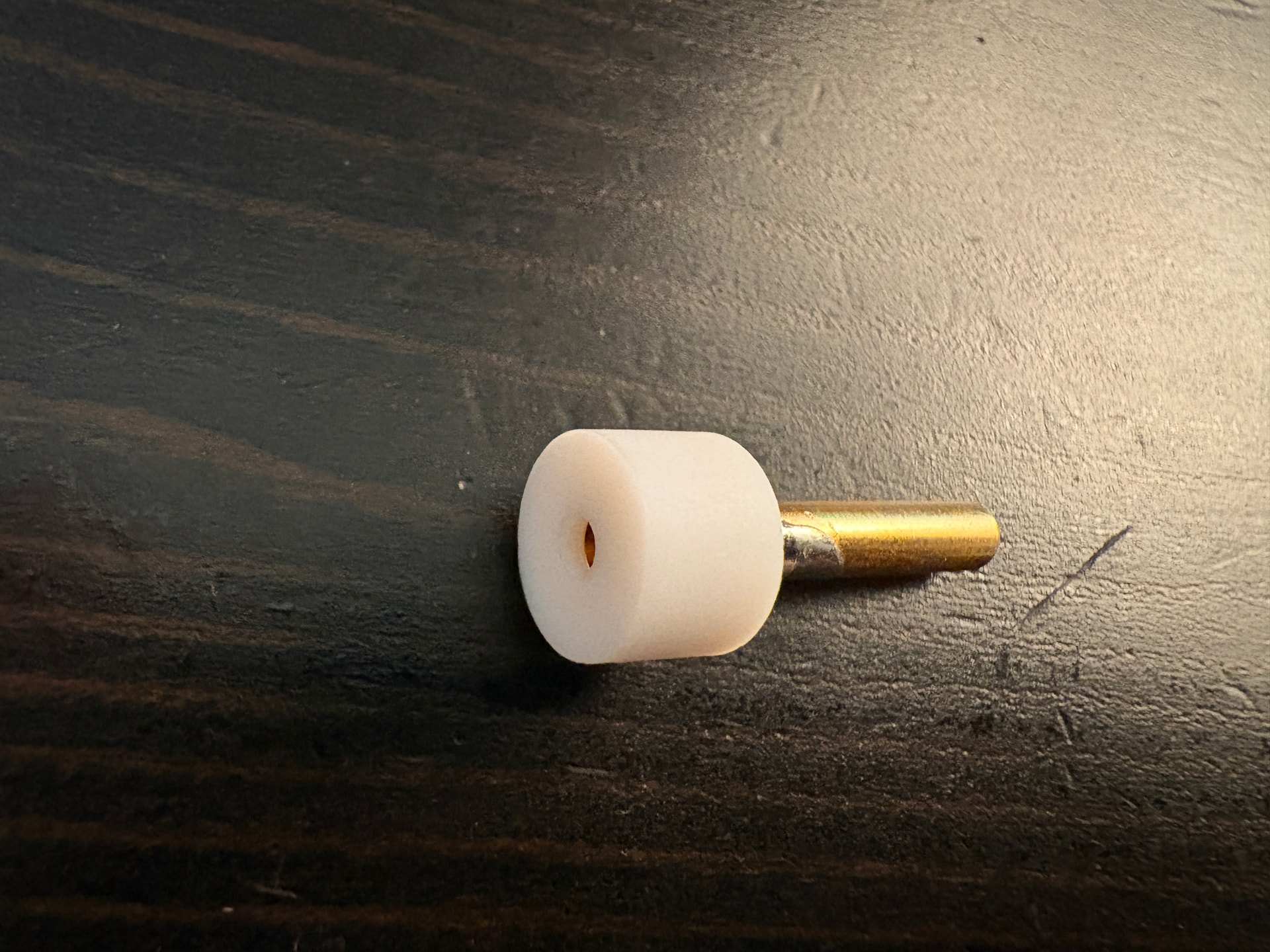

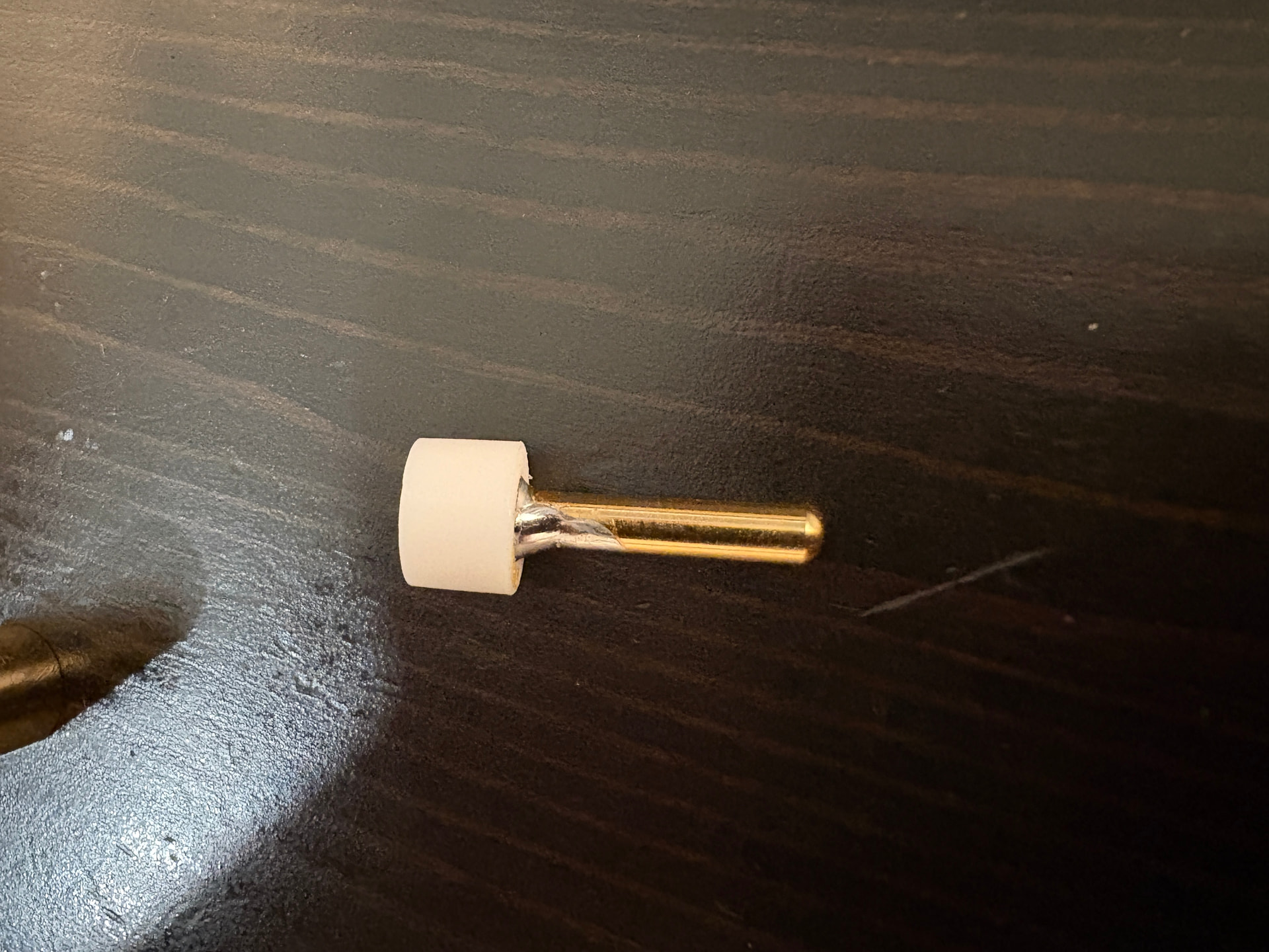

Each signal cable needs to go through the orifice in the center of the plastic part…
And then soldered on the other side…

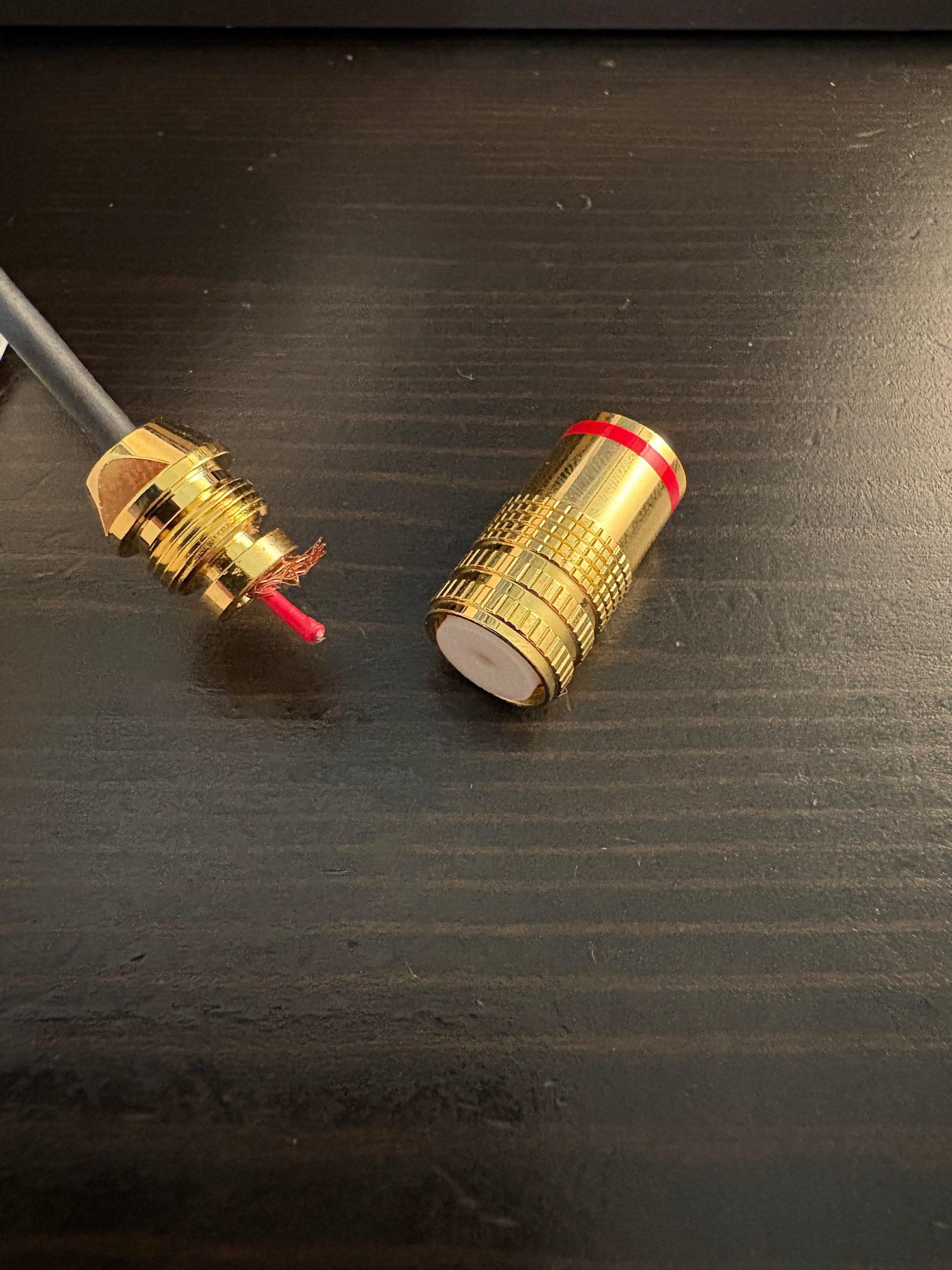

The negative side is not soldered, but squeezed tight between the plastic face and a metal part of the plug when you screw the RCA pieces together. Then the cable stays in place and I suppose that’s why it seemed OK when I received it…
Obviously in this configuration the signal cable barely makes any contact with the plug and that’s why the sound quality was subpar…
Really frustrating to fall victim of such unscrupulous seller. I don’t think the solders could break during shipping, no matter how hard the box was treated…
I need to figure out my options now. First to see how much a dealer or Latham Audio would charge for repairing this. And obviously notifying the seller that this is not acceptable…

Possibly started life as DIN-DIN and someone DIYed it to DIN-RCA who didn’t know what they were doing.
