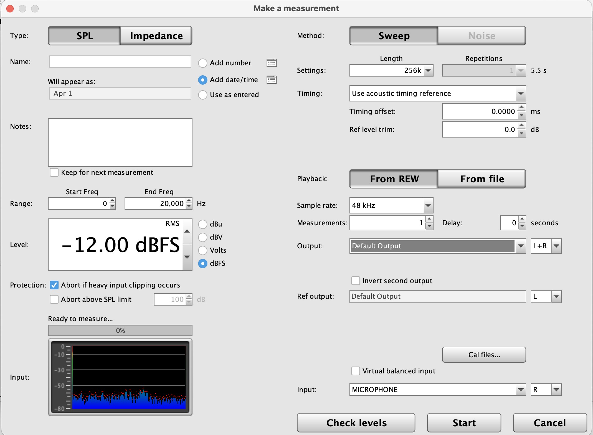

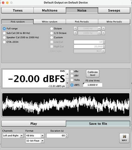

I just bought the MiniDSP Umik 1 microphone and want to measure my room. The wizard of REW assumes I have the speakers connected to my laptop which I haven’t. I want to create a file to USB but I am not sure which settings I should choose and which volume to choose on my set.
I saw post this post from @Simon-in-Suffolk but need some help with making sure I create a correct file and follow the correct steps.

However I think I created the noise file as you have above - save to file - you look to have the correct screen above, although perhaps format to 48khz 24 bit if it is there. Also I would go for white noise random - you could optimise later by putting the limits of your preferred speaker response.
The mount that file on a USB drive or other - plug into your streamer and get your streamer to play that usb file. Probably best to make the file duration a few minutes to make things easier.
That way your streamer is playing the sound file from the USB memory stick you have just created
Thanks Simon! Should I set channels to “left and right” or create 2 files for measuring each speaker separately?

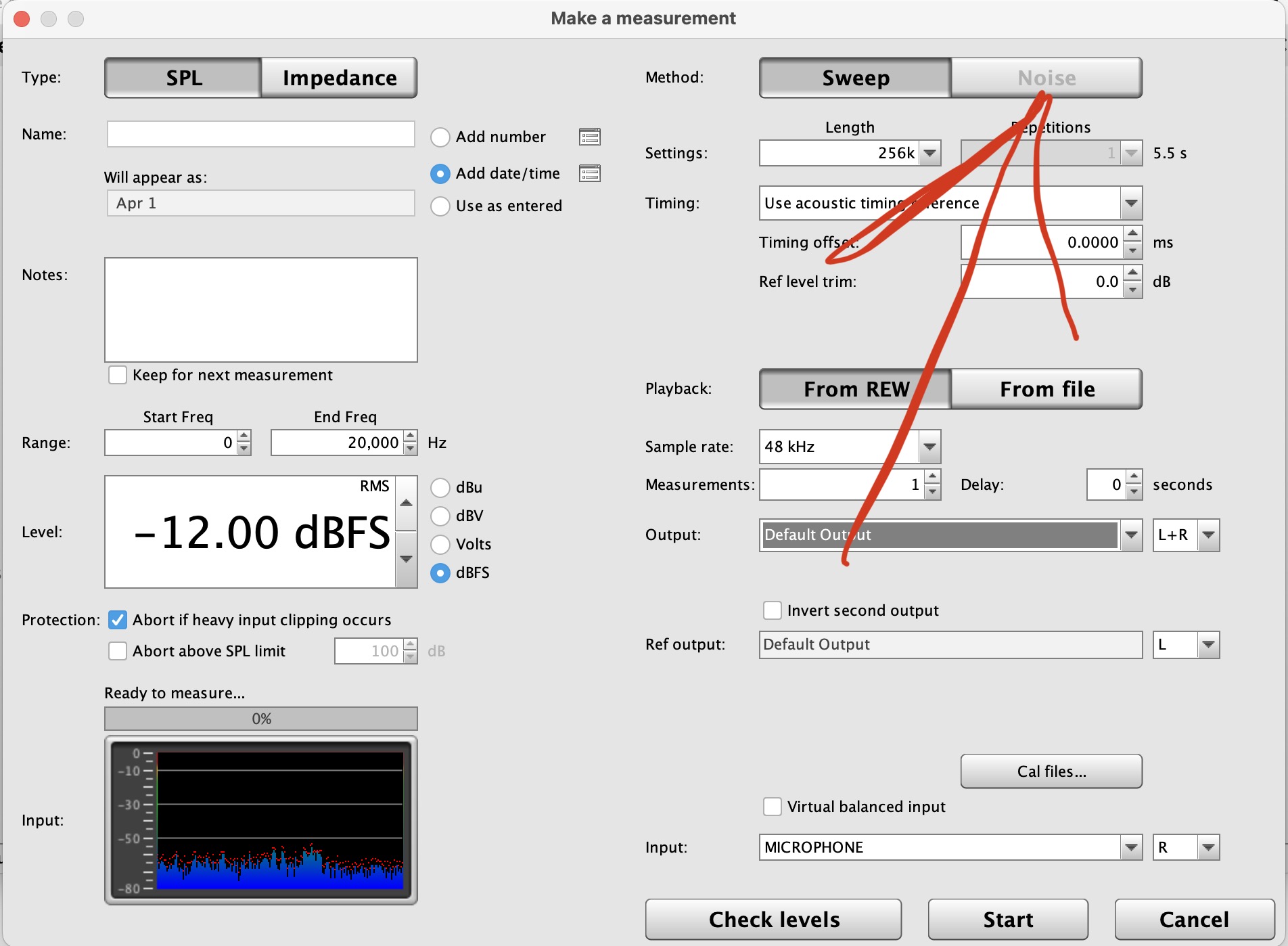

When I want to take a measurement the “noise method” is greyed out.
the noise method is for creating the source file -
to make your measurement don’t you want to hit start- and press from file… but the actual source will be your streamer playing the file -
sorry not sure I fully follow
When I want to import the file I created earlier it says it is incorrect. I suspect because the file is noise while the setting for measurement is set at sweep. I can’t click noise though cause it is greyed out.
Maybe I should create a sweep file instead of noise file?

  1. I generated the white noise file and saved it to a USB stick
  2. I put this stick already in my streamer and it can play the file so that part is covered.

  4. When I go to measure button in REW I get the screen as shown in post 12.
  5. I want to choose “Noise” as the method since that is the file I created and is playing. However I can’t choose this option.
If I just press start it plays the “Sweep sound” (which I understand I mute on the computer) but REW should measure the Noise sound that is playing through the streamer and not a Sweep sound. So I want to set REW to measure Noise and not measure Sweep.

What I did now is:
  1. I generated a Sweep file and saved it to a USB stick (if I want to measure Noise files apparently I need to use the RTA function instead of “measure function”
  2. I put this stick in my streamer
  3. Go to the measure icon in REW (screenshot above), choose from file as playback and pick the generated file
  4. Press start on a muted laptop
  5. Start streaming the file from USB on my naim streamer and let it run
  6. It finished and shows me a graph
Is that the correct procedure @Simon-in-Suffolk ?
Apparently this is not as accurate as playing from a USB file. Playing from a USB file is not the issue as my streamer perfectly reads the files I created and copied to a USB stick.
