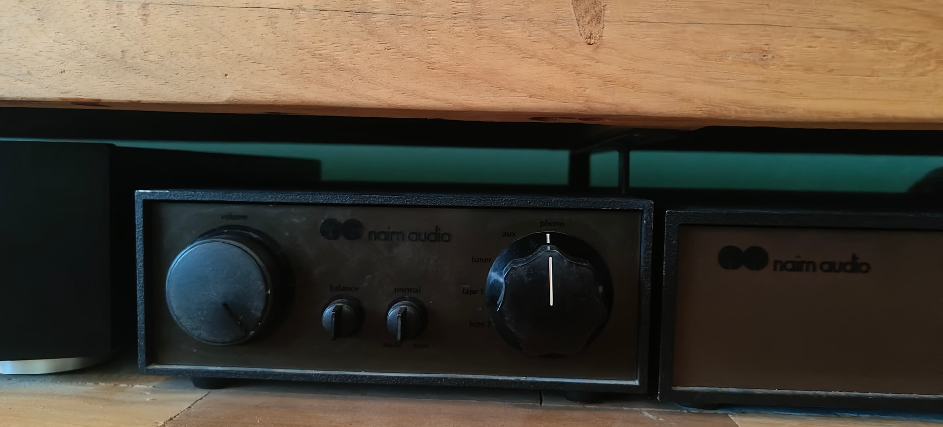

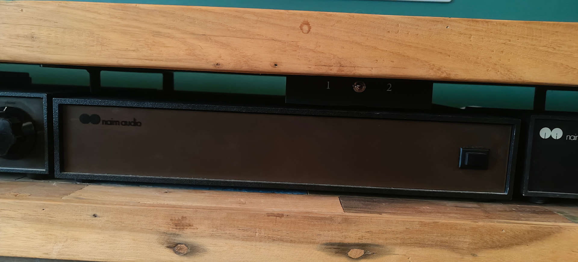

  1. Each component has a different look, and I’d like your help figuring out which era they belong to: the NAP 180 seems to be from the Olive series, while the SNAPS clearly looks older, but the casing doesn’t have a chrome trim strip on the front panel (though it does have one on the back panel) — could the casing have been disassembled and reassembled upside down/backwards?

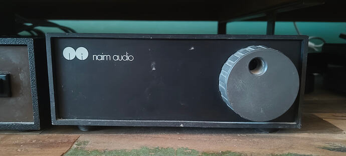

The NAC 72 is black in color, but has the NAIM logo backlit in green, like the NAP 180… I feel a bit lost in all this!

Getting to the system, the SNAPS is from the “Chrome Bumper” period and sounds as though it has had its sleeve reversed so the linished edge faces to the rear. It’s easy enough to turn it around, just be careful not to catch the fascia edge as they can get brittle with age.
The NAC72 and NAP180 are from the Olive period. The NAC72 appears to have had a non-standard replacement source selection knob fitted.
Sometimes a bit of a buzz at power up can indicate the need for a service. Power amp and power supply are usually the ones most in need due to the big reservoir caps.

Indeed ths Knob broke, and the store changed it with a non standard one as they didn’t have a Naim one back in the days, you catch it.
So the NAC is Olive even if the “front face” is black ? When comparing to the amplifier, the amp is slightly “ dark green/brown”
Naim olives are not all the same exact colour. Some are more grey and some are more green.
If at some point you want to improve things, an olive Hicap is much better than the snaps. It will give a dual rail power supply to the 72, getting the best from it. It will also match visually.
