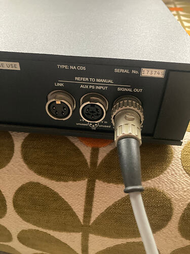

Afternoon to you all. I have picked up a naim CD 5. The unit appears to spin up fine, moves back and forth through tracks, but no output on the 5 pin to RCA. Seller said it had worked previously but had stopped, also said he’d tested the drive on soak and it works with a couple of errors. I’ve tested connecting through a Soho’s port, the port detects the device but no audio. Likely to be a laser replacement needed? Any advice appreciated.
Is the link plug fitted to the upgrade socket at the back? Without that the analogue output stage won’t get power so no output.
Thank you for quick reply Richard. No link plug on there. So a case of getting one of those ordered.
Yup, that’s your issue - Phew!
Thank you richard. Have ordered one. All the best.
It worked! Thank you Richard really appreciate it.
