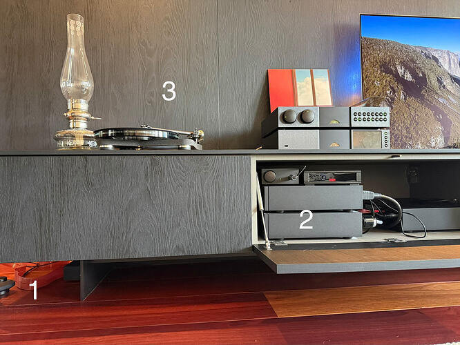

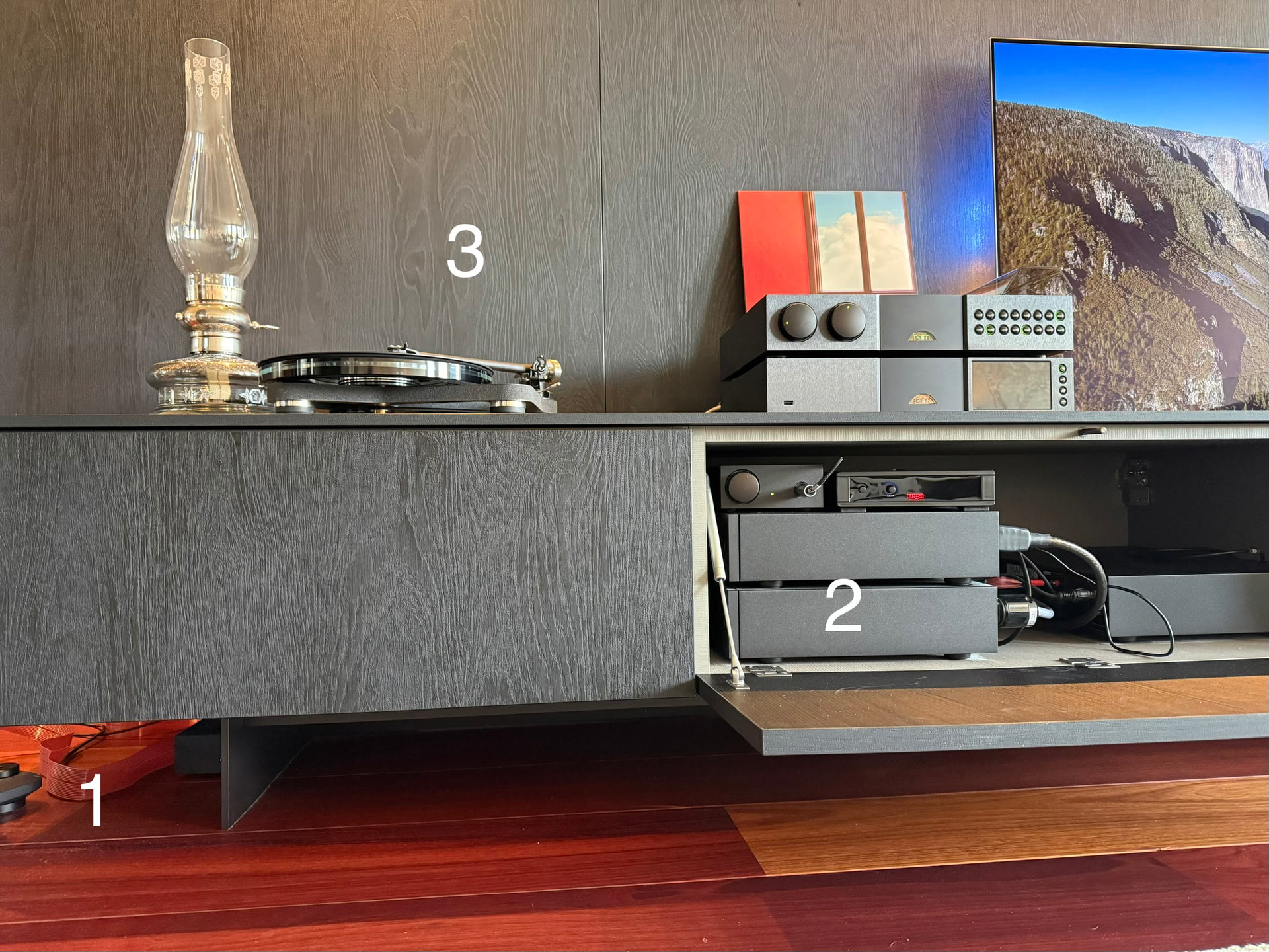

I have set up my gear as follows:
  1. Moved the Stageline onto the floor, well away from any power supplies or transformers. Only the speaker cables run near it.
  2. The Rega deck about ~30 cm away from the 252 and NDX.
  3. Placed all power supplies (XPS, SuperCap, Rega PSU, power amp) inside a cupboard “far” away and is normally closed.
The hum is still there, although a bit softer.
I also experimented with cable dressing (Rega PSU cable away from the RCA leads), but it didn’t change anything. Checked underneath the Rega and I can’t find any earth cable, which I understand is normal for Rega.
Any other ideas on what could cause the hum, or what I should try next?
Thanks in advance.
Hi, I would take the Neo power supply off whatever it is standing on and put it on the floor as well as the Stageline, but not near it.
Did you try this?
I have moved it around, which limitation of the cables. Did not seem to help
