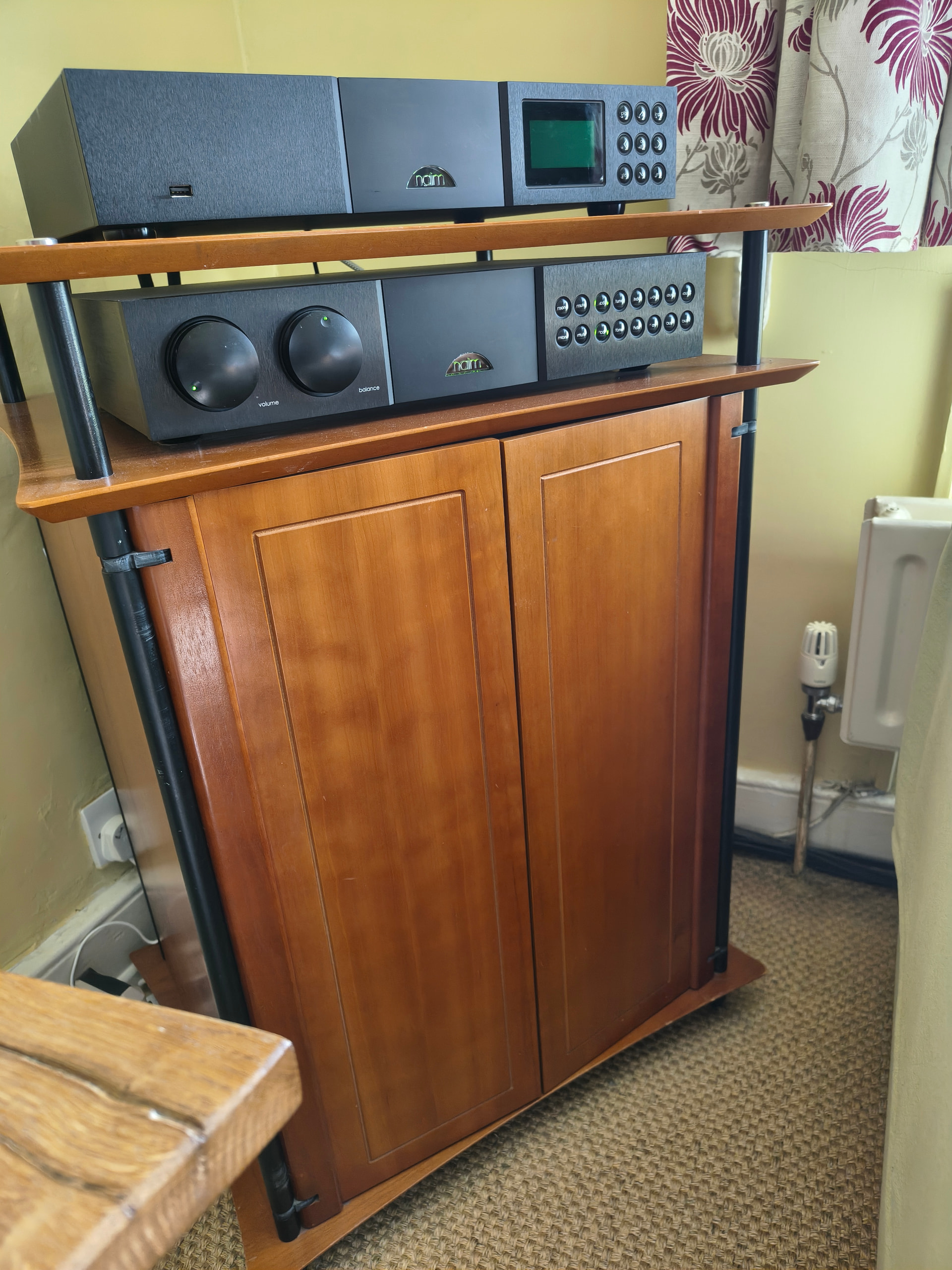

As an aside it amazes me that I cannot find anyone who still does a rack like my old Quadraspire which has covering doors. Makes it rather more attractive and less ‘HiFi’ in a living room in my view. Note the back is open and heat isn’t an issue.
I was hoping to buy another level, and perhaps a 2nd unit for my 2nd system but it seems it was discontinued aeons ago.
Are the shelves at the top not just the same as current stock? If different it may be worth speaking to Quadraspire. They may just have some old stock floating around - you never know your luck. I’ve found them to be a very helpful company.
I see what you mean but what I really want is a taller enclosed section ie more levels behind a door. I prefer to keep most of the boxes out of sight.
