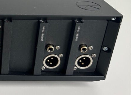

What’s in my head is this -
Use a phono lead from each of the mono DACs in the Linn- (the XLR outputs go to my pair of 350 monoblocks)
and plug the other end into the Atom HE input where the wavy line is-
Is that right?
That should indeed work, but I do think the volume will be controlled by the Selekt … so you would have two volume controls in series.
By using the digital out (SPDIF) of the Linn you won’t have this issue. This would be a neater solution IMHO
Yes, so a regular stereo DIN cable should do it as long as the split on the end of the cable allows it to reach both sockets on the Linn.
Does the Linn analogue out have a fixed volume option? If so you could try it, but my experience of using non-Naim DACs (not Linn) has been that dialling down the output level, then using the Naim volume control, has given better performance, but that’s using different equipment to yours.
Whether the SPDIF out would be any better, I think you’ll just have to try it and see. The fancy Linn DAC will no doubt change the character of the sound even though the signal would then pass through the Atom DAC too. Only one way to find out what you prefer!

If you go the spdif route will need to use spdif port 1 and you may need to reconfigure it from input (default) to output. You can do this in the Linn app. This also bypasses the DSM’s DAC and volume control which should then be handled by the Atom.
