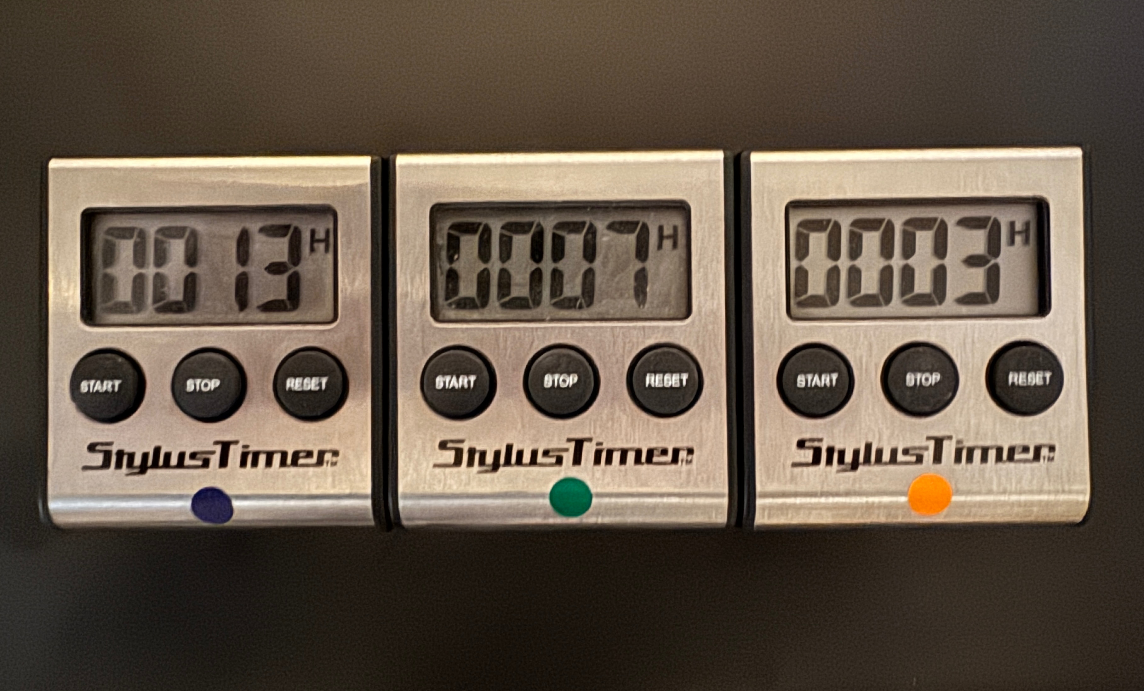

Also, I use these stylus timers, one for each cartridge I have mounted on tonearms. They help keep track of stylus use. Get them on a Amazon for about $25.
I don’t start/stop every record side. I start at beginning of a listening session and stop when I’m done (but stop and restart accordingly if I change tonearms).
