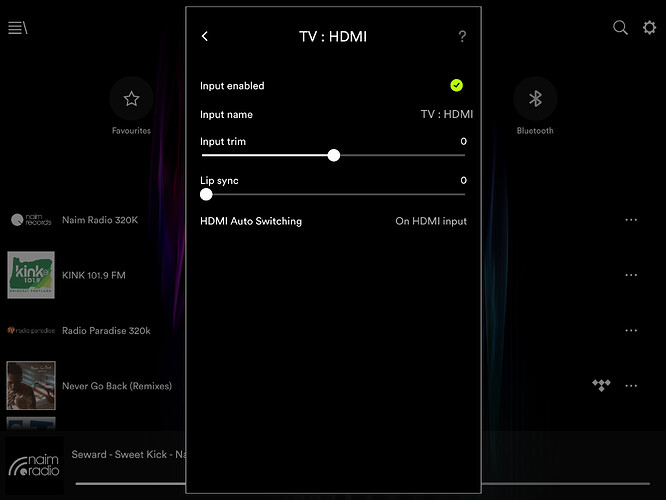

Ok, I feel I was not understanding the toggles under HDMI Auto Switching in the iOS app.
I only see the two choices: “HDMI Auto Switching” and “On HDMI input”.
On: HDMI Auto Switching/On HDMI input
Step 1: TV turned off
Steps 2: currently chrome casting music
Step 3: turn TV on = no change to chrome casting (does not switch to HDMI input)
On: HDMI Auto Switching/On Any Input
Step 3: turn TV on = changes to HDMI input (slow reaction, took a few seconds, but it worked)
Thanks for the help.
