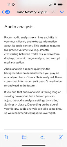

Coincidence - I received this from Roon today:
It got me thinking that even Roon is doing some DSP!
